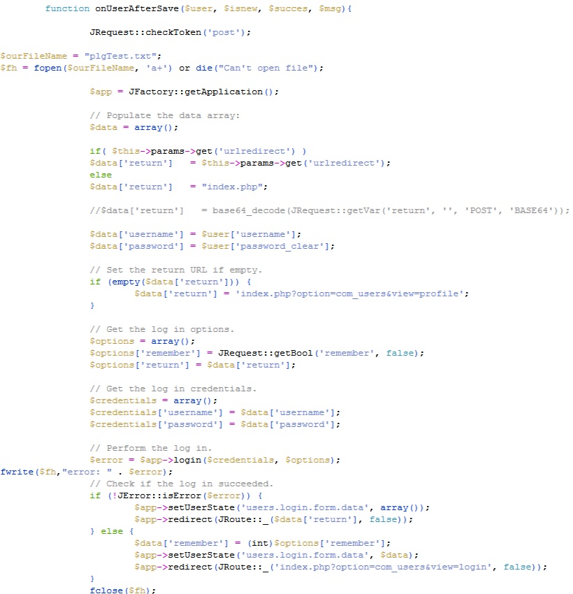

  • Posts: 108
14 years 3 months ago #49408
attached a picture of the plug-in.
The line: $error = $app->login($credentials, $options); returns 1
and all Hikashop custom fields are NULL, which cause the plugin to log in, but all of the user custom fields are empty.
Last edit: 14 years 3 months ago by bars92.

  • Posts: 108
14 years 3 months ago #49459
there is no error message i just print the $error as you see in the picture.

  • Posts: 86080
  • Thank you received: 14188
14 years 3 months ago #49609
As yes. That's because the saving of address fields is done after the user has been saved in Joomla. And that plugin is triggered in between and it redirects the page at that point. You should try to remove the redirect lines of code in the plugin and that should help.
  • Posts: 2
12 years 4 months ago #152925
have you got this working? I seem to have problem saving the user information with the autologin
  • Posts: 86080
12 years 4 months ago #152940
As I said in my last post, you should remove the "redirect" lines in the auto login plugin file so that it doesn't redirect the user to another page before HikaShop process the user information.
