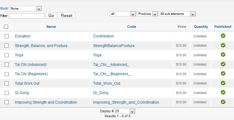

13 years 1 month ago #110781
Hi, I don't see a "product ID" see my screen shot. Where am I going wrong? :(
thanks
  • Posts: 86050
  • Thank you received: 14178
13 years 1 month ago #110785
Increase your resolution and you will see it. It is hidden because there isn't enough space on the screen to display the column.
