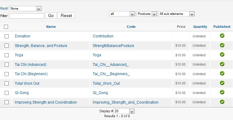

Hi, I don't see a "product ID" see my screen shot. Where am I going wrong? :(

Increase your resolution and you will see it. It is hidden because there isn't enough space on the screen to display the column.

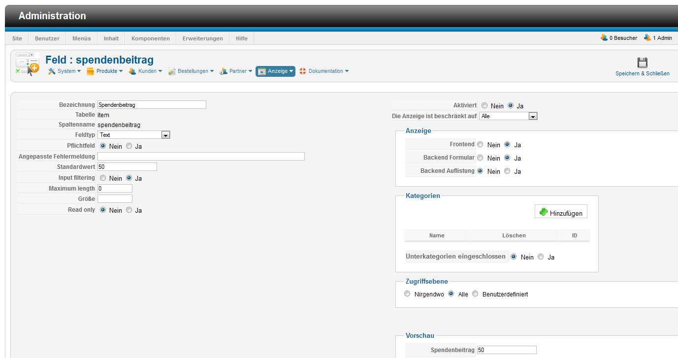

I found this entry, because I want to give a donation possibility to my shop. I'm fighting with similar problems as described in this threat.
Currently I have some products. I would like to add to each product the possibility to donate additionally. I was able to create the field, which also appears, but it does not count to the existing amounts. I was trying several things, like creating donation category and corresponding product, but I still got the same issues.
I also already enabled the plugin (Hikshop Donation....)
What needs to be done to have it displayed on each product and that the entered number is added to the final costs.
I'm using joomla 2.5 and latest Hika version.
Thank you very much
Peter

Can you do a screenshot of your custom field options screen so that we can see how you configured it ?

Here is my screenshot. I'm aware that no categories are defined. I once tried to use an existing category, but the field still did not count up.
thank you

The issue is the column name of your custom field.
As explained here demo.hikashop.com/index.php?option=com_h...show&cid=214&lang=en the column name needs to be "amount".
