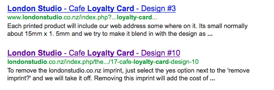

Hello all,
Google is starting to index my site, which is great.

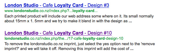

The problem is the two lines of type that google include in the search results don't really explain anything about my product.
Google is capturing a tool tip from a product variant and my products custom fields not my products description. Is there a way to "hide" this content form googles indexing robots so it captures the products description instead?
Any advice would be appreciated.

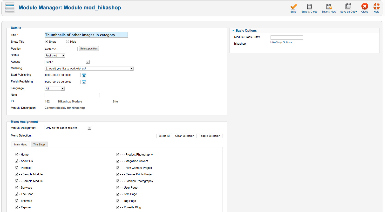

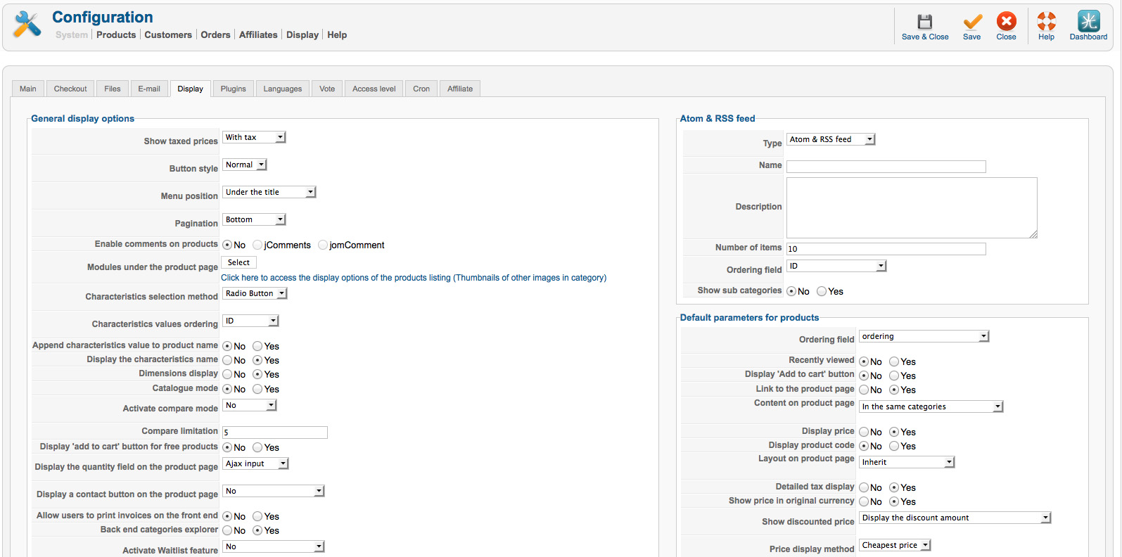

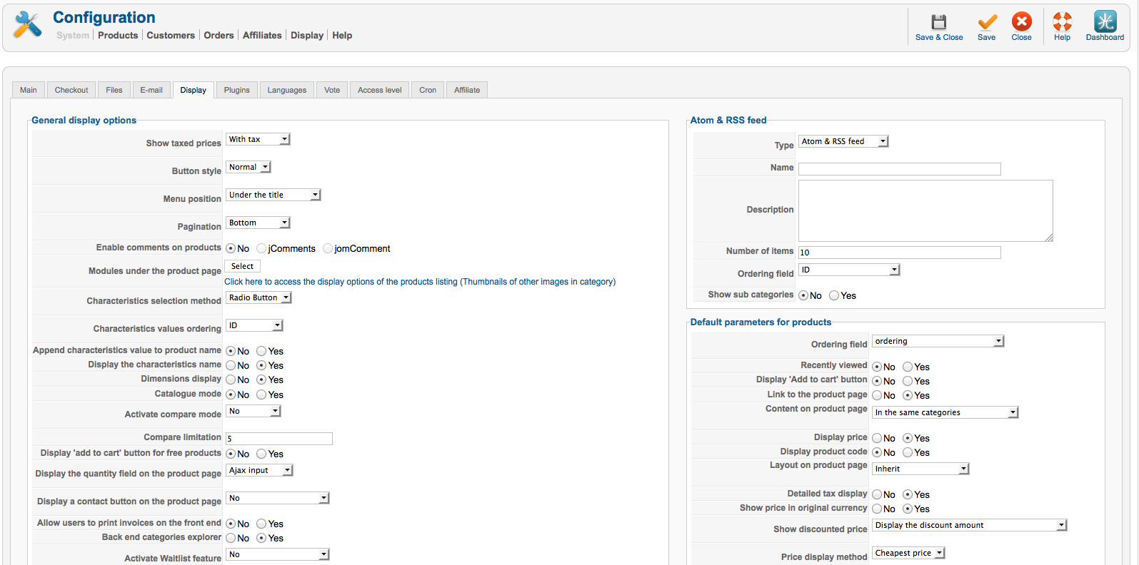

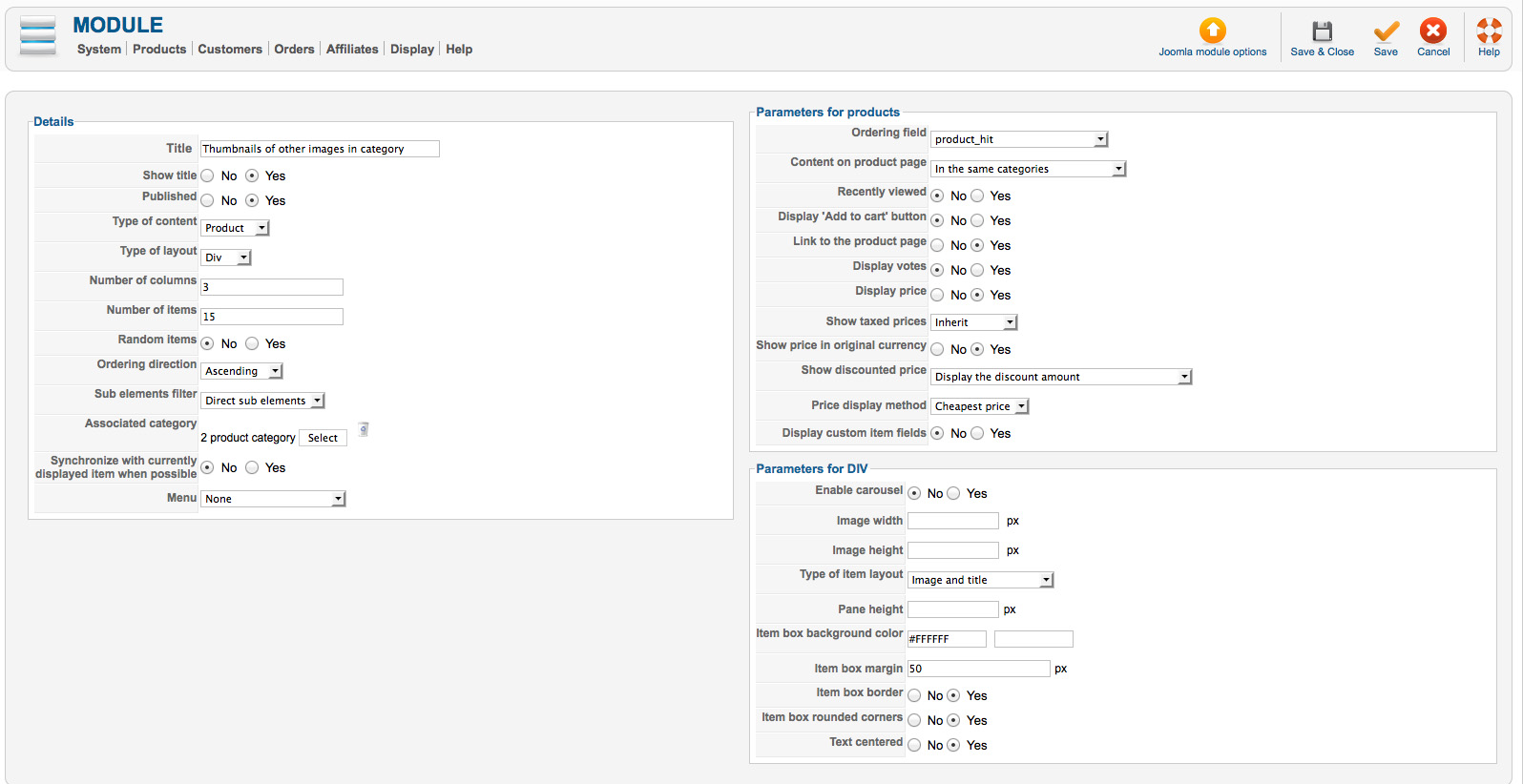

  • Posts: 64
14 years 3 months ago #53910
Thank you Nicolas,
I have made a new module as described by the tutorial you linked to. However it is still not working correctly.
I have unpublished the module in the joomla module manager and enabled it in the "Modules under the product page" as you recommended
This doesn't display the module at all. Publishing it the module in the joomla module manager makes the modules title only display and display on all pages, ie check out, category listing etc.
I only want this module to display under a product page displaying only other products in the same category. I want up to 15 products to be displayed in three columns, in order of most viewed product. So the most clicked on product will be displayed at the top.
The next problem is, The only part of the module that displays is the title, no thumnails, nothing else.

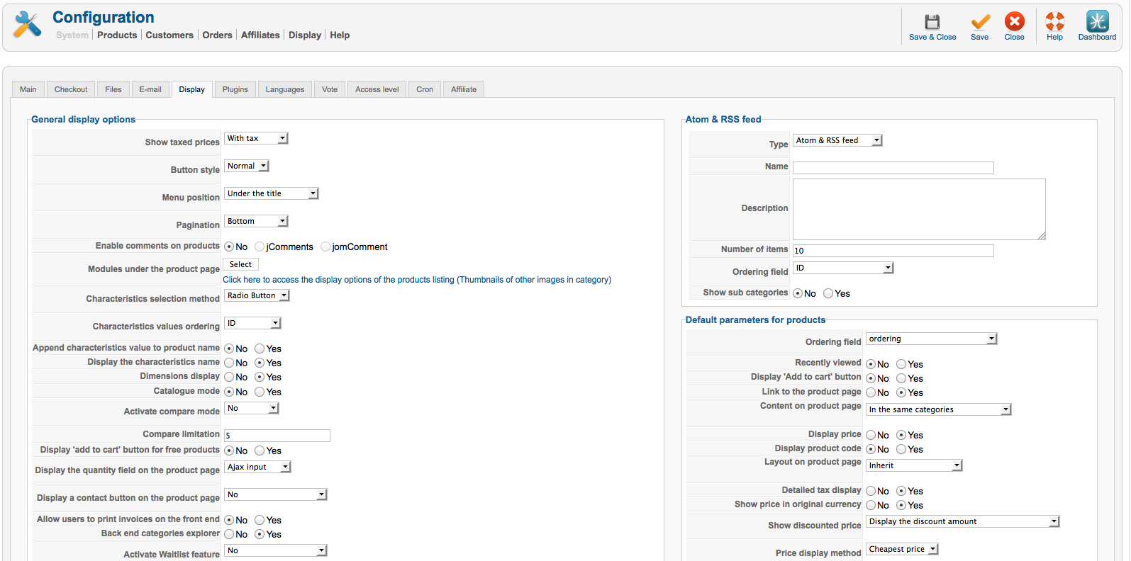

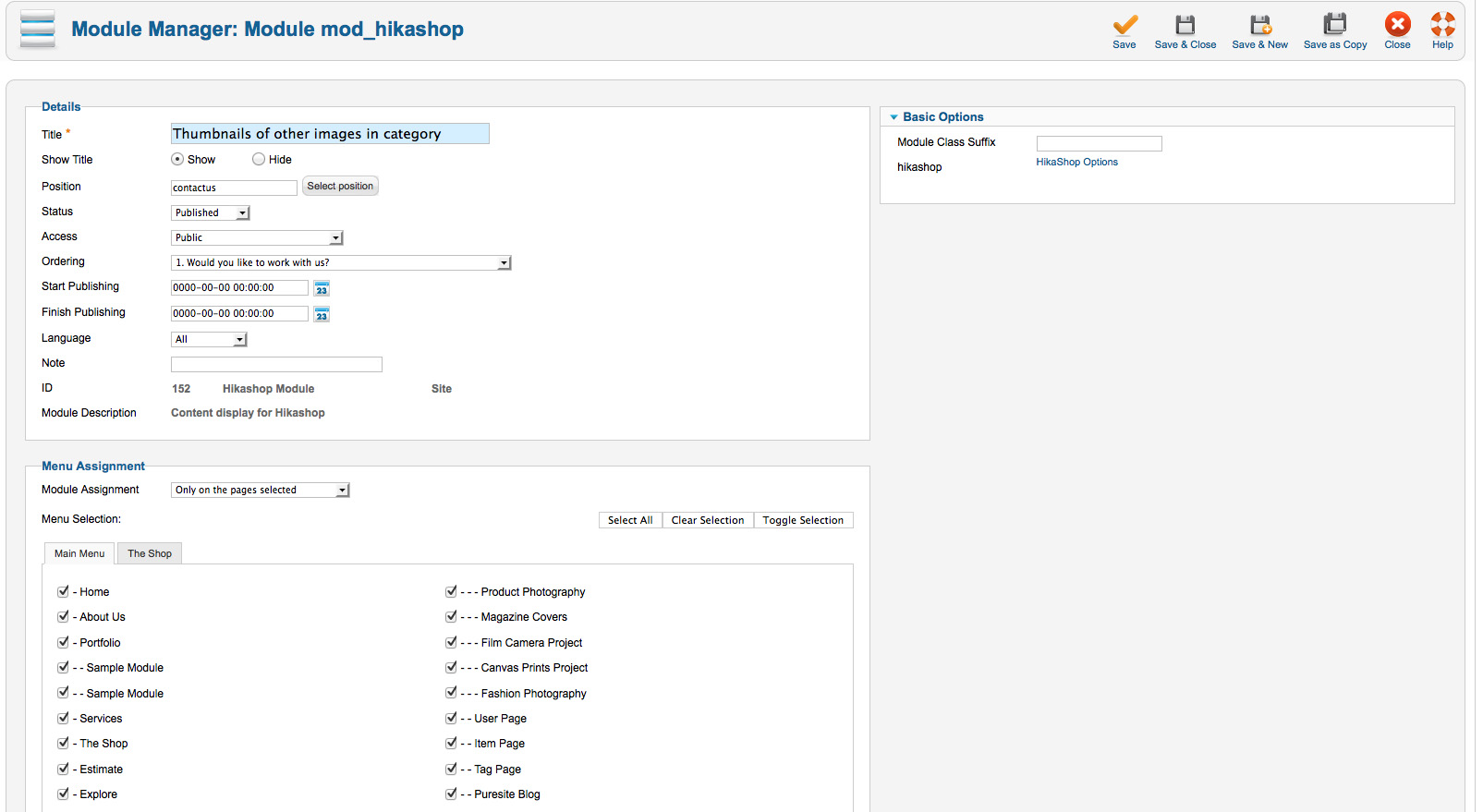

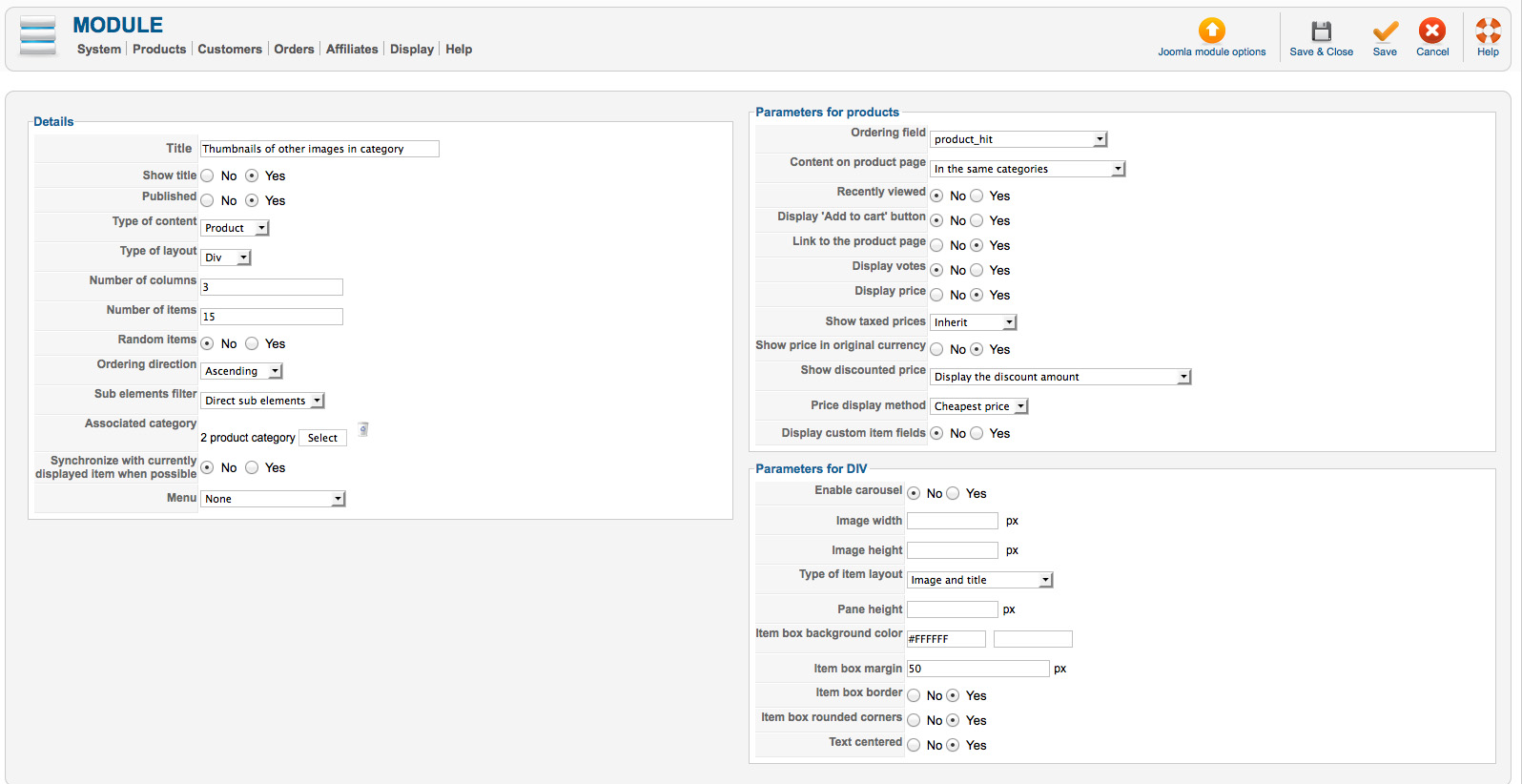

Attached are screen shots of my settings for the items display settings, module settings and joomla module settings.
Can you please let me know what I need to do to get the result I described above, or it will be easier for both of us, are you available to fix this issue if I give you access to my sites back end.
  • Posts: 86177
  • Thank you received: 14212
14 years 3 months ago #53991
Just turn on the content synchronization option in your module's options and it should work.
  • Posts: 64
14 years 3 months ago #54030
Sorry I turned on the "Synchronize with currently displayed item when possible" option, it made no difference and still does not show any of the thumbnails.
