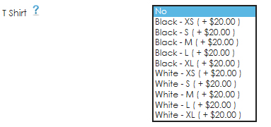

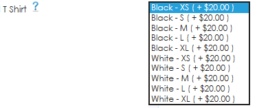

Hi, I'm trying to upgrade a site to HS version 2.2 and have hit a problem similar to the above posts with adding options to products where the option product has variants.
In my old version, I have a product called "T Shirt" with variants as follows:
No (zero price and quantity set to zero)
Black - XS ($20 price and quantity unlimited)
Black - S ($20 price and quantity unlimited) etc
I set the price on the T Shirt itself to zero so that it picks up the prices from the variants. I set the default variant to "No".
This works perfectly in HS v1.5.8 where the option is shown as a dropdown box, defaulting to No and does not add it to the cart if the No is selected.
However, in ver 2.2.0, the "T Shirt" option ignores the No variant and displays just the priced variants. (I have "show out of stock products" set to yes in both versions). Pic shows dropdown display where variant No has quantity set to zero - choosing any of the size options successfully adds to the cart.
If I set the quantity of the No variant to Unlimited it shows the No variant in the dropdown but WON'T add any of the priced variants to the cart. Pic below shows dropdown display where variant No has quantity set to Unlimited.
Hope you can shed light on this issue. I can provide logins to both the live and upgrade-in-progress sites if you need to look around.
Cheers
  • Posts: 86217
  • Thank you received: 14222
13 years 2 months ago #113962
Thank you for the report.
As far as I can see, the variants of options without quantity have never (for 1 year at least) taken into account the "show out of stock product" option.
You can change that by editing the file "option" of the view "product" and changing the line:
if(!$variant->product_published || empty($variant->product_quantity)) continue;
to:
if(!$variant->product_published || (!$this->config->get('show_out_of_stock',1) && empty($variant->product_quantity))) continue;
I didn't find any issue with the add to cart on my end, regardless of how I configured the options/product.
