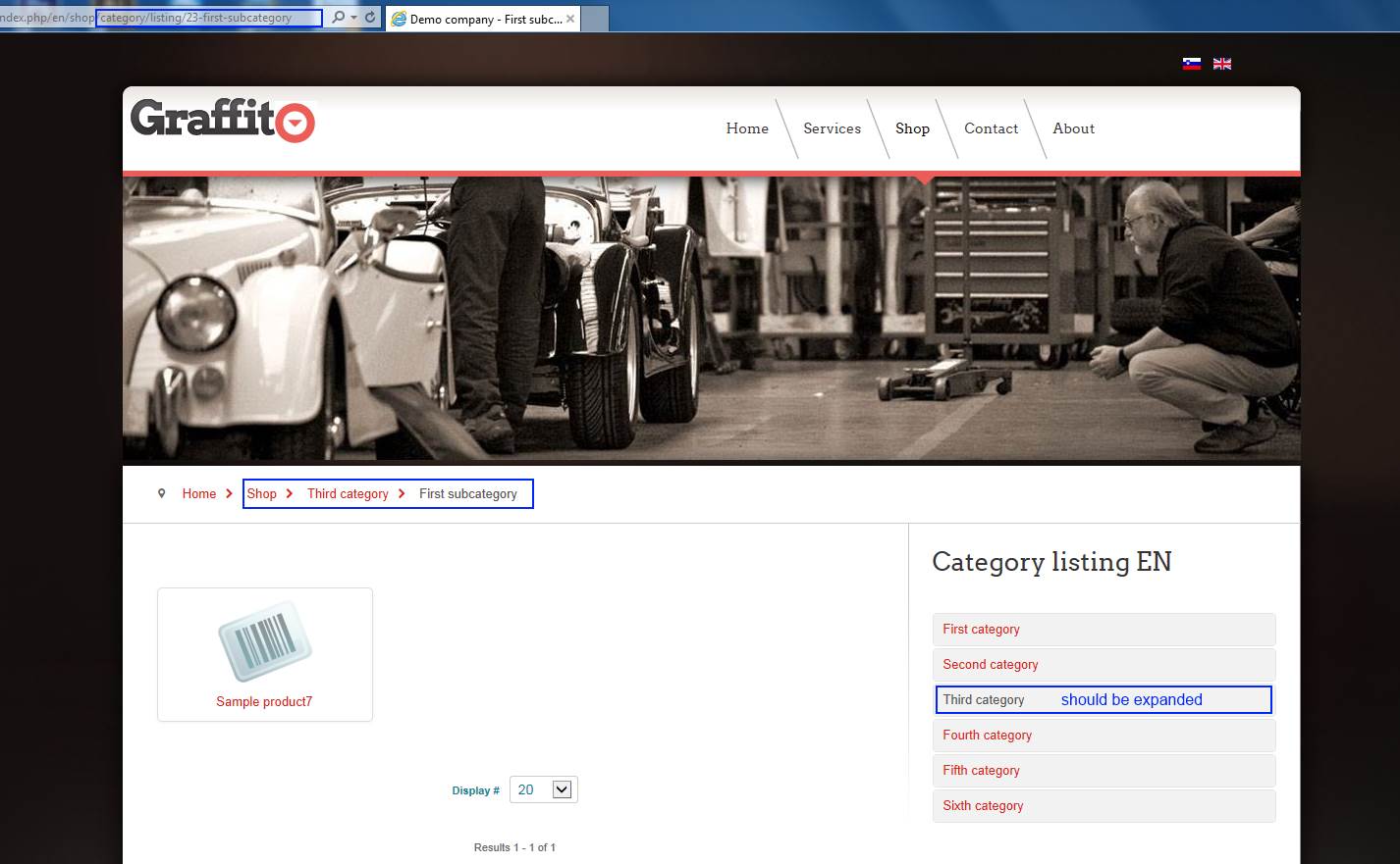

12 years 8 months ago #136649

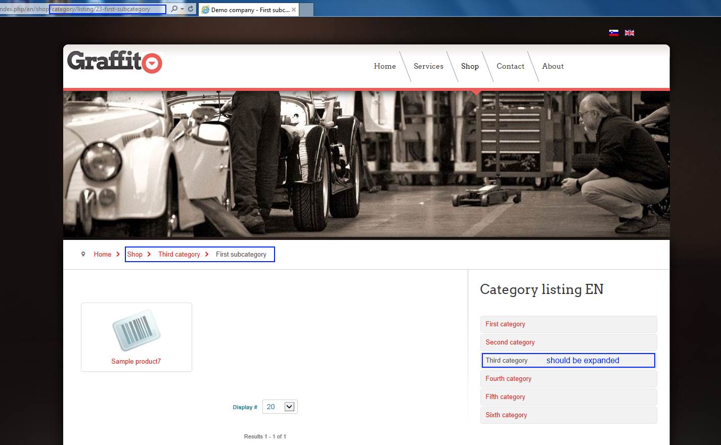

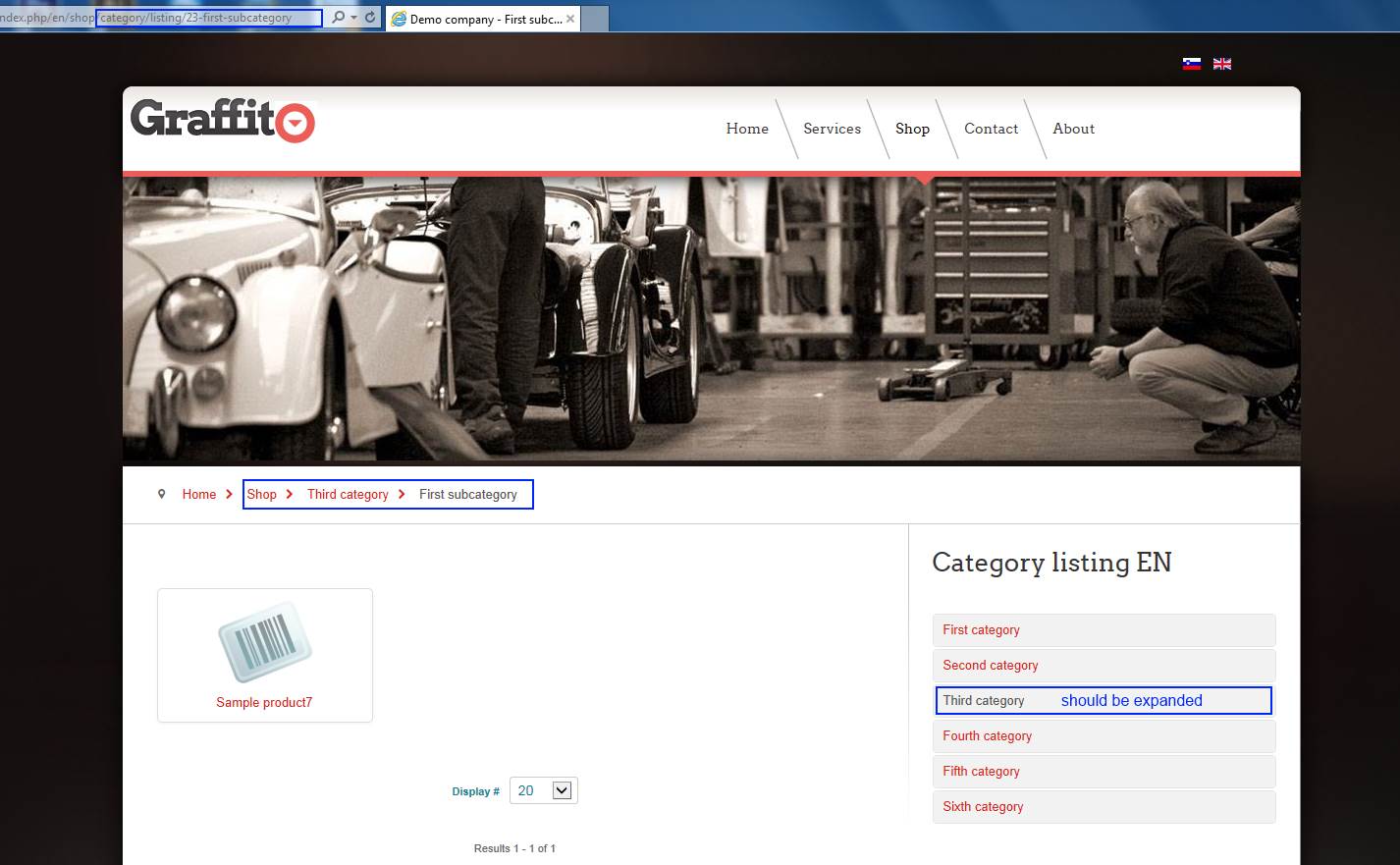

I'm sorry, maybe I wasn't clear. Category listing menu works fine as far as listing of main categories and first level of subcategories goes. As to my understanding hikashop does not support more than 1 level of subcategories out of the box. Or am I mistaken?
Problem is that the menu does not stay expanded to the subcategory you are in. With hikashop 2.2.3 it is always collapsed (I even tried with new installation of joomla 3.2 + hikashop 2.2.3). Before I upgraded from 2.2.2, first category was always expanded including the one you were actually browsing. .
Here is a picture.
Last edit: 12 years 8 months ago by jdoe.

12 years 7 months ago #138426
This is not available with the current version of the category listing module.
I just commit some changes on our end to allow that, that should be available in the next release of HikaShop.

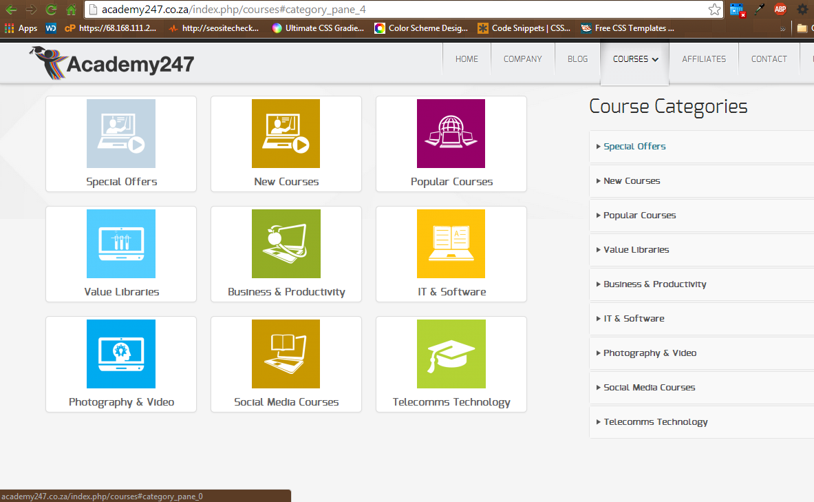

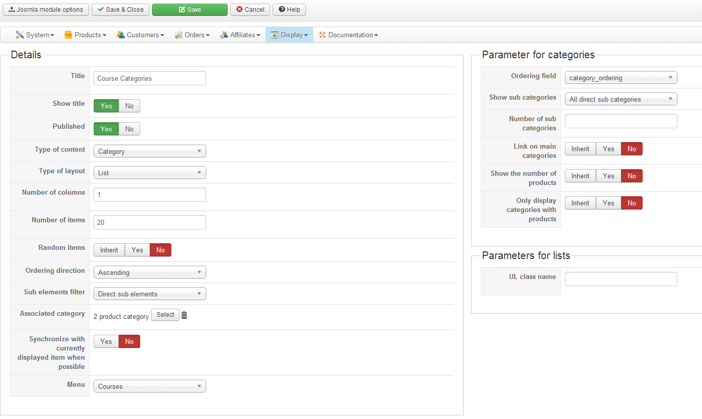

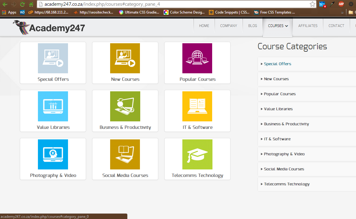

12 years 3 months ago #154525

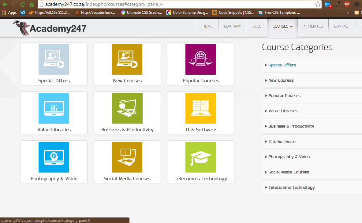

Hi. I have a similar problem. I have the categories listing with direct subcategories only.
The problem is that the subcategories does not show and when you click on the main category it goes to some anchor in the page (e.g. academy247.co.za/index.php/courses#category_pane_4 )
I don't know if that is just a setting somewhere but I can't seem to correct it.
I tried jQuery easy with no success.

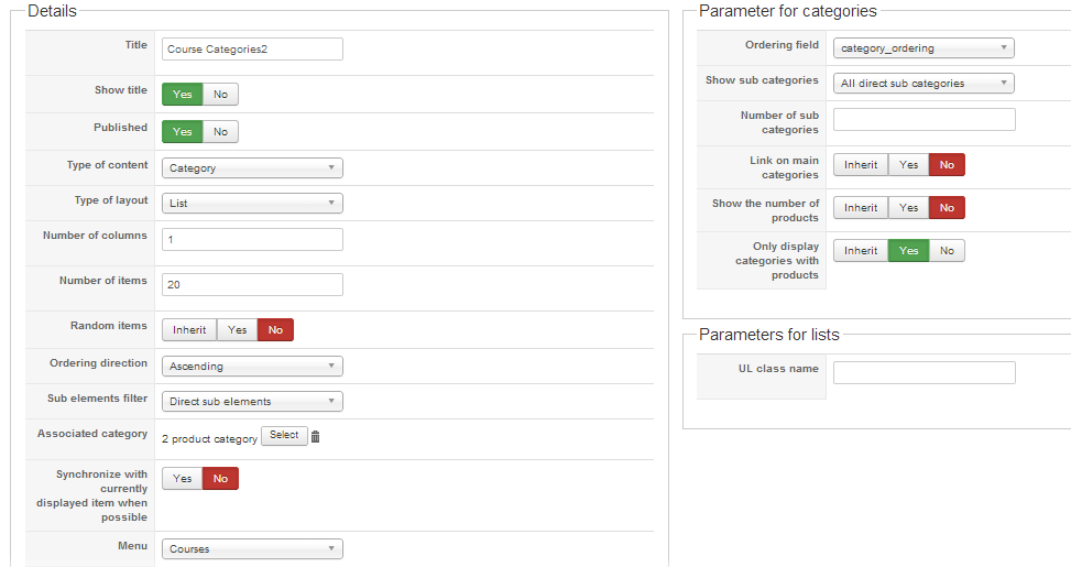

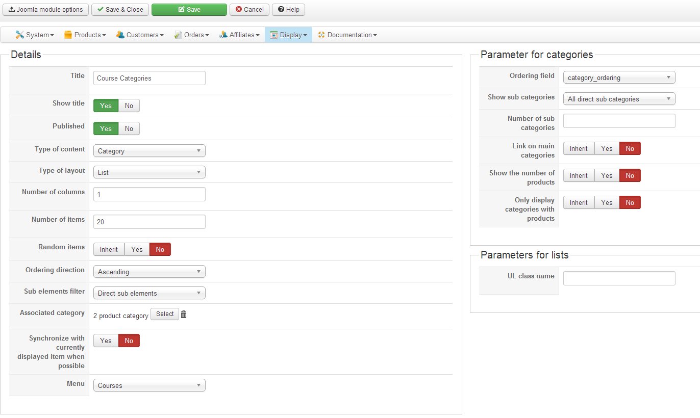

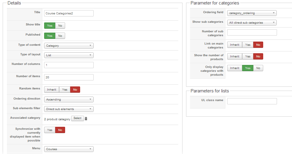

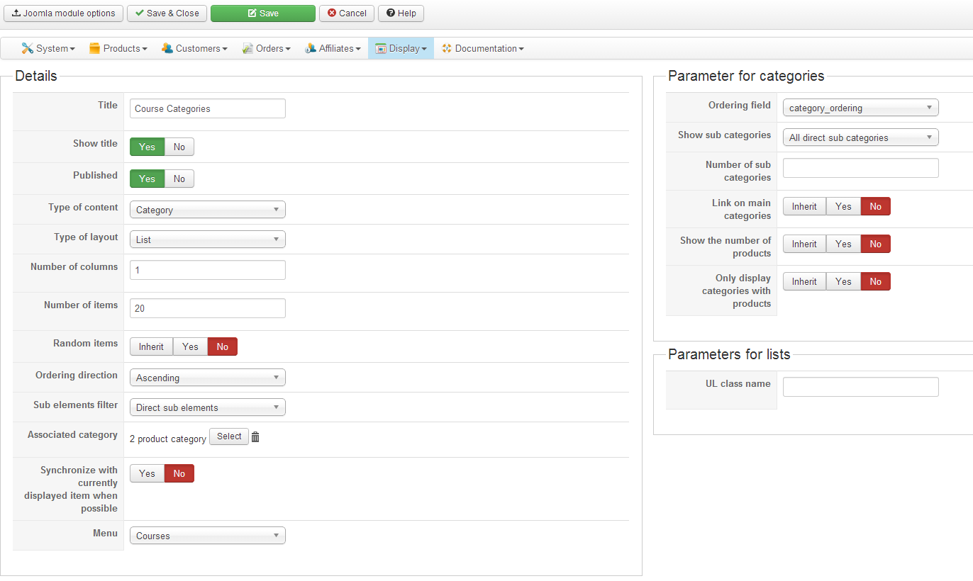

12 years 3 months ago #154538

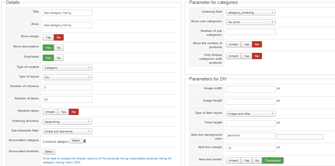

Could you give us a screeshot of your module configuration ?
  • Posts: 11

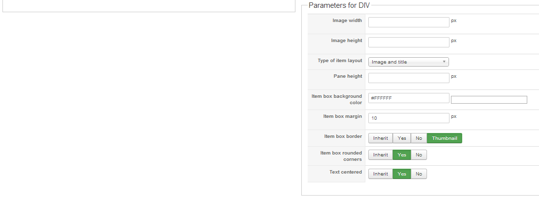

12 years 3 months ago #154606
There you go. I probably just got the settings wrong. Thanks for the help
  • Posts: 11
12 years 3 months ago #154689
This could have been misleading. The problem is not resolved :D I just provided the settings
12 years 3 months ago #154725
Yes we saw that ;)
You problem seems to be a javascript issue. But there is no errors displayed.
So maybe another component alter the way it's working.
Can you try to disable other extensions one by one to see if one of them is causing this conflict ?
If we click on a category in the category listing in div (left part) then we can see in that categories listing that the category is well expanded.

I installed the hikashop business edition again through the extensions manager. I didn't remove the current installation. This did not change anything.
Is my settings correct? The links appear to have an anchor appended to it as if to go to a specified tab/pane on the same page?
academy247.co.za/index.php/courses#category_pane_0
No javascript errors are being thrown either...
Thanks for the help.
12 years 3 months ago #155843
The anchor is normal, it is used by the javascript.
Do you had/have edited the view "category / listing_list" ? If it is, thanks to reset the view.
Was the module working on the products listing pages, or the same problem was happening than on the category listing page ?

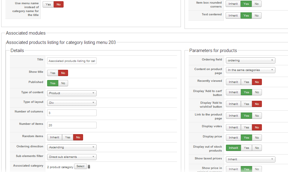

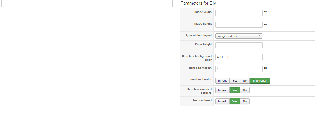

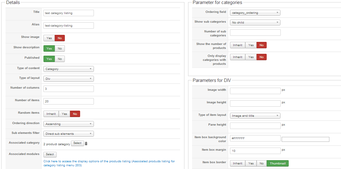

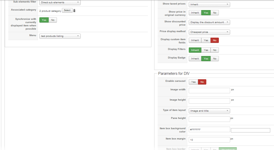

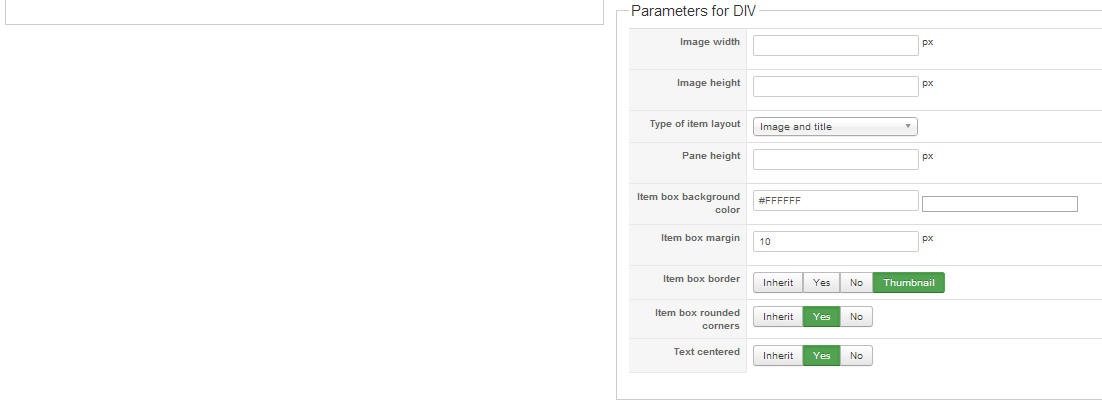

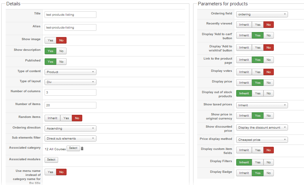

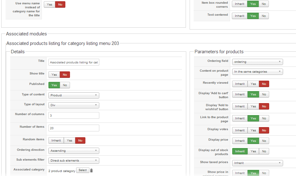

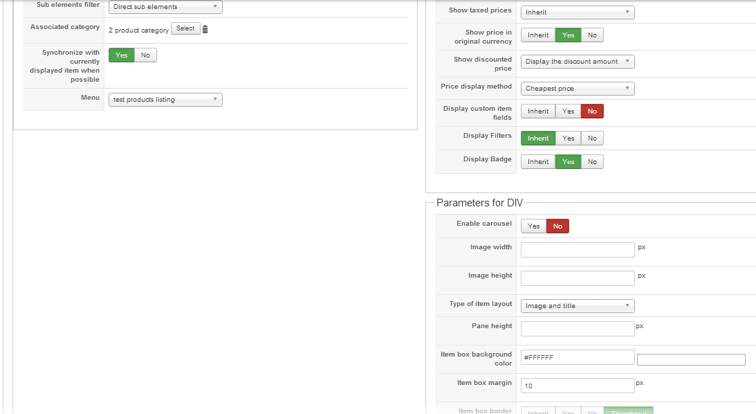

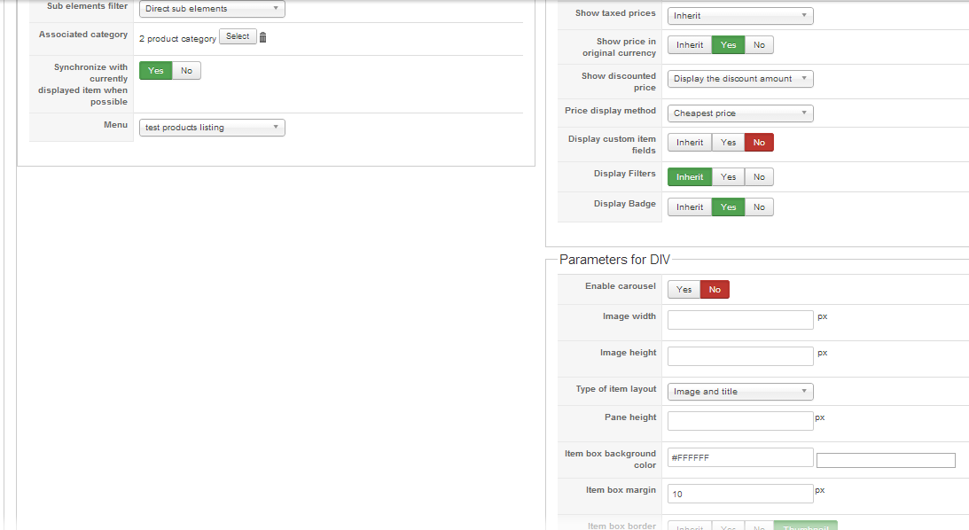

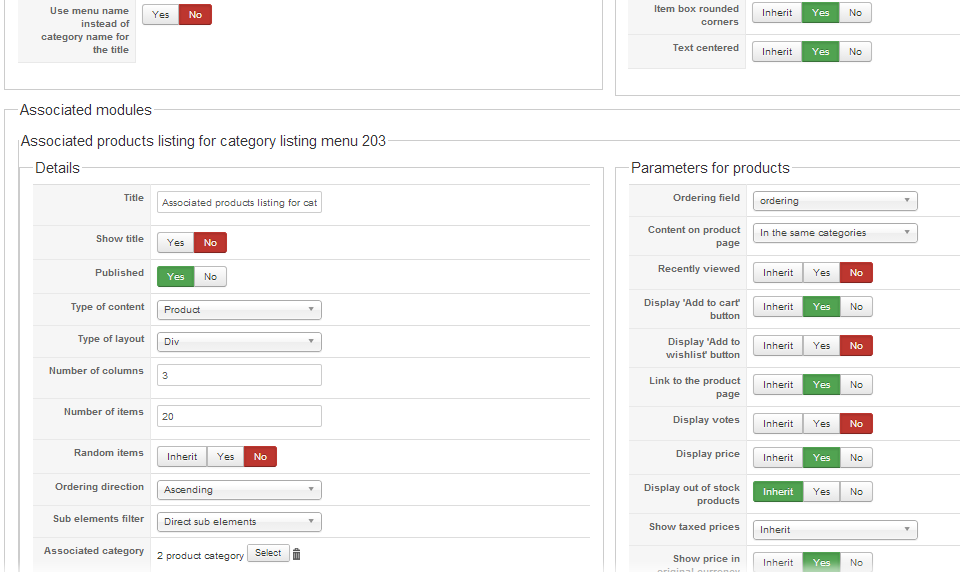

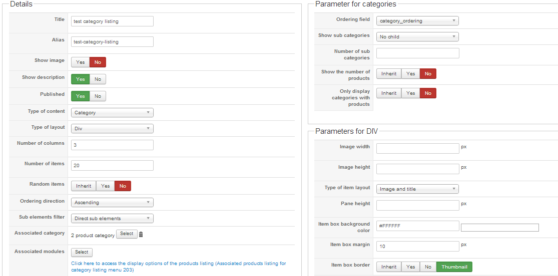

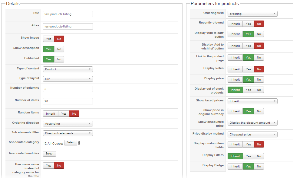

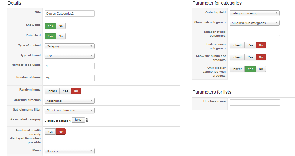

I created 2 hidden test pages now:
Products listing page with accordion menu in sidebar
academy247.co.za/index.php/test-products-listing
Category listing page with accordion menu in sidebar
academy247.co.za/index.php/test-category-listing
I attached images of the settings for the products and category listing pages and the categories accordion module.
Thanks again for your time.
12 years 3 months ago #156339
Can you try to enable the Joomla debug mode ? I think that the accordion will work when debug is enabled.
The accordion use Joomla accordion javascript, so it's not working probably because a js file is not present.
Thanks to try to update to the version 2.3.1 of HikaShop, that should correct that bug.
You can take this version from our website.
