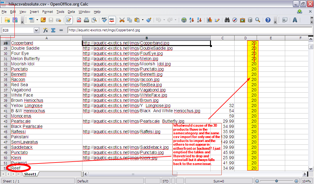

  • Posts: 79
15 years 5 months ago #12862

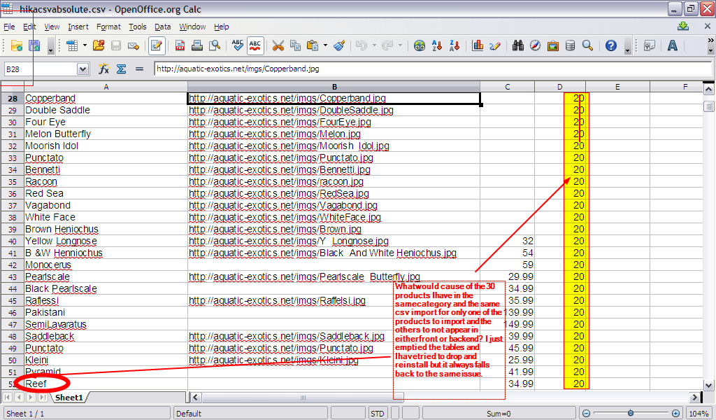

In the image. The only one showing is the circled in the front or back end. I spokewithmy host provider and they have looked into the DB and all of the strings are correct. I have emptied and dropped tables, but no luck. I can't flush the tables because I don't have reload privleges on this server>?
I could really use some additional help or advice on where to look to findout how to correct the issue.
THANKS!
  • Posts: 86181
15 years 5 months ago #12868
Could you try to just create a new CSV with some of the entries missing and just import it via the interface ? Does it work ?

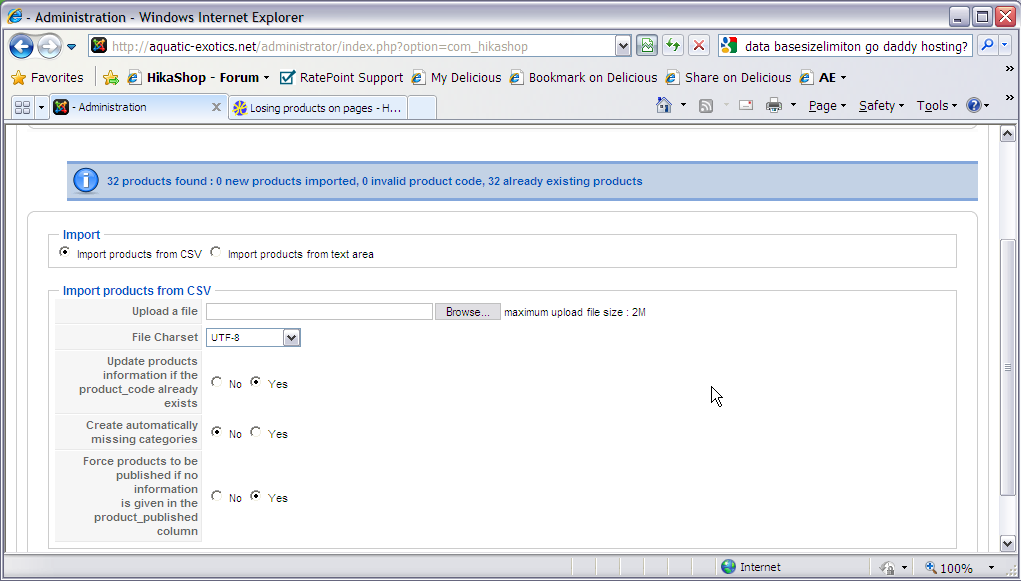

  • Posts: 79
15 years 5 months ago #12879
the import said it was succesful but nothin is showing in the front or back end.
They are showing in Hika_Products but not in Product_category I guess in the MySQL????
I have a 1 gig size limit in MySQL but I amway under that I thought?
Thank you.
  • Posts: 86181
15 years 5 months ago #12890
You should really update hikashop.
There was a bug in the import prior to 1.4.7 which could result in the removing of products or otherwise unexpected results.
Could you make sure that the category with the id 20 exists ?
If the products are in the table hikashop_product but not in hikashop_product_category it means that there is a problem with the categories in the CSV.
I would first ask you to update. Is there a reason why you don't want to update ?

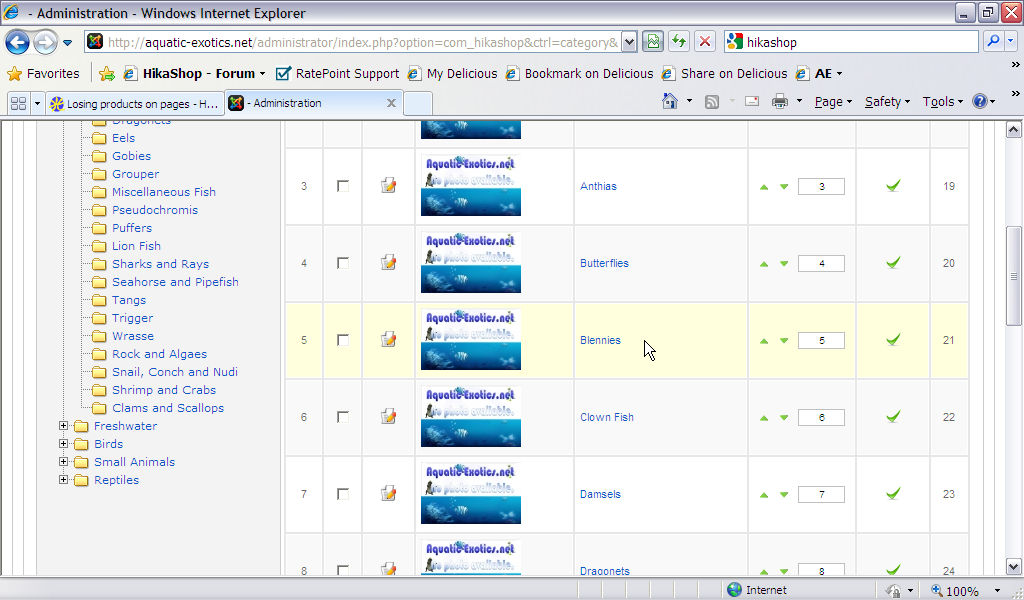

15 years 5 months ago #12968
I thought I had updated,lol. Maybe i downloaded it and forgot to install it? Who knows?
It's current now. Attached is a "SS" that shows the existence of the category.

  • Posts: 79
15 years 5 months ago #12969
Everything loaded and was displayed with pagination as I uploaded the shortened CSV file. Iuploaded the full CSV again after that and lost a tonof products again and some pagination.
I guess I am going to try to make CSV file for each individual category and see if I lose products doing it that way. 1200 products may be taxing my data base????
The small Category specific CSV is uploading and displaying fine. Imay have an issue with excess data in the large "master" CSV?
