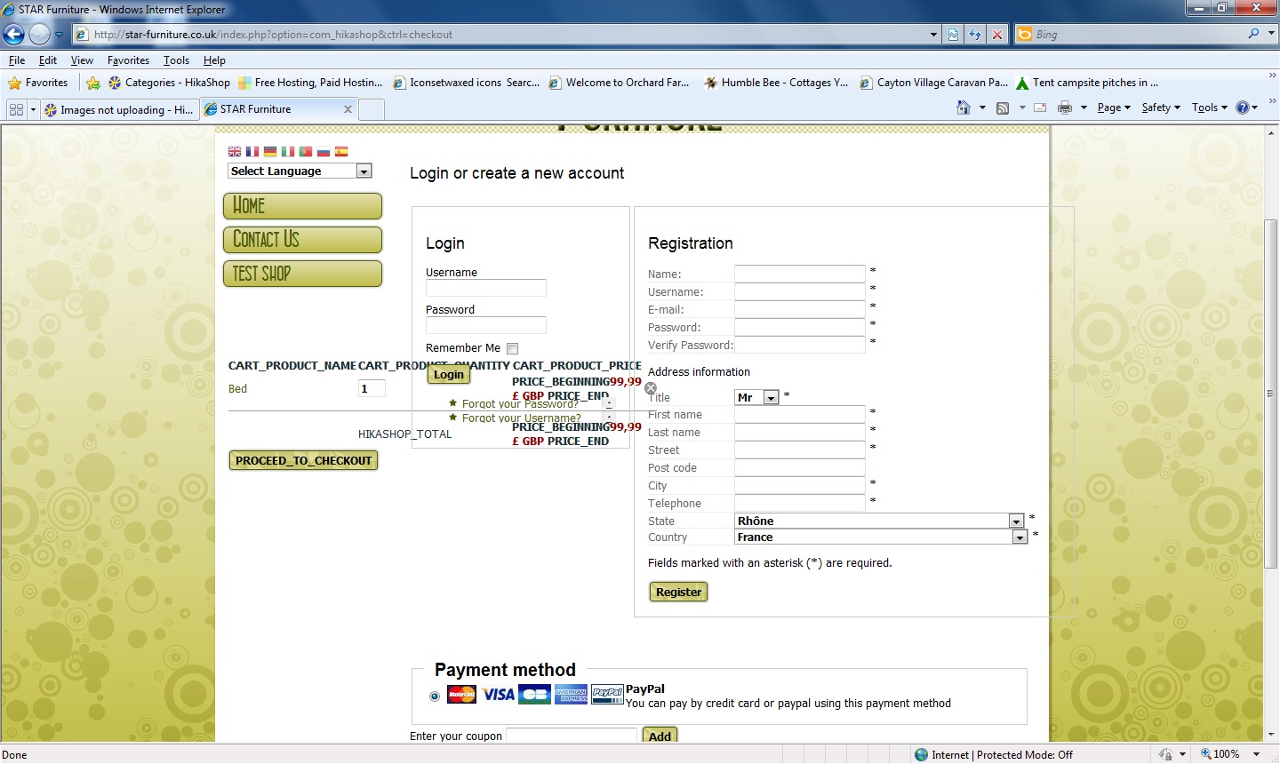

OK, i have replaced the code as per your instruction and still the same on the checkout page:
  • Posts: 86101
  • Thank you received: 14203
15 years 10 months ago #99
I will need an FTP access to your website and the URL of your website in order to find the problem and fix it. You can send send me your details at This email address is being protected from spambots. You need JavaScript enabled to view it.
