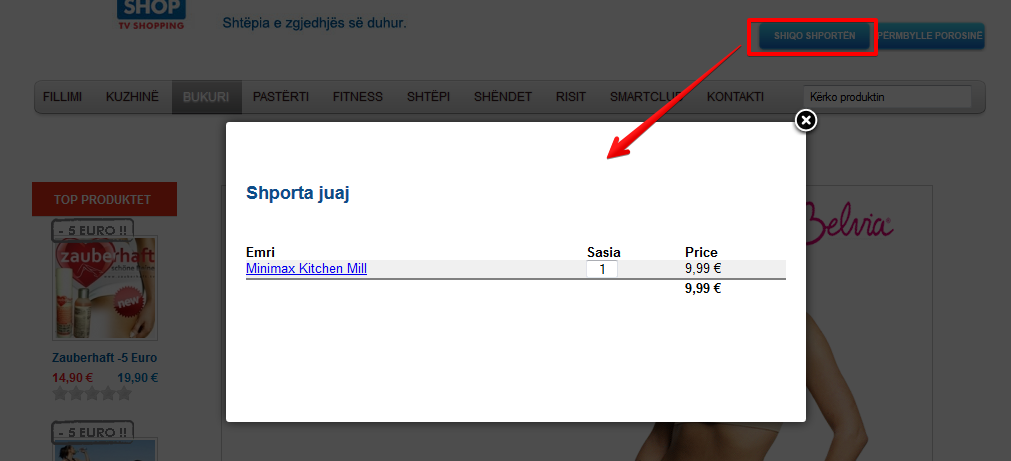

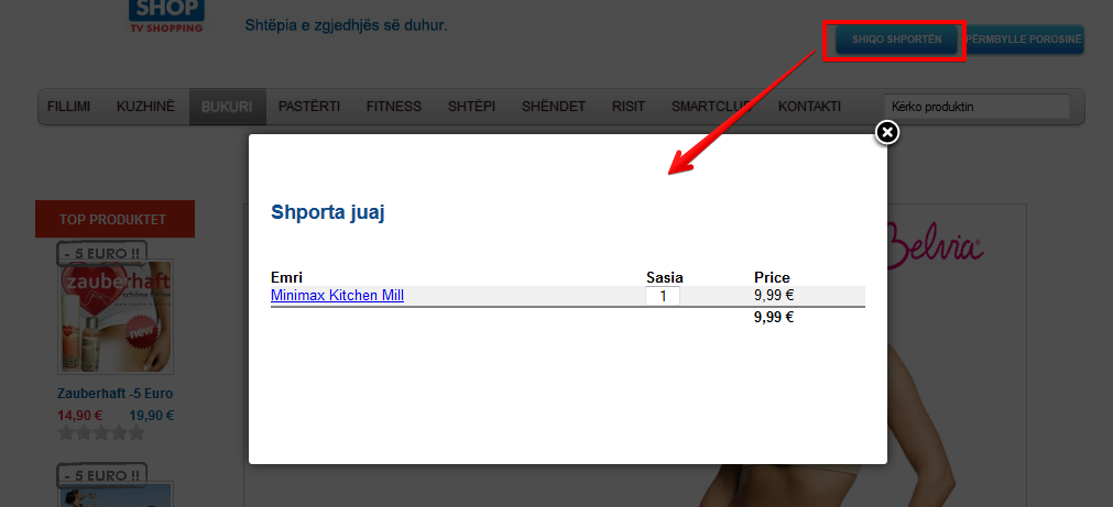

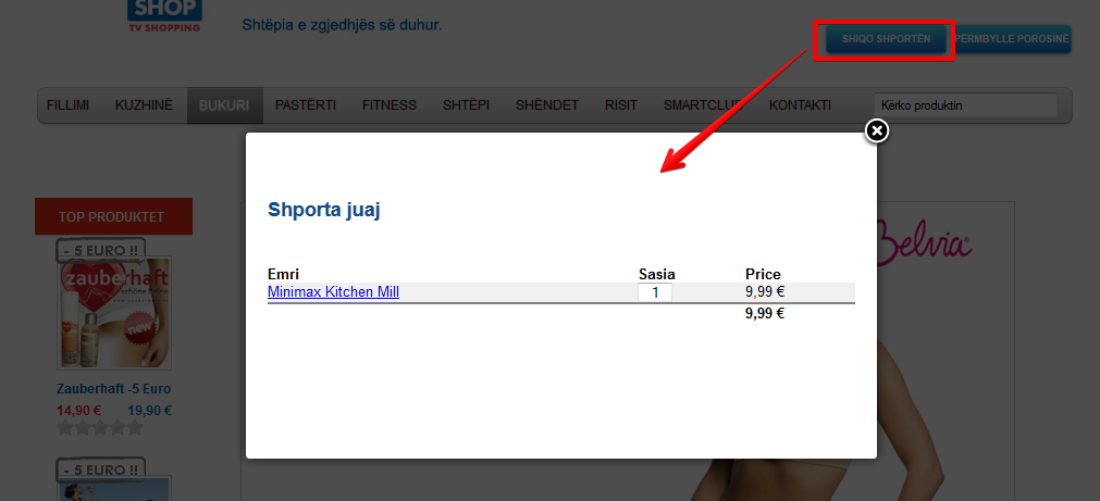

Didn't help :( . It is still not working every time with any of these browsers: Firefox, IE and Chrome. I can't get it because sometimes it is working and sometimes not.
Will you please try it yourself with the help of the document attached.
What are you using on hikashop add to cart pop up? Because that pop up with same effect is working with every browser and no problem at all. Can I use the same functionality here?

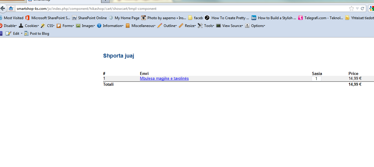

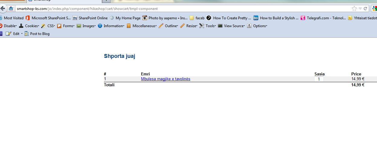

Please try it with different browsers and several times you will notice that sometimes it opens in modal window and sometimes full browser.

It looks like only the first time you click the button after adding the product to cart it does not work.
After that it works. At least I got this impression after my testingss

As I mentioned on my previous comment it does not work as it should only the first time you click show cart button and after that the modal property works as it should.

This behavior comes from the javascript error:
Uncaught TypeError: Cannot call method 'setStyles' of null for the file: smartshop-ks.com/jo/plugins/system/hotlogin/extra/hotlogin.js
which only happens on the first try.
If you deactivate that plugin, you should not have that issue.
The following user(s) said Thank You: mirlinda.kosova
