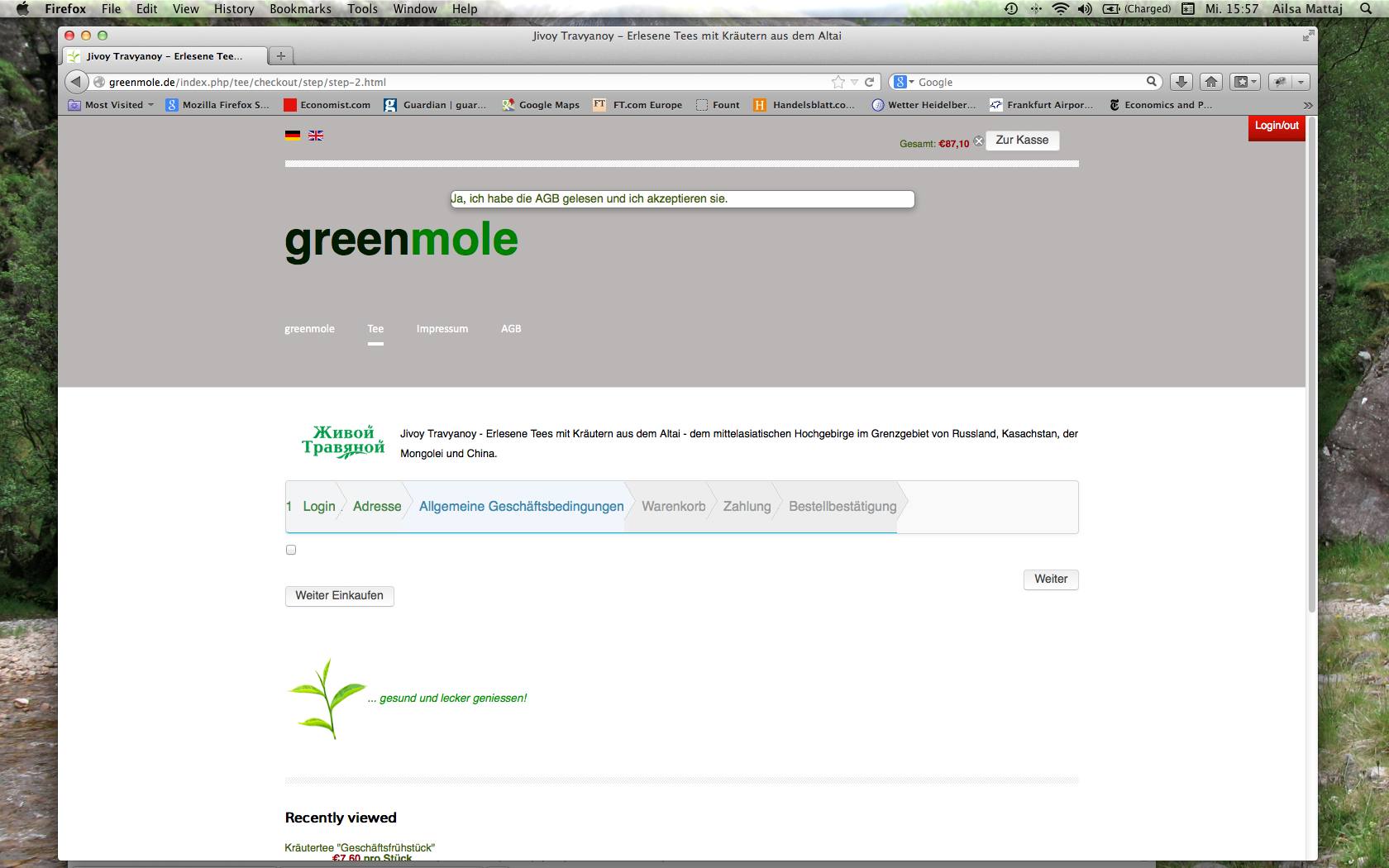

I have a problem on my checkout page
I dont have a label beside the Terms & Canditions Checkbox.
the terms and conditions pop-up box appears and opens to the selected article. But right at the bottom of the page above "Continue Shopping is a lonely little checkbox with no label. (as per the attached screenshot)
I would prefer as a first option to be able to display the checkbox with the article so they are clearly associated. But as a fall back i need a label beside the checkbox.
Can you help please?

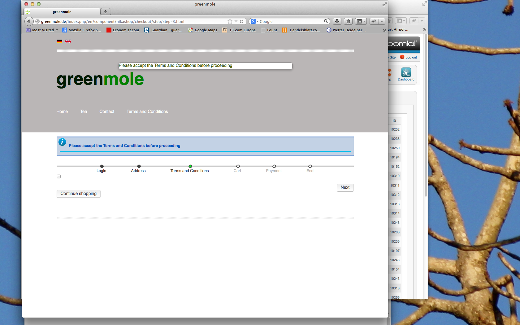

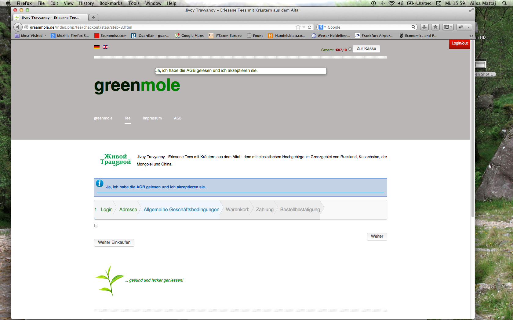

Hi. I have the same problem ... the box to check is just a box, all by itself, I need to add "I've read and accepted ..." next to the box. At the moment it's all wrong. There's a (popup) line of text at the top of the page above the logo that says "Please accept the Terms and Conditions before proceeding" but the box to check is way down the page. If a visitor clicks on Next without checking (because they didn't notice the box to check) then there's a broad blue band across the page with an i icon and the text "Please accept the Terms and Conditions before proceeding" which looks pretty stupid. I need to get the text and the box to check in the same place. I've attached a screenshot to show what I mean.
12 years 11 months ago #124027
You have a template conflict with Joomla 3.
Please change your HikaShop configuration in order to not use the "bootstrap" popup but the "mootools" one.
It should fix your problem.

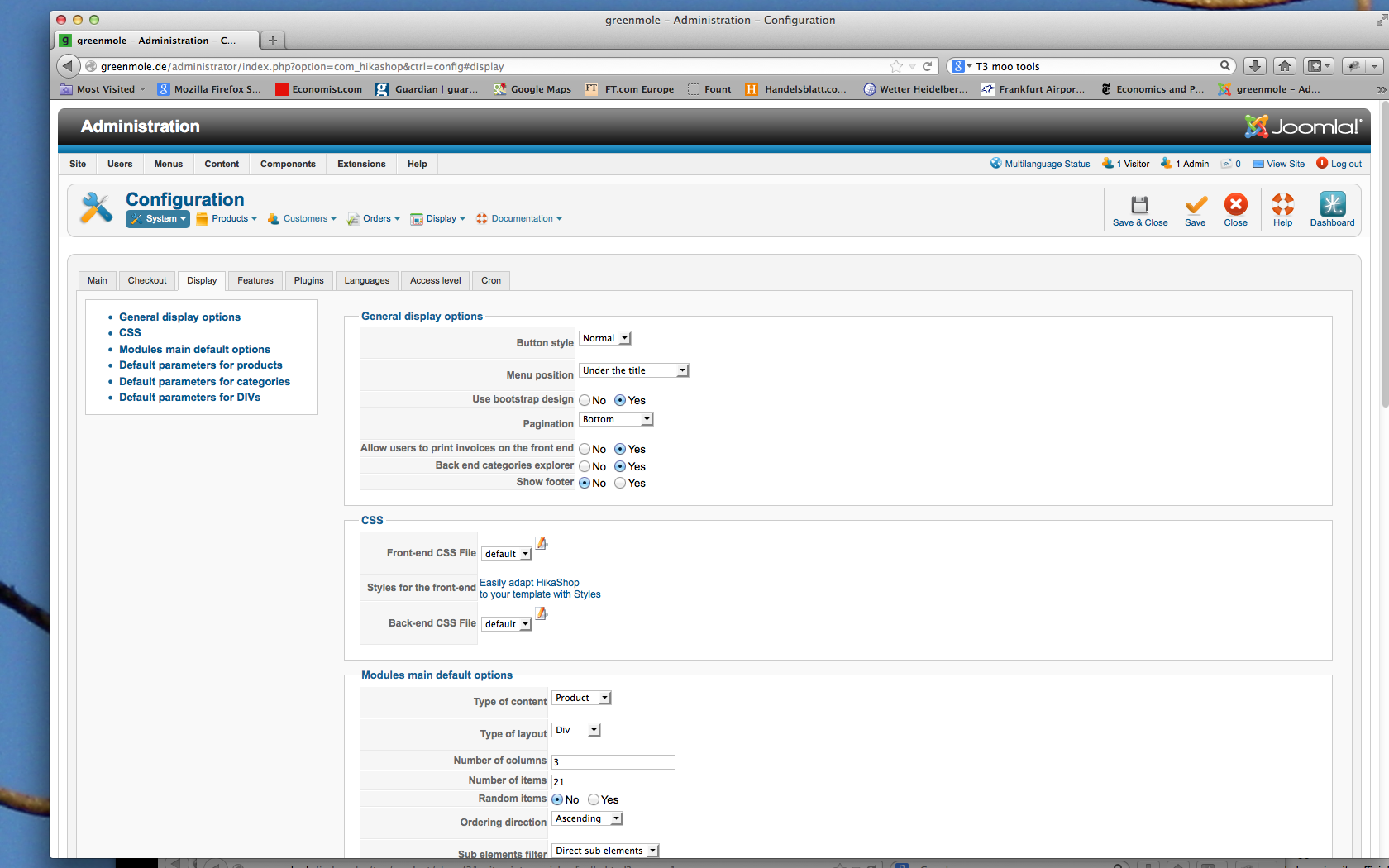

I am currently using Joomla 2.5.14 (not yet 3 though template I am using - Blankoshop from JoomlaBamboo will apparently be okay with Joomla 3 when I decide to change) and Hikashop Business 2.2.1.
In the General Hikashop display options I previously had Use bootstrap design clicked to No (which is I think what you were recommending) ...? Switching to Use bootstrap design - Yes (see screenshot 1) gets much the same result as before but looks a little bit better. There isn't a Mootools option shown here - maybe I am looking in the wrong place? (see screenshots 2 and 3). In fact, I don't see Mootools anywhere ... except within JB Library plug-in (this had been disabled I believe on the recommendation of the JoomlaBamboo people but enabling it doesn't seem to make any difference).
I guess I should look for and install MooTools ...? I have no idea why I can't find it, since I guess it should be part of my Joomla installation.
Ailsa
