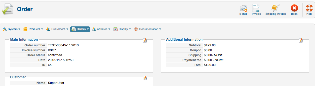

OK. I went to that file and searched for the code you gave me, (plugins/hikashop/attachinvoice/attachinvoice/invoice.php of the plugin), but...
1. I could not find the code:
<?php if(!isset($order->order_invoice_number)) $order->order_invoice_number = $order->order_number; ?>
2. I could only find the code:
<div class="invoicetitle"><?php echo JText::_('INVOICE').' '.$order->order_invoice_number; ?></div>

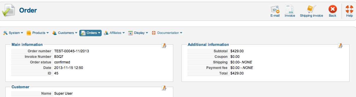

3. I therefore substituted that code which I could find in the file with the new code you gave me, but all that did was change the Text Invoice Number to the Order number, but failed to insert any numbers at all - see attached.
The Order Number should read: TEST-00045-11/2013
The Invoice Number should read: B3Q7
4. See attached screenshot of the order page itself.
5. The other thing that is happening is the Shipping Invoice is not being produced any more, when I set the order on another TEST order to shipped.
I am beginning to wonder if Hikashop update loaded properly or if I did something wrong somewhere. So I reuploaded the update but the same thing is still happening.
Any ideas?
Kind regards
Kind regards.

My copy/paste was a bit fast. Of course, you need to change the names of the variables as they are not the same between the backend invoice and the pdf plugin.
It should be:
if(!empty($order->order_invoice_number)) {
echo JText::_('INVOICE').': '.$order->order_invoice_number;
echo JText::_('ORDER_NUMBER').': '.@$order->order_number;
?></div>
The modification I provided for the invoice name was only for the invoice that is included in the email notifications.
For the invoices that you print in the backend, you will have to change the line:
if(count($orderIds) == 1) $fileName.= '_'.reset($orderIds);
to:
if(count($orderIds) == 1) $fileName.= '_'.$order->order_invoice_id;
Please remember that what we're doing here is waaayyy outside standard support. That's clearly code customization which is not included in the standard support of HikaShop commercial editions.
