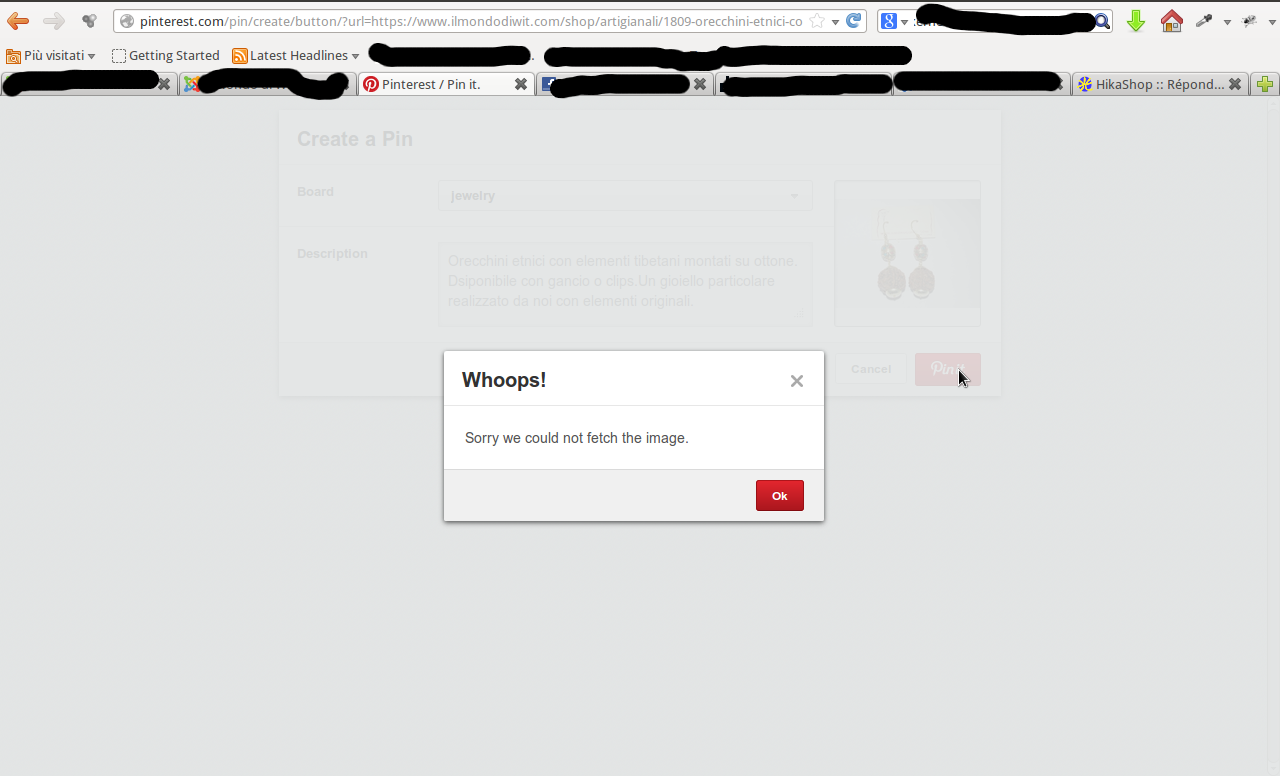

I have a new issue with pin after updating to business version. when i pin and product i get and error on pin it which i didn't get before update.
What can be wrong?

About the error message and according to this topic: www.inmotionhosting.com/support/communit...t-button-not-working it looks like it comes from pinterest and their specific restriction on images so I'm not sure we can help you on this point.

I reinstalled the business version and nothing no change. The images couldn't be pinned. I changed the http https like you mentioned in a post before and nothing. I looked for more http in the social file and there were was the line
$html=$div.'<a href="http://pinterest.com/pin/create/button/?url='.hikashop_currentURL().'&media='.$imageUrl.'&description='$return $html;
and i changed the http to https just for curiosity and ??? it works.
don't ask me what was really the problem but now it works.
Thanks for support
