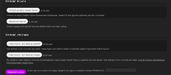

After upgrade to 2.2.0, the following issue occured.
In my previous version of the shop, during checkout process, if a customer selects a payment or shipping method, the selected methods are were highlighted with a main colour of the web site.
However, after the upgrade they are not highlighted and it is not visible for the customer, which of the methods are selected.
See attached image for details.
Can you help me to figure out the issue?
(I am using a RocketTheme template, if this helps.)
Thanks.

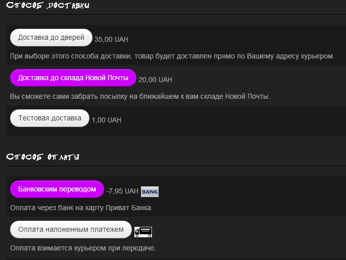

13 years 2 months ago #114632
Hi Mohamed,
It is most probably some CSS issue.
I will PM a link to a live site.
Please also see screenshot of web site before the upgrade (you may see buttons of selected items are highlighted with some color, so customer can easily see what is his choice of payment and shipment methods):

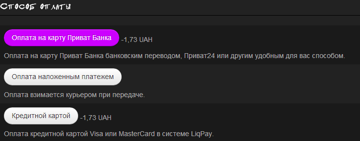

13 years 2 months ago #114647
I don't think that his is a CSS issue :
The problem is actually coming from the fact that you have no payment method selected when you are redirected to the checkout, did you set your "Auto select default shipping and payment methods" option to YES through "Hikashop->System->Configuration->'Checkout'" ?

  • Posts: 120
13 years 2 months ago #114651
Actually it was not set. However, even after a customer selects some method manually, it remains same color (not highlighted with a special color like on the above example).

13 years 2 months ago #114661
I've done it through the last version of Chrome and Firefox and now the payment method is automatically selected when I go through the checkout, you should have changed the "Auto select default shipping and payment methods" option :).
