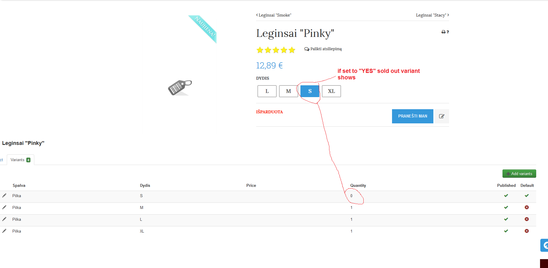

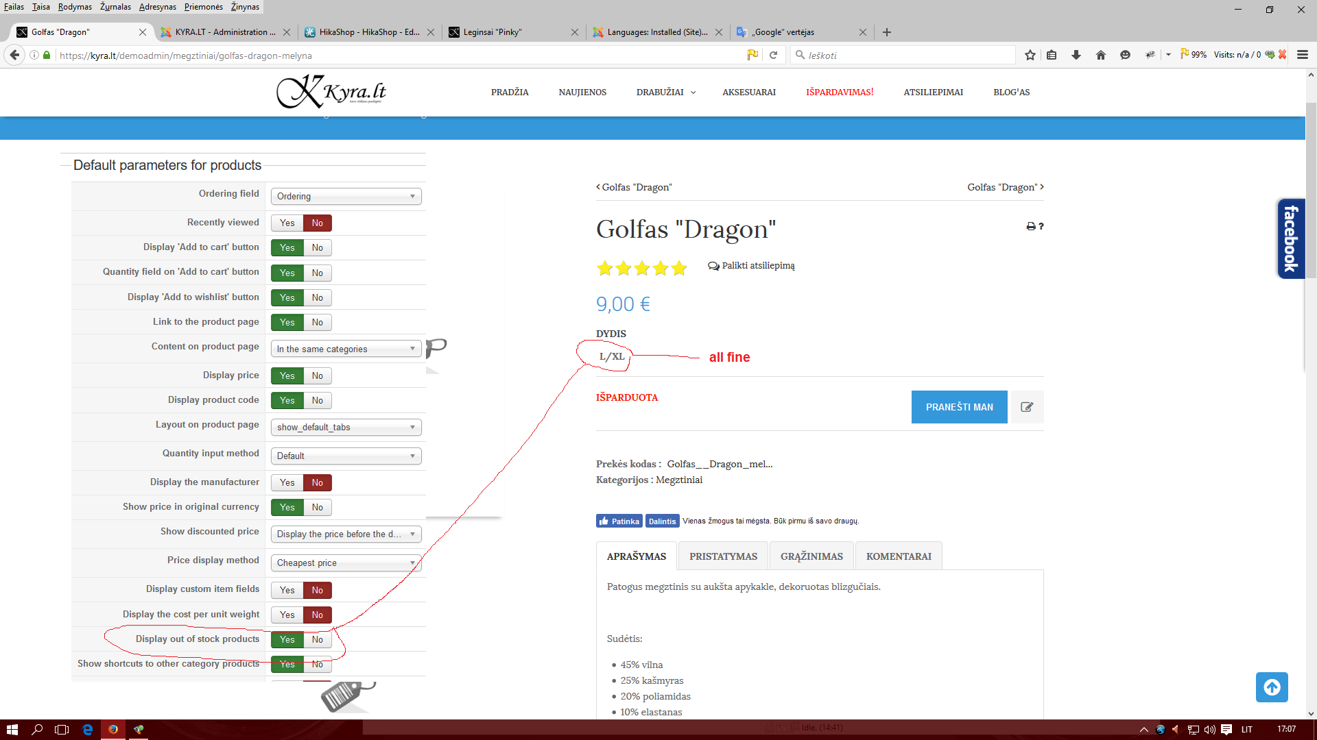

So after some digging it looks like i found from where this issue is coming.
If in System->display->Default parameters for products->Display out of stock products set to "YES" there is no js error and radio button is displayed as per you advise. If set to "NO" i see "No values found" which i had renamed for my language to "Nerasta" and JS error occurs.
If set to "YES" another issue arrives...Default variant which is sold out now shows on product page and is selected by default and ofcourse with sold out message. Same issue as before your code given.
If default product is unpublished all fine.....
I have attached some screenshots.
