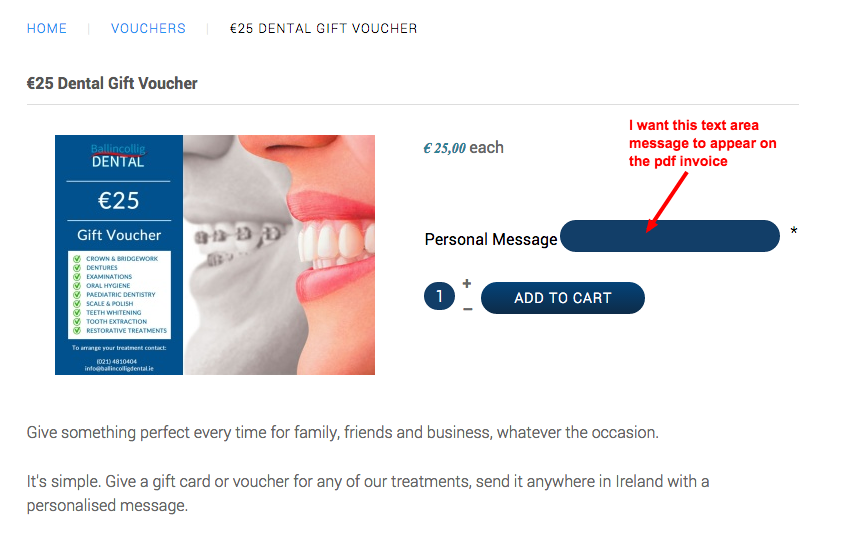

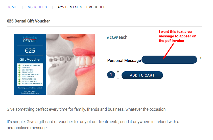

I have a custom text area field that a customer fills out when buying a product - how can i display this in the pdf invoice?
I looked in Views order / invoice.php and saw some reference e.g line 135 <p class="hikashop_order_product_custom_item_fields"> but the following php didnt seem right so i think I'm barking up the wrong tree!

11 years 2 months ago #209494 by nicolas
Replied by nicolas on topic PDF invoice
How did you configure your "custom text area field" ? Could you provide a screenshot of its settings so that we can understand exactly what you're trying to display ?

11 years 2 months ago #209518 by huwhuw
Replied by huwhuw on topic PDF invoice
Thanks Nicolas
See the screen shot

11 years 2 months ago #209585 by nicolas
That's a screenshot of the product page, not of the settings of the custom field, which is what I asked.
But based on your screenshot, I can confirm that it is a custom item field, and they are automatically displayed on the invoice, as long as you have a recent enough version of the PDF invoice plugin (less than a year) and that you have the "backend listing" setting of your field turned on.
So please check on that.

11 years 2 months ago #209599 by huwhuw
Thanks Nicolas - the issue was the "backend listing" setting of the field was turned off.

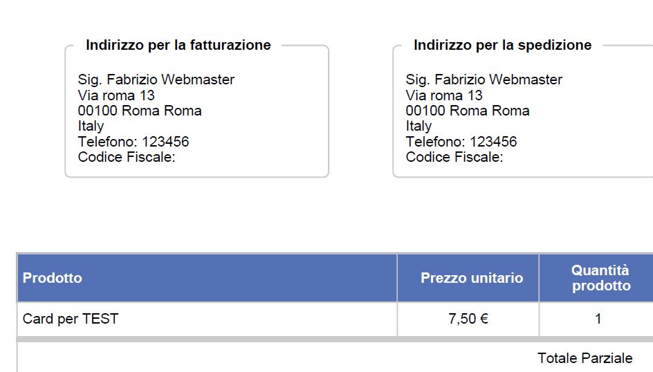

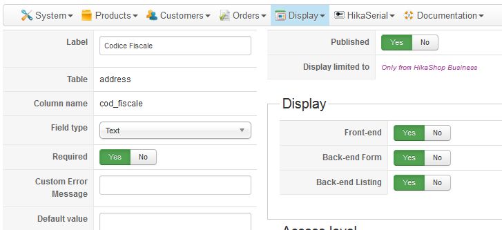

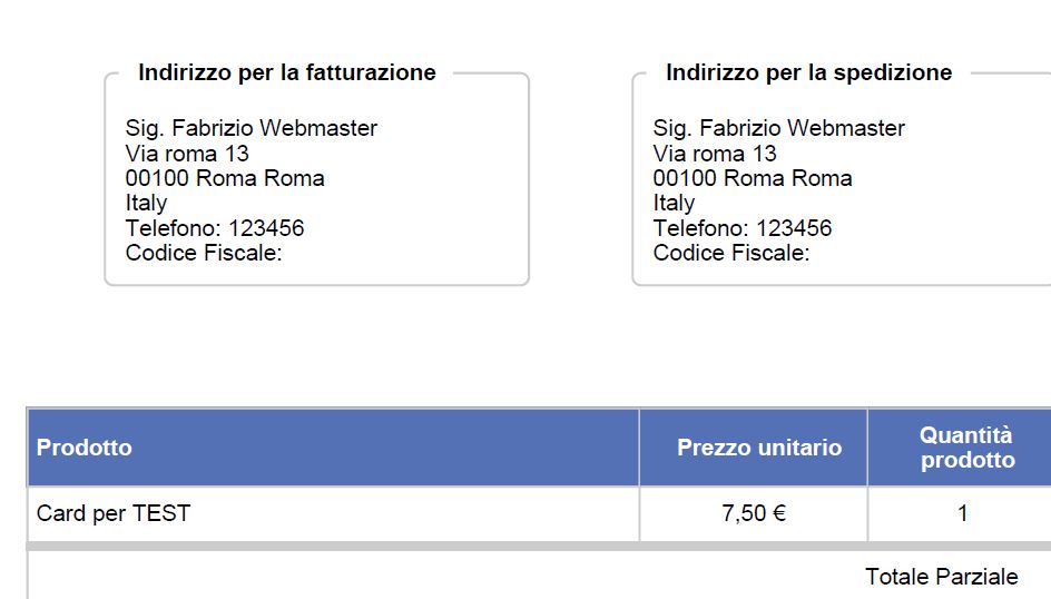

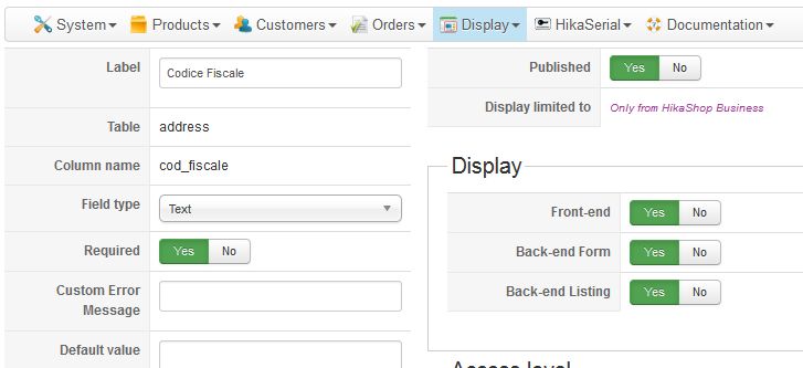

Hi all,
I need to show a Custom Filed too in the PDF Invoice, but I can't get it.
I've tried all I saw in this post but it not works.
I need to show a Custom Field called for example "VAT id" in the Attached PDF Invoice.
This is a legal requirement on Italian Invoices.
I set a new Custom Field with HikaShop Admin (Display -> Custom Fields):
Label: Codice Fiscale
Table: address (i need it with address infos of the customer)
Column Name: cod_fiscale
Field type: Text
Display: everywhere (Front-End, Back-End Form, Back-end Listing) and it is all green.
(See attached jpg)
I get no Custom Field in the PDF attached Invoice...
(See attached jpg)
I tried to write some new class instances in plugins/hikashop/attachinvoice/attachinvoice/invoice.php like this:
Code:
echo "<br />Codice Fiscale" . $addressClass->displayAddress($order->fields->cod_fiscale,$order->$oneAddress->cod_fiscale,$view); .... echo $class->displayAddress($this->element->fields,$this->element->billing_address,'order'); .... echo "<br />" . $addressClass->displayAddress($this->element->fields,$this->element->billing_address,'order');
without any success...
I see on PDF only the text parts of echo: "Codice fiscale: " and nothing more.
Why I have no custom field in the PDF Attached Invoice?
How can I write a correct class instance to get my custom field on PDF?
Did I forget something?
I read here that
...I can confirm that it is a custom item field, and they are automatically displayed on the invoice, as long as you have a recent enough version of the PDF invoice plugin (less than a year) and that you have the "backend listing" setting of your field turned on.
But it doesn't works.
Thank in advance for your help.
Best regards.
Fabrizio
Joomla 3.4.3
HikaShop Essential 2.5.0
PLG PDF Attached Invoice: No version showed in Joomla Plugin manager! (but I bought it three weeks ago)
Last edit: 11 years 2 weeks ago by fab966.

11 years 2 weeks ago #213819 by nicolas
You're looking at the wrong place.
What you need to do is to edit the file "address_template" for both your frontend and backend template via the menu Display>Views.
There, simply add the tag corresponding to your custom address field: {cod_fiscale}
That's it. No need to modify the PDF invoice plugin or add PHP code.
