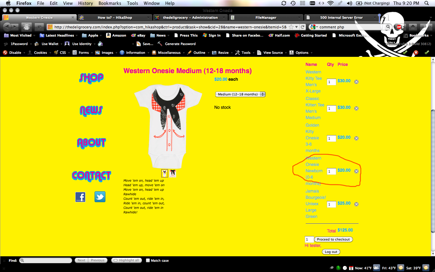

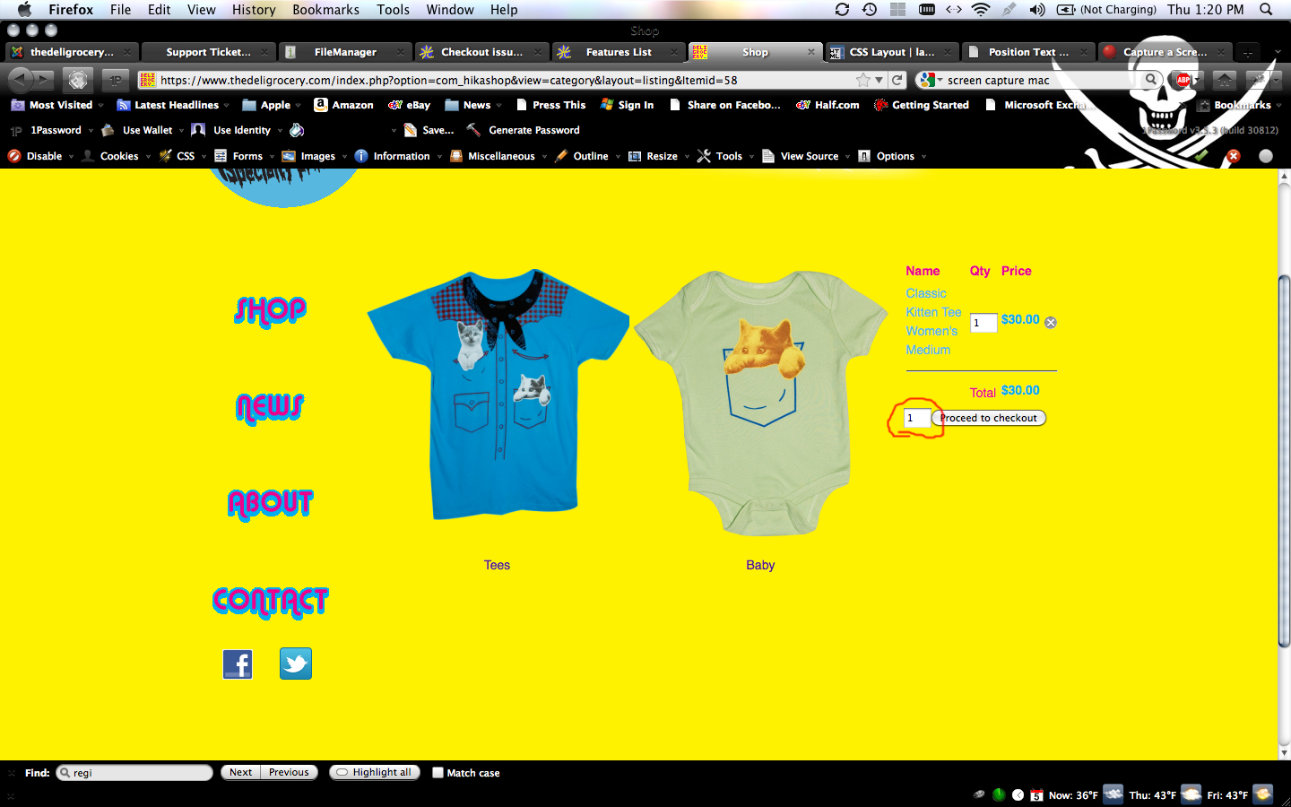

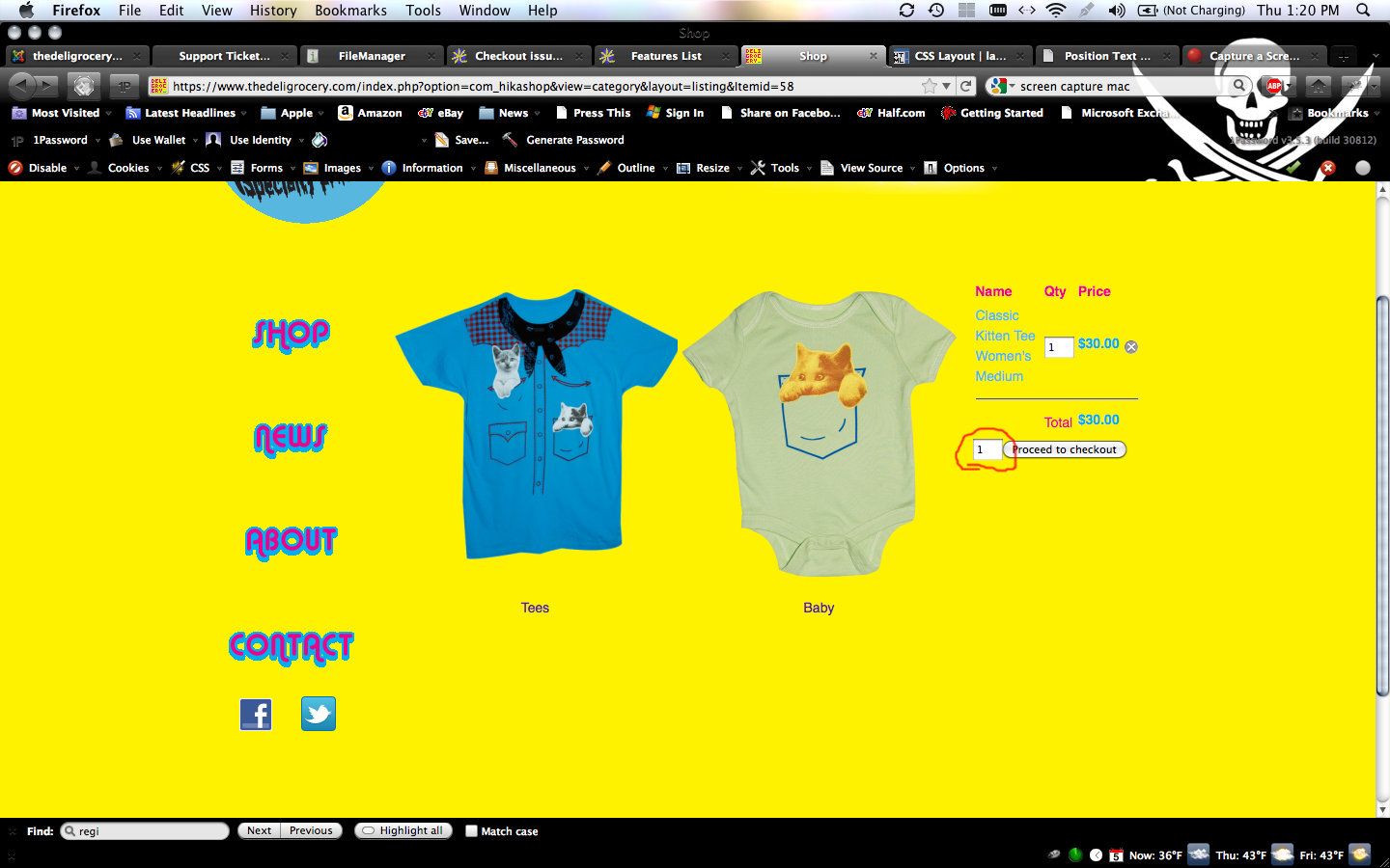

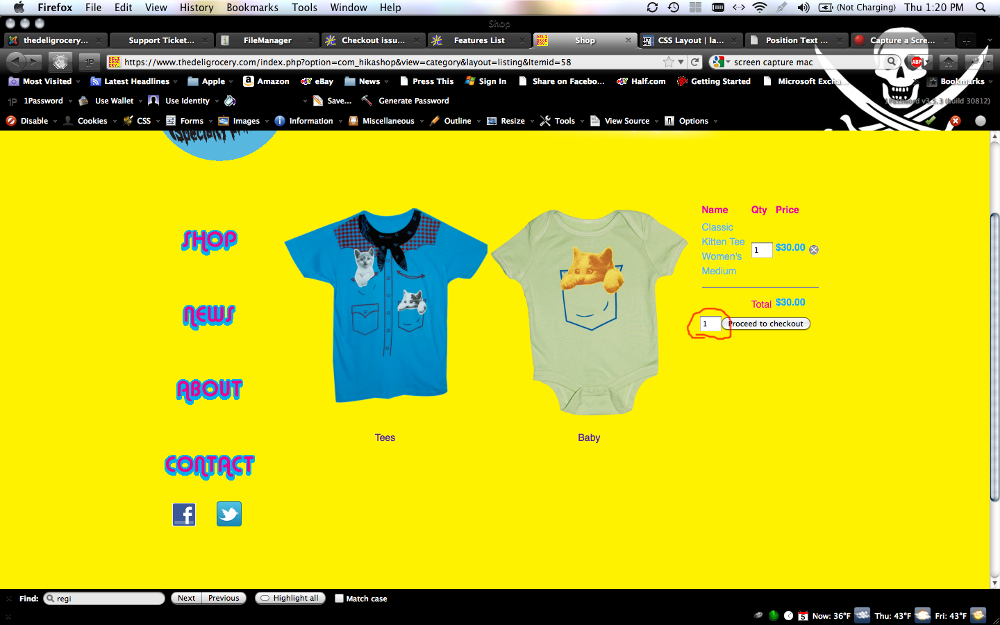

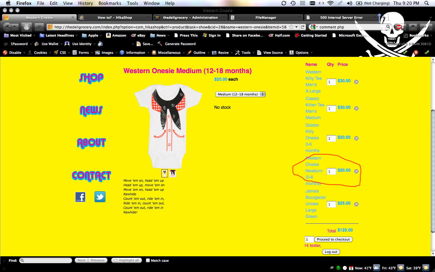

15 years 5 months ago #11977
Where is this box coming from (circled in red)? How do I get rid of it?

Concerning the box next to the button, that's a problem in the version 1.4.7 of HikaShop. If you update to the latest version, you should not get the problem anymore.

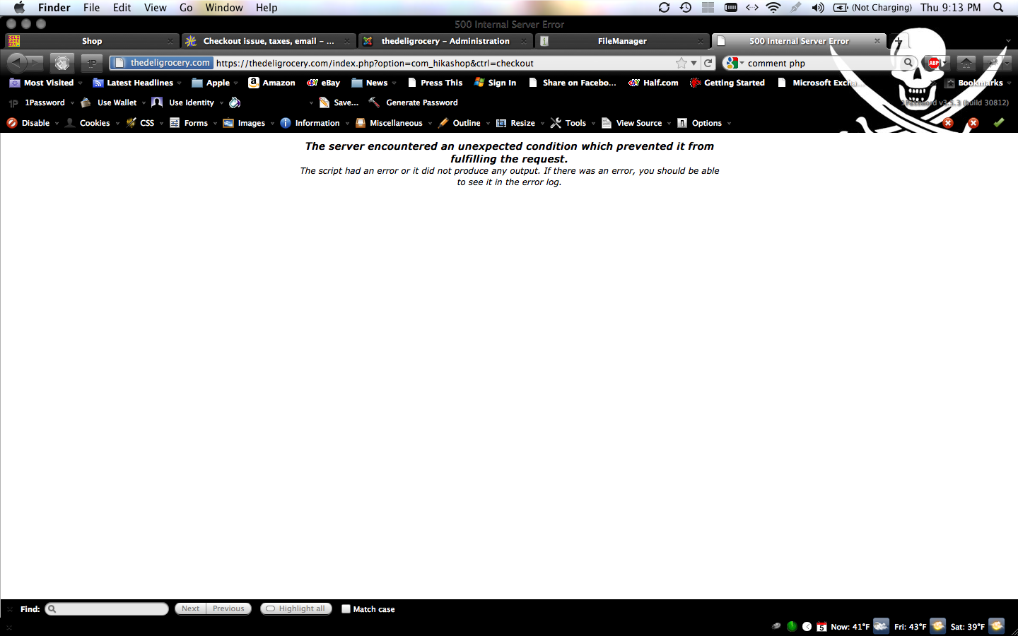

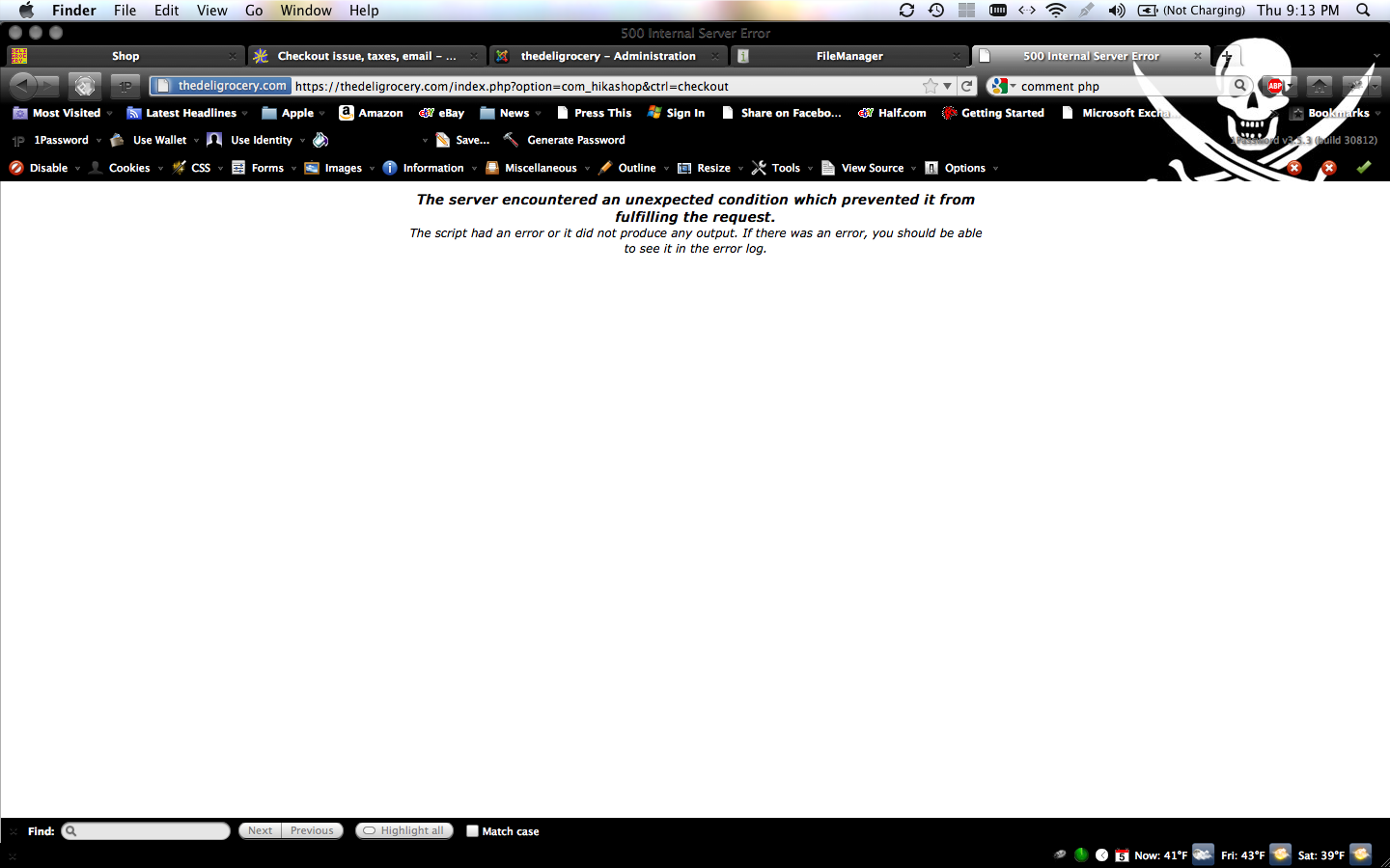

Okay. Here is a screen cap of the error. Not that it helps much. It only happens when I hit the back button or cmd+back arrow. First it goes to this:

15 years 5 months ago #12135
If you change the line:
$this->params->set('show_quantity_field', -1);
to:
$this->params->set('show_quantity_field', 0);
in the cart file of the view product, that should solve the problem.

Thanks. The checkout workflow is should be working now. I'm not getting the server error anymore, just random stuff added to the cart. I will post a series of screen caps.

15 years 5 months ago #12147
I'm not able to login anymore on your checkout so I still can't proceed to the testing.
It thinks that I want to register when I click on login. I see that you changed the login file of the view checkout. Could that be linked ?
For the error, I saw that post: forums.powweb.com/showthread.php?t=78849
Do you use that hosting ? Could you try the recommendations on that thread (activate CGI...) ?
Also, could you get your PHP error logs ? That should help us understand what this error is about.

I am trying to locate my error logs. That is not the hosting I use. I use ipage. I'm not sure what you mean by I changed the login file of the view checkout. I had no problem logging in. The error disappeared for a while but it's back since the weekend. Also, I tried that code for the shopping cart but it didn't appear to do anything.

15 years 5 months ago #12523
I was able to reproduce the problem, the login is working now :)
So, it's hard to say why that error happen. As written in the error message, you should look at the error logs. There should be written the cause of the 500 error and that will help us understand why it fails there.

I'm still getting this box despite replacing the code. The problem is, I'm not sure how to re-create the customizations I have applied to my cart so I don't want to just download an update.

15 years 4 months ago #13604
The line change I posted should work as it worked for everyone else. Could you post the code of the cart file ?
