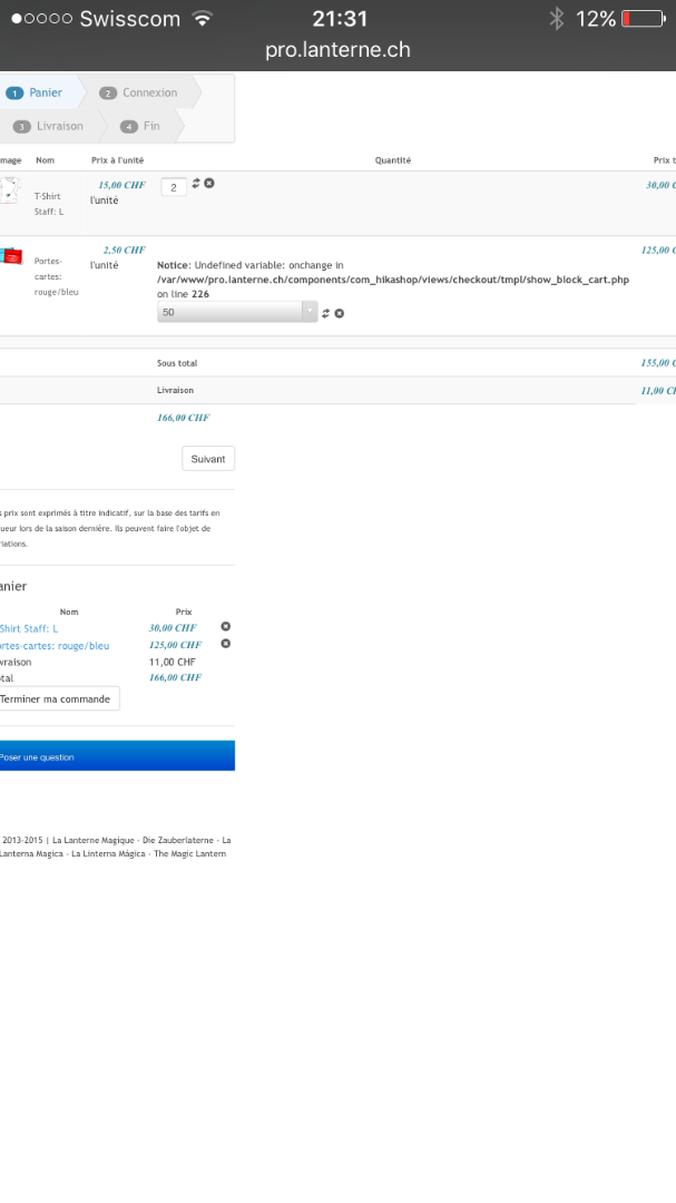

An other problem when I choose a variant; error message (see attached).
Thanks.

2. Download the install package on our website and install it on yours and that should fix that.
You have a partial update ; not all your files are up to date and your database is not good too ; just check the build number in your HikaShop configuration and you will see.
5. The warning has been fixed, thanks !

2. I follow your indication but nothing change; I don't know exactly why, but I presume that the update is still partial. If I turn-on the debug mode, I've no error messages. If I press the button "check the data base" on the main-configuration there is no error who are indicated. And if I check the build number in the HikaShop configuration, I have no way to know if it's the last-one because I can't found a place on your website where the last built-number is indicated... Can you check directly as you have a super-admin account on my website ?
5. The warning remain; I presume because the update fails...

2 - The JS patch is now present in your website.
5 - The patch was not present.
I'm afraid that we are including patchs in our packages but if you can't install correctly the package in your website we can't do more.
