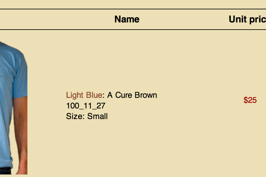

Hello- I have 2 questions:
1. How can I move the product code below the options in the cart? I am editing the view checkout/cart and I got the code below the name using the <br /> tag, but I would like it to be below the options, in this case the shirt size. (see picture)
2. Is there any way to override the template link color for hikashop? In the picture, the "light blue" product name is the link, but I would like it to be black, and the links elsewhere in the site to follow the brown template color.

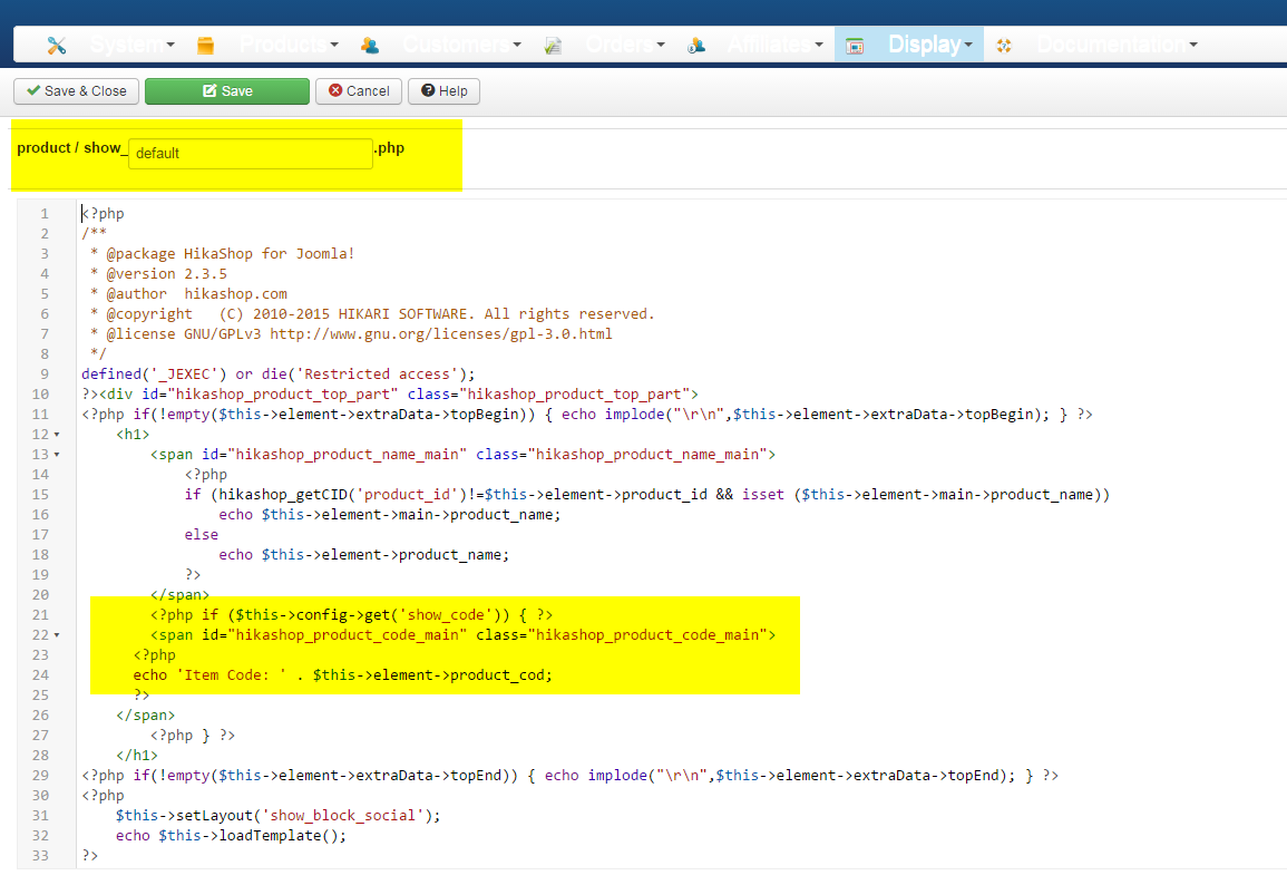

it's been a while since this post. i got the same problem as "word" here. I'm using your code above but there are no changes to the product site. I also was reaing an other post from you to put a break <br/> between item code and productname, but nothing happend. what do wrong?
sorry i'm working lokal on my shop, so here are the code from product / show_.php :
<?php
 * @version	2.3.5
 * @author	hikashop.com
 * @copyright	(C) 2010-2015 HIKARI SOFTWARE. All rights reserved.
?><div id="hikashop_product_top_part" class="hikashop_product_top_part">
<?php if(!empty($this->element->extraData->topBegin)) { echo implode("\r\n",$this->element->extraData->topBegin); } ?>
	<h1>
		<span id="hikashop_product_name_main" class="hikashop_product_name_main">
			<?php
			if (hikashop_getCID('product_id')!=$this->element->product_id && isset ($this->element->main->product_name))
				echo $this->element->main->product_name;
			else
				echo $this->element->product_name;
		</span>
		<?php if ($this->config->get('show_code')) { ?>
		<span id="hikashop_product_code_main" class="hikashop_product_code_main">
      <?php
      echo 'Item Code: ' . $this->element->product_code;
    </span>
		<?php } ?>
	</h1>
<?php if(!empty($this->element->extraData->topEnd)) { echo implode("\r\n",$this->element->extraData->topEnd); } ?>
... and so on
Attached a screenshot to see the site and the elements i was talking about
I'm using Joomla 3.3.6 and hikashop 2.3.5. maybe there are some updates of hikashop why this is not working for me???
Thx for you support
Cobi
Last edit: 11 years 6 months ago by cobi.
11 years 6 months ago #191030
product / show_.php
Is that the real name of the view you are editing ? If it is, the issue is there, we don't have views called like that ;)
There is "product / show" or "product / show_default" for example.
If the view name is correct, so just a mistake in your post, please be sure that you are editing the view in the correct template.

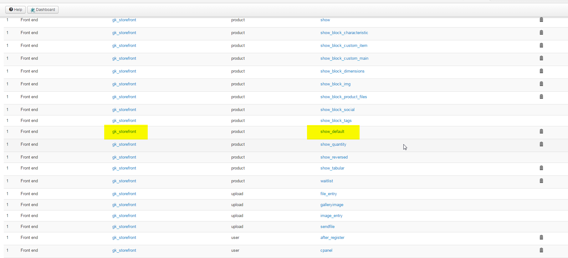

sorry, this was my fault. you are right i missed typing the correct file description. I was editing the file show_default in the correct template (in my case it is a template called storefront), as you can see on the screeshots attached.
so any idea what could be the problem?
11 years 6 months ago #191181
This is maybe a cache issue. Please try to disable the cache in Joomla settings and Joomla cache plugin, then clear it.
If you don't have any cache, even in the template, so I don't really see why it's not working as expected, everything seems to be correct. If the template is the good one, and you are using the view "show_default" in the settings, so...
ps: in the last screenshot you forgot the "e" in the code "$this->element->product_code;

  • Posts: 15
11 years 5 months ago #191936
hey xavier,
thx again for your support. yes im sure that I'm on the right show_default. now I was exactly walking to the root as you told me in your post before, everything inside the file was fine, but I changed something just to figure out if somethings happens - but nothing changed!
So I go a step further and deleted the hole show_default.php and guess what happens? Yeah right! NOTHING - everything is like before, nothing changed. So for me it's clear, there must be an other file that depends on the view, maybe it comes from the template that I'm using?
So if you please have a look on the demo site of the developer so you may get an idea of what could be the probleme? Here is the Demo Site: demo.gavick.com/joomla25/storefront/
the only probleme is, in the demo they don't show up the item code bye default, but maybe you can find it out anyhow ( I pray)
thx so much for staying on my site to get this thing done
best wishes
cobi
11 years 5 months ago #191950
It seems that the view used is the "show_tabular" one and not the "show_default" one. ;)
You can check the settings in the HikaShop configuration, or in the menu/module settings directly.
