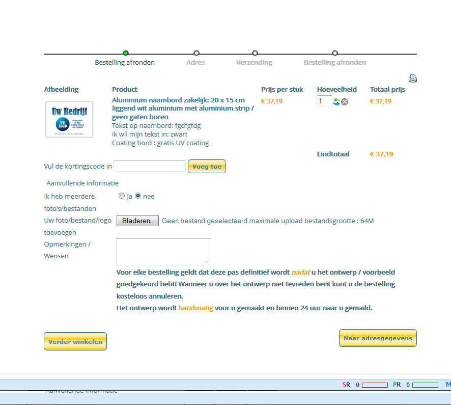

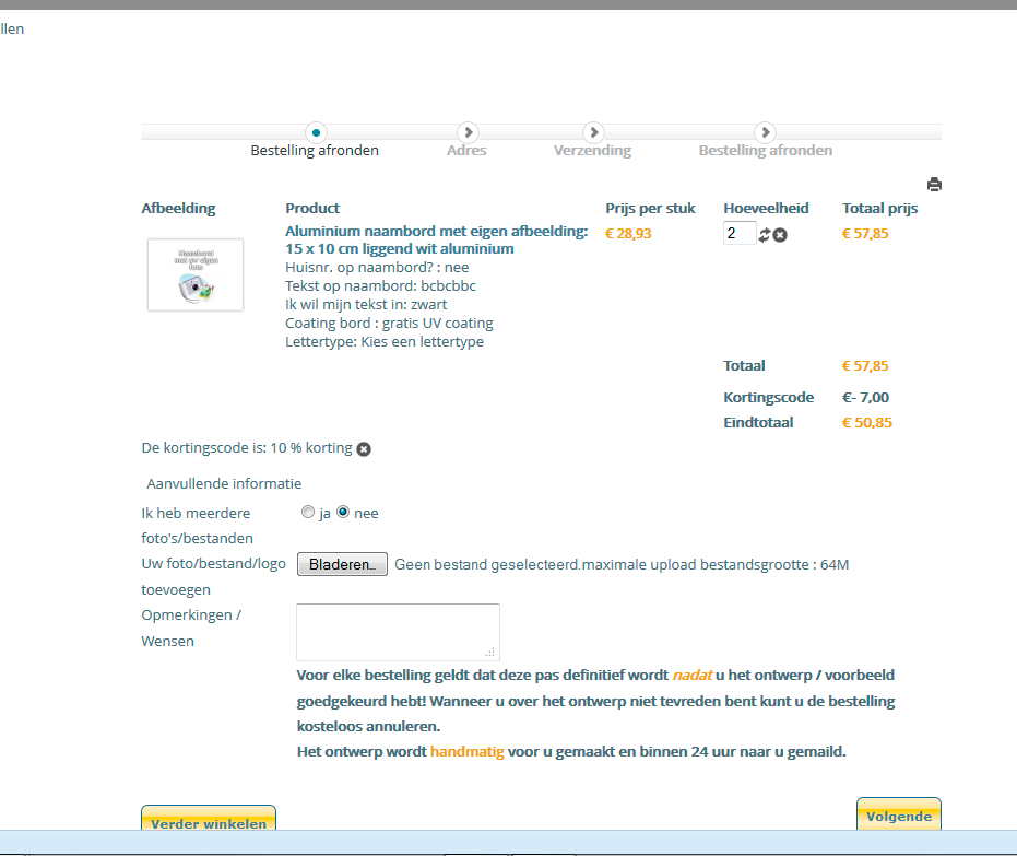

I upgraded (finaly) to Hikashop 2.2.3 (from 2.1.1). There were several things to adjust and many are solved, but there is one left. The tax is not showing on the checkout page. This wordked fine for years in Hikashop 2.1.1 (and before). I've tried everything, made a complete new taxcategory, zone, rate. It's just not showing up in the checkout. The productpage shows the price with tax, but once in the checkout the tax doesn't show anymore. (The url provided is a not used url for testingpurposes).

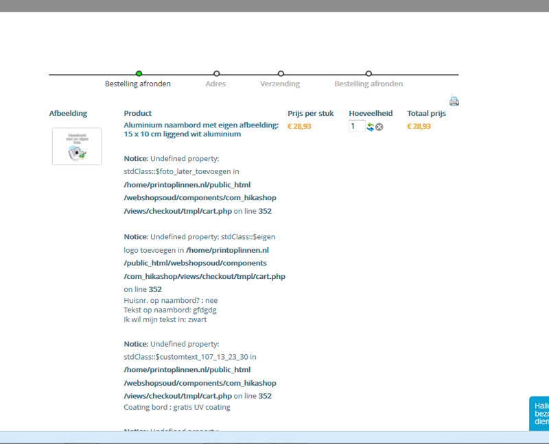

No I truncated all the modificated files, but the tax isn't showing and there's also strange behavior of my custom fields. Some modules on the left side are also corrupted.

Ok, and can you :
- edit the file : "components\com_hikashop\views\checkout\tmpl\cart.php"
- change this line :
if(empty($row->$namekey) && !strlen($row->$namekey)) continue;
by :
if(empty($row->$namekey) || !strlen($row->$namekey)) continue;
- and test it again ?
Thanks.
  • Posts: 515
  • Thank you received: 22
12 years 7 months ago #144578
Ok, changed that. Seems to solve the strange behavior of the custom fields. Still, the tax is not showing.

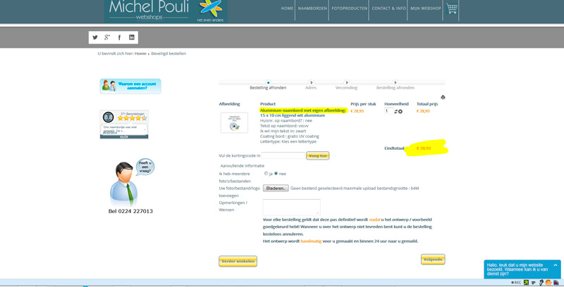

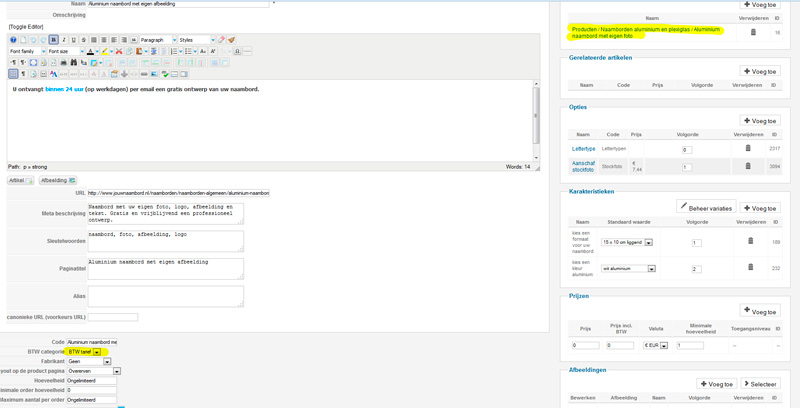

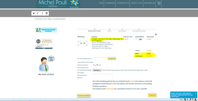

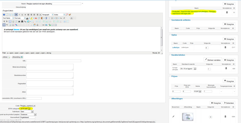

I discovered that the tax is not showing on some products. On others it does. For example article ID 742

12 years 7 months ago #145033
Please check that you have selected the correct "tax category" for all your products when you edit them.
  • Posts: 515
12 years 6 months ago #145133
They are. It's already working fine for years in Hikashop 2.0.
  • Posts: 86183
12 years 6 months ago #145210
If it works for some products and not others, the only reason is that the products for which it doesn't work have a tax category which is not correct. There is no other reason I can give you as I don't think that there is any other plausible reason
  • Posts: 515
12 years 6 months ago #145224

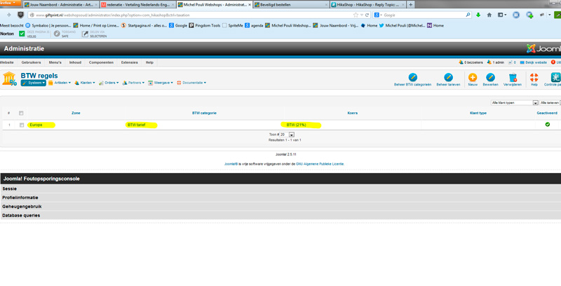

I can understand your argumentation, I agree. Still there's only one tax category (europe) wich I use for all the products. here are the screenshots. I searched for a reason, but can't find any.
Michel
  • Posts: 86183
12 years 6 months ago #145453
Then it means that in the product_tax_id column of the hikashop_product table, you have some inconsistency for the variants of these products.
I would recommend to create mass action on all your products/variants and set that column value to the id of the tax category of your tax rule with an "update the value" action on that column and that should help.
  • Posts: 515
