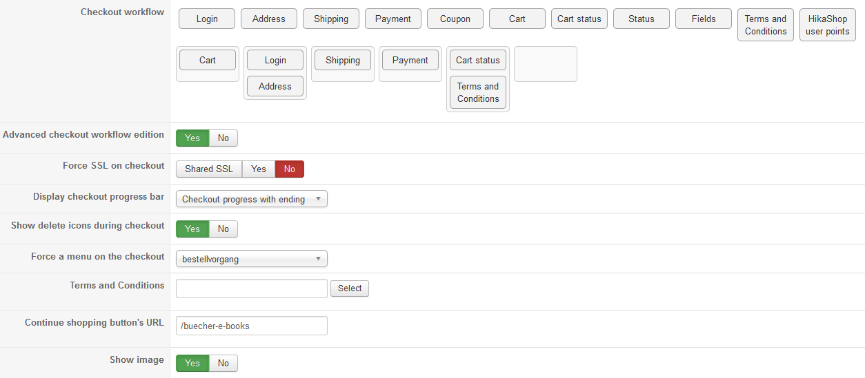

Would it be possible to have a screenshot of your Checkout workflow ?
  • Posts: 154
  • Thank you received: 4
11 years 10 months ago #178645
sure, there you go

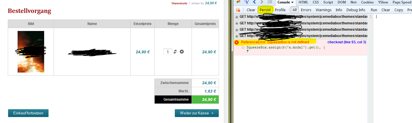

11 years 10 months ago #178946
hi jerome,
problem still persists, be careful to enable "persist" in firebug console, and also keep in mind that this only happens the first time adding something in cart. in order to reproduce this afterwards you need to clear your browsercache/cookies...
i attached you a screenshot
  • Posts: 26386
  • Thank you received: 4078
11 years 10 months ago #178961
I think that
JHTML::_('behavior.modal');
is still call in the HikaShop cart helper.
The following user(s) said Thank You: olivnewton
  • Posts: 154
11 years 10 months ago #179119
alas! that did the trick, thanks a lot, nobody pointed to this before...
