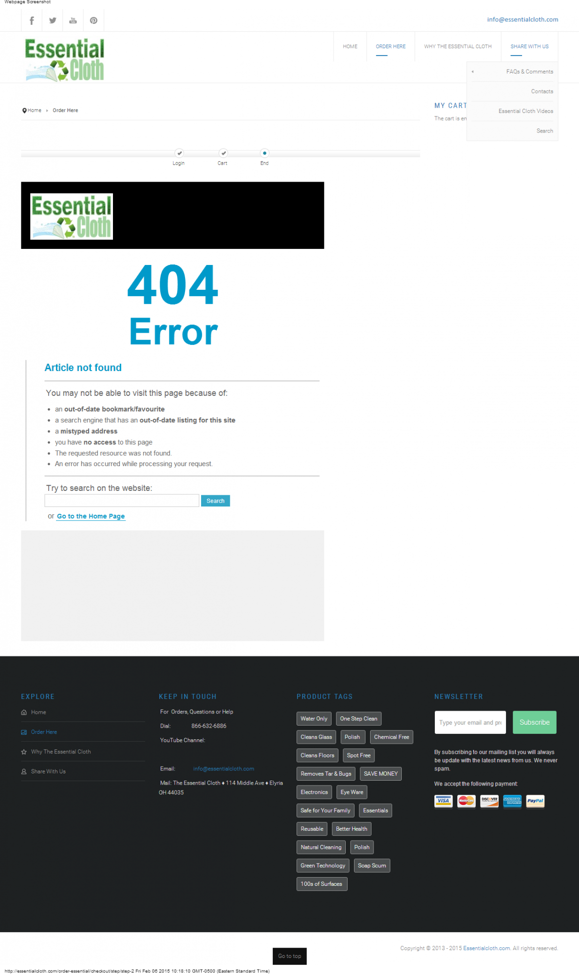

We use Authorize.net as our gateway and for PCI compliance we need to have HikaShop API set to DPM but when it is set to that it causes a blank screen, i attached a screen shot of the cart
We bought and convert to HikaShop Business for all of the extension functions as well as ease of use but we have run into this huge roadblock. We did not see the API as being this big issue??
Your thoughts to this solution is need
Kevin
Note: I reset the API back to SIM so we can still receive order

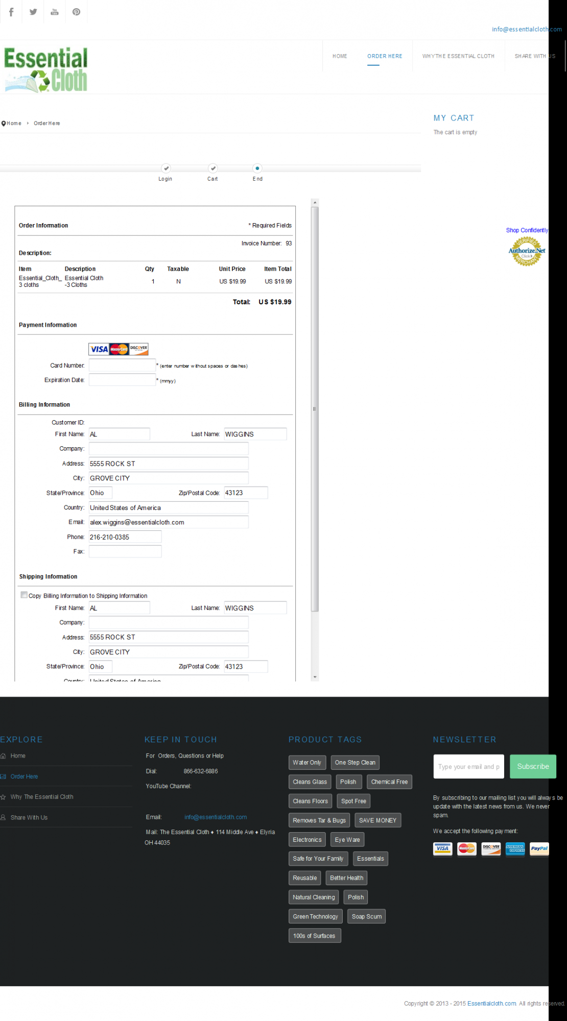

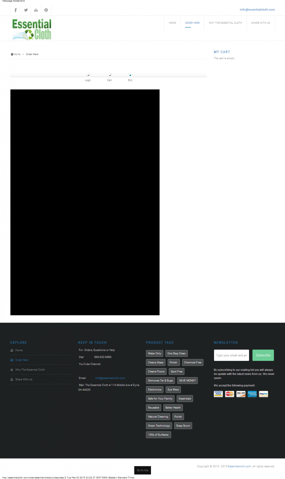

11 years 7 months ago #189836
Mohamed
yes i changed the API setting to DPM...now here is what it looks like. see attachment.
We will put it on SIM mode temporarily until you resolve the issue.
I also changed the authorize.php with the code you provided.

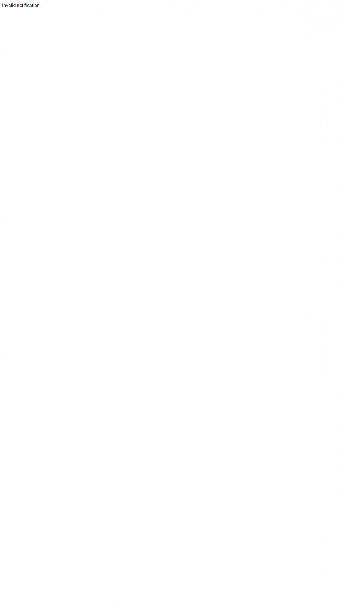

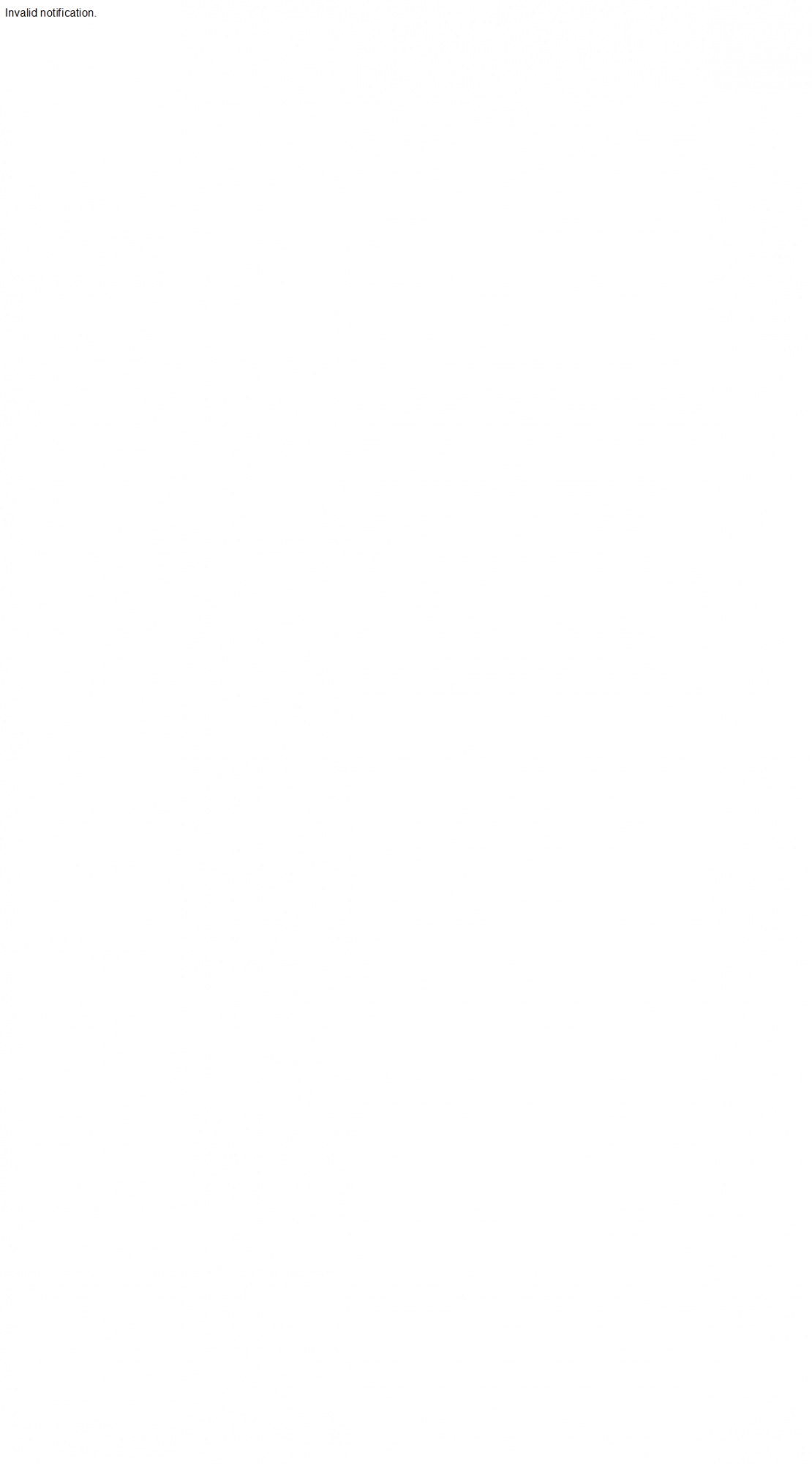

11 years 5 months ago #198489
Mohamed
We uploaded the new Authorize plugin 04-02-2015 but we got some glitches.
1) it does not show that a customer can pay with AMEX or JB bank card
2) after putting in cc information the next screen is blank! Nothing that inform the customer if the transaction was approved or decline just the INVALID word.
That is the update the DPM issue
