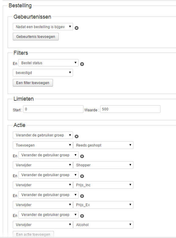

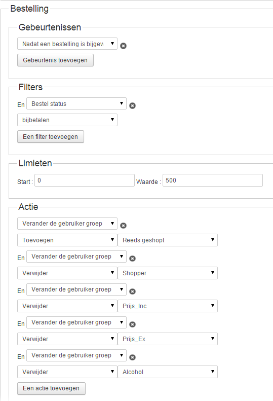

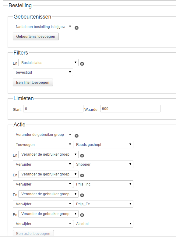

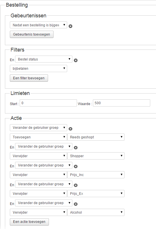

10 years 8 months ago #221532
Please give us a screenshot of your mass action settings.
I was thinking that you were triggering on "onAfterOrderCreate()", so if it is not the case, you have to trigger on this.
  • Posts: 79
10 years 8 months ago #221625
No
i was struggling with this. I don't use "create", because the status of the order is changed in the payment methods (one changed to 'bevestigd', the other is changed to 'bijbetalen'), so I think I shouldn't use 'create' but 'changed' because the payment methods come first in the process, not?
And... as it is working now I think this is right.
I have a total of 3 different order massaction jobs. 2 for changing acl after order (runs every minute) and 1 for export order (for daily bulk export and change order status to 'verzonden').
No I have the change-acl finally working! And with the user session refresh the ACL change is even applied without logout.
But, the export order is stil not working (for this we have another thread in the forum).
regards
Suzanne
10 years 8 months ago #221631
Yes indeed the "onAfterOrderCreate" is not adapted in your case, but maybe the "onAfterOrderUpdate" one can work.
If you select a filter on the desired order status, that can do the job. The cron solution every minutes is a correct solution too.
