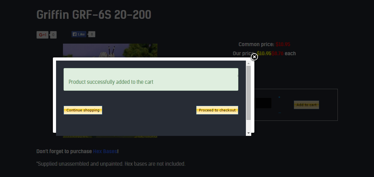

I'm working on a site redesign and the cart pop-up when you add something to your cart...has a section that is off screen. I found where to modify the pop-up size...but no matter how I change it...it still has an option to scroll down. Please see attached image...you will see the scroll bar on the right.
How can I fix this? I'm getting close to making this my live site.
Thank you!

10 years 10 months ago #220705
First I think that you should change the settings of the option 'Add to cart popup size' in Configuration > Main > Cart to use the height of "220".
Then in your file "/media/gantry5/engines/nucleus/css-compiled/nucleus.css" there is the property:
#g-page-surround {
    min-height: 100vh;
    position: relative;
    overflow: hidden;
So the "min-height: 100vh;" is the css which is forcing the height of the content, so a scroll bar is displayed.
You can remove this property or add the following one at the end of this css file:
#g-page-surround {
    min-height: auto;

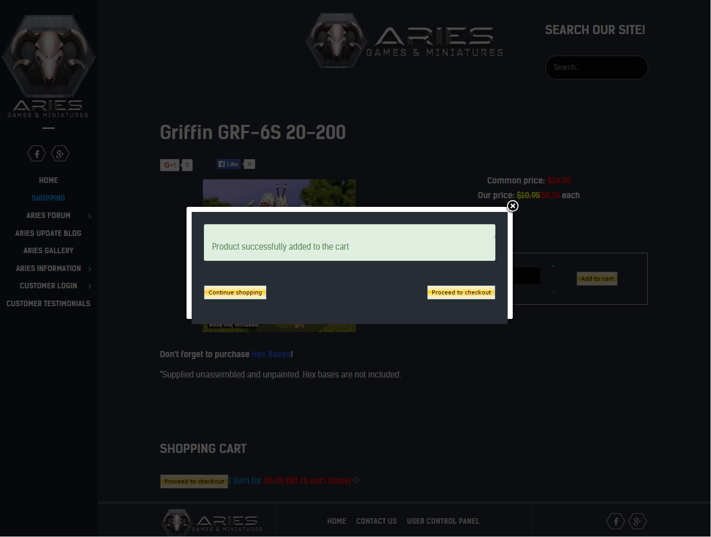

10 years 10 months ago #220766
Ok...did exactly what you said, and the scroll bar is now gone, but the bottom of the box itself is still going past the viewable section as shown in the image attached. Any thoughts?

10 years 10 months ago #221487
I've had a closer look thanks to the access, but it looks like a problem relative to your Joomla template and it won't be fixable with CSS code only.
The height set for the inner iframe of the popup is the same size as the border div while it should have a height 20px lower than it.
If you switch to protostar template, you can see that this problem doesn't occur.

10 years 10 months ago #221515
For my Rockettheme template - the following solved the misaligned boxes:
Set the following as a CSS override (how will depend on which version of gantry you are using)
#sbox-window {
padding:0;}
Cheers
Henryk

henrykk
Thank you! That worked. I'm checking to see if anything else was effected, but the only thing I can see is that the white border is now gone. Any thoughts on how to bring that back so the pop-up isn't lost to the background colors?
10 years 9 months ago #221545
Instead of the:
#sbox-window {
padding:0;}
property you can try:
#sbox-window {
height:240px !important;
