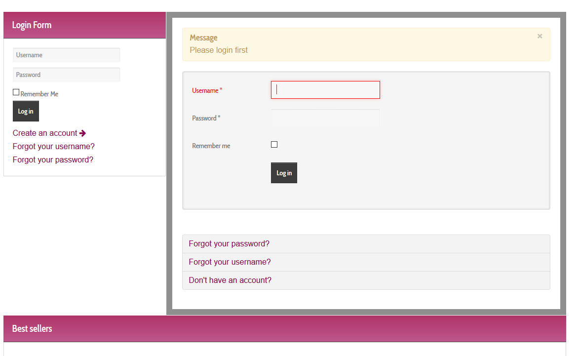

  • Posts: 51
9 years 5 months ago #265938
Dear Mohamed, we have updated the plugin as requested, after putting a product in the basket and clicking on the Paypal button it is still taking us to the login page as attached. Can you please email us at This email address is being protected from spambots. You need JavaScript enabled to view it. and we can send you the login credentials. Thank you. Chris
Kitt
9 years 5 months ago #265948
Hello Chris,
Firstly, can you give us a link to your website so that we can directly test it and check your Hikashop version ?
Thank you.
  • Posts: 51
9 years 5 months ago #266034
You have the latest stable version of HikaShop Business: 3.0.1
www.honeysuckleyard.com/index.php
www.honeysuckleyard.com/administrator
All of this information together with the login details were sent yesterday in a EMail through the contact Us page. Best Regards Chris
Kitt
  • Posts: 86216
  • Thank you received: 14222
9 years 5 months ago #266104
If you activate the debug setting of your payment method, you'll see that you get this error:
monosnap.com/file/YtODkaLbrNjSzuqygUflz5jjQp28iG
And if you search for that error message online, you'll find this:
stackoverflow.com/questions/23358683/pay...-header-is-not-valid
Which explains that this error is returned by PayPal when the credentials you provided in your payment method are incorrect.
So you'll have to check with the support of PayPal your credentials as something must be wrong with them.
