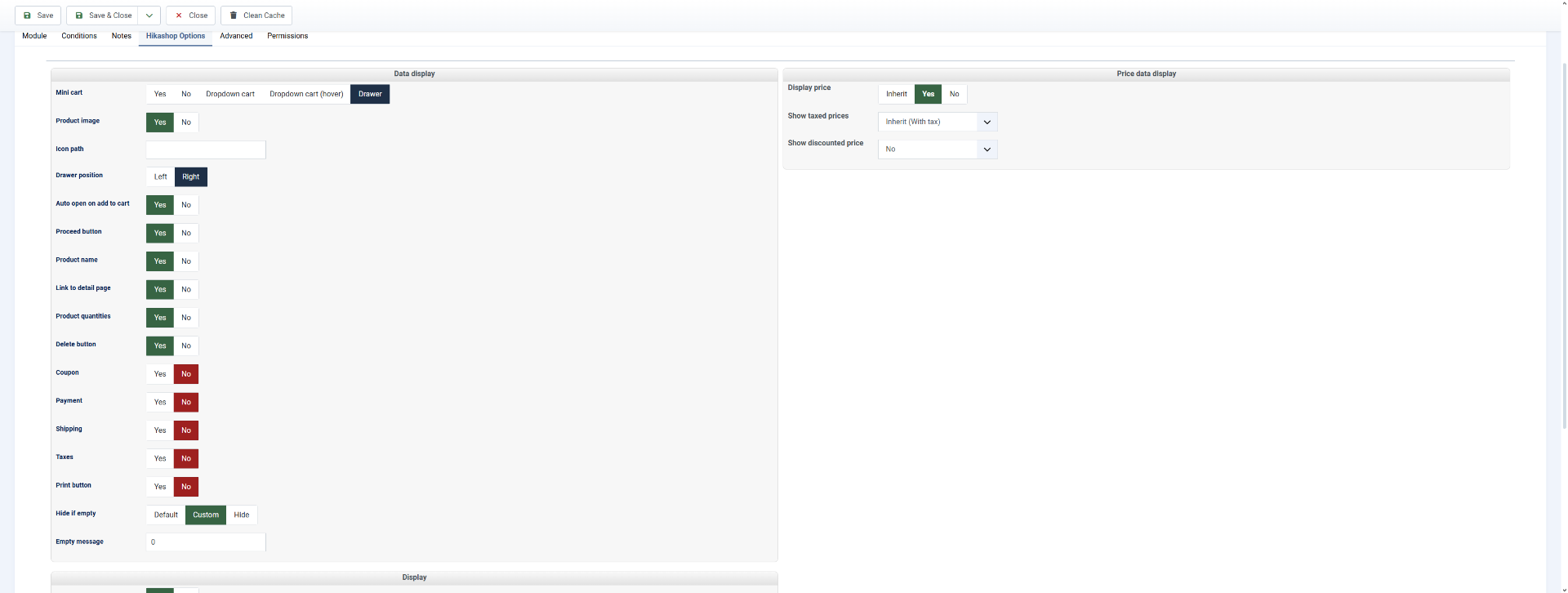

I notice some issue once we set the shopping cart into drawer mode.
When user add item to cart, the drawer not open on the right side after the config we set to open on right after user add item to cart.

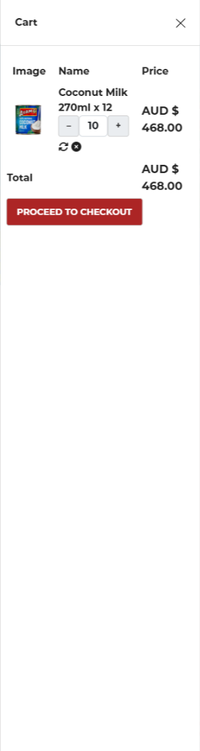

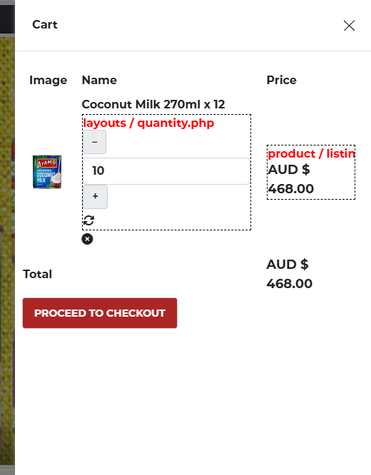

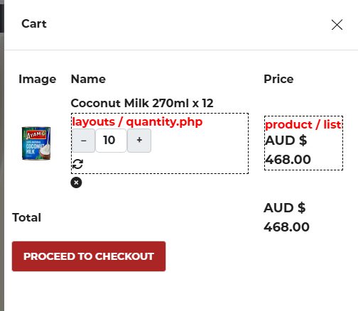

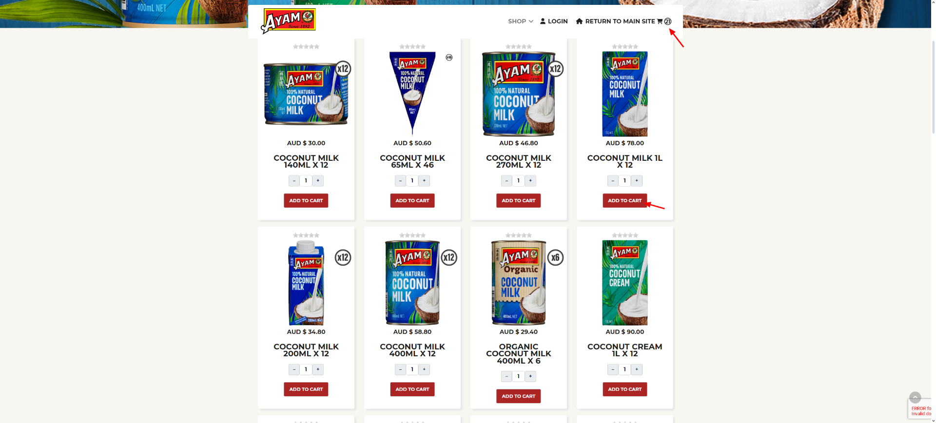

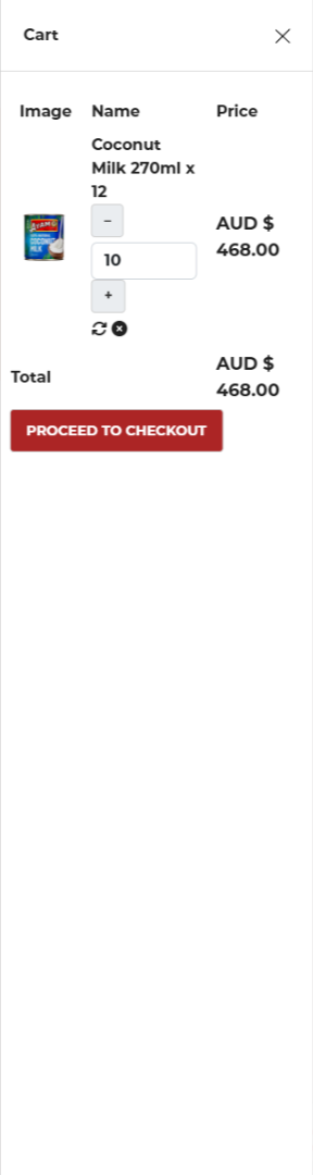

Here is the link to the page, wip-ayam-au.cloudaccess.host/index.php/online-store . Once i add item on the cart, the cart drawer not display as what it should be displayed. Refer to the atachment.
Here is the cart view from another page ( wip-ayam-au.cloudaccess.host/index.php/shop/coconut ). The above should be displayed as this page. Refer to the attachment.
As far as i see the code also different between each page. Can you help to check? Thanks in advance sir.
  • Posts: 86079
  • Thank you received: 14186
10 months 2 weeks ago #368936
From what I understand, it seems that you've customized the display of the quantity input area, but the customization only applies in one case and not the other.
You must have made it via a view override.
The first thing to do is to activate the "Display view files" setting of the HikaShop configuration and check that the same view file is used in both cases. If that's not the case, then you probably want to add your customization to the other view file so that both are consistant.
If it's the same view file, then you'll have to debug the code in the view override you've made.
Maybe some variable is different for some reason and the customization doesn't take that into account properly ?

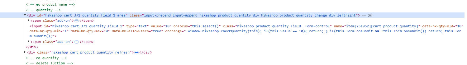

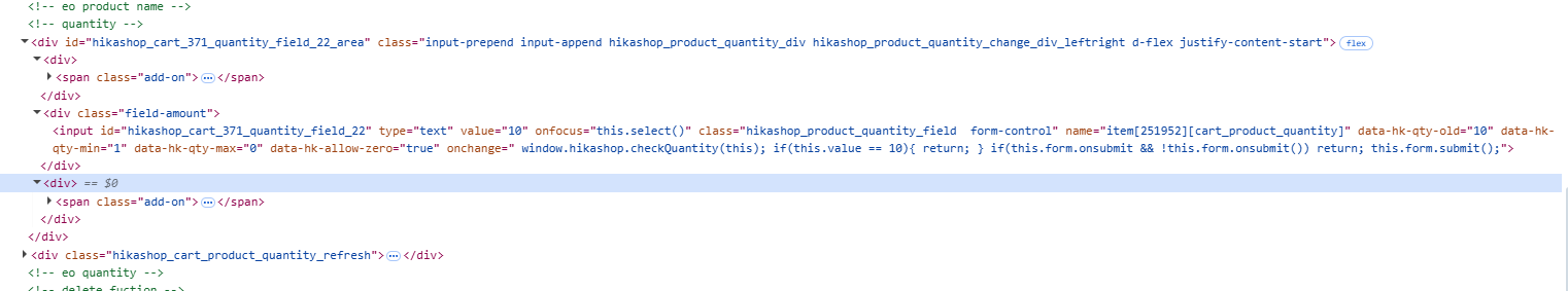

10 months 1 week ago #368946
I could not find the problem.
The cart are using the same module hikashop cart same as other page.
On checking the layout, it using the same layouts/quantity.php and it already overwrite.
This is the problem page ( wip-ayam-au.cloudaccess.host/index.php/online-store )
This is the working page drawer ( wip-ayam-au.cloudaccess.host/index.php/shop/coconut ).
Can you help to advice on this?
  • Posts: 86079
10 months 1 week ago #368950
Since both use the same layout and it has an override, rename temporarily the templates/YOUR_TEMPLATE/html/com_hikashop/layouts/quantity.php file to something else via FTP.
This will deactivate the override. Then, clear your website cache if any, and check that both pages display the quantity input in the cart module the same way.
If that's the case, the problem is with the customization made in the override. I don't what change you made so I can't say what to do exactly. If you can't figure it out, I can have a look at the problem for a fee since it falls into the custom development category. In that case, I'll have to investigate with a backend super admin access.
If that's not the case, and you still have the display difference between both pages, then it would point at a bug in the default code of the view file for some reason. In that case too, I'll have to investigate with a backend super admin access.
So, you can follow up on this via our contact form:
