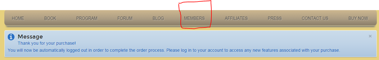

Quick question on the "fix" and I know this is crappy to through this in, but I have to try.
I have the "redirect on login" extension installed. extensions.joomla.org/extensions/access-...login-redirect/15257
Basically, the client wanted their customers that are part of the "maintenance program" to get a daily message when the log in. I have all of that working great. Is there something that could be done to that file that would follow this logic?

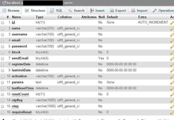

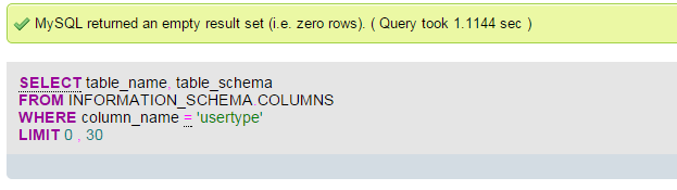

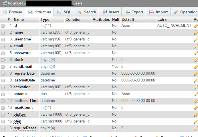

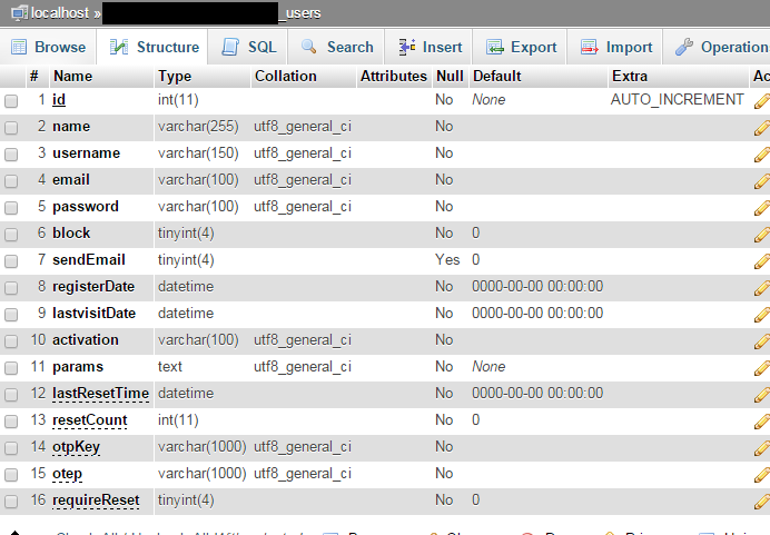

  • Posts: 49
11 years 8 months ago #181172
That sounds perfect, but I cannot find the column you are talking about:
  • Posts: 23
11 years 8 months ago #181173
sorry, I adopted the database i was referencing for helping you and I think it's a version thing. Going to research and get back to you.
Last edit: 11 years 8 months ago by webcandy.

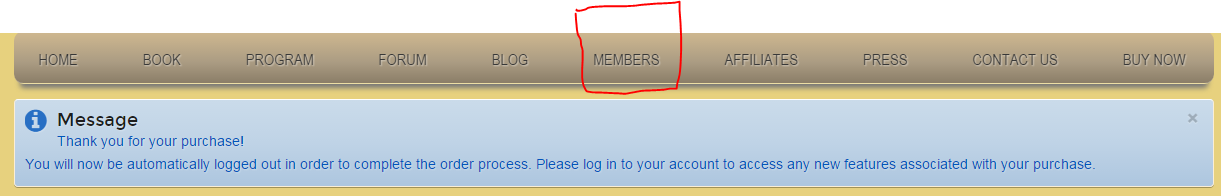

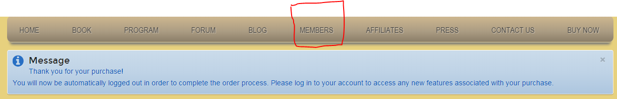

korzo, no luck with that setup. I just sat at the thank you message, everything else working properly of course. Also, wouldn't I need a time to sit at the message screen before the redirect? Actually, it might be fine without. If they are in the maint program, it is cool if they just go see their cool daily message right away. The only downfall I can see is they would not get a confirmation from the site that the purchase went through, until they check their email.
Here is what I have in the file:
jimport('joomla.access.access');
$user = JFactory::getUser();
$session = JFactory::getSession();
JAccess::clearStatics();
$session->set("user", new JUser($user->id));
$group_id = 11; // Id of group you want to redirect
$url = 'https://www.domain.com/members'; // URL to redirect
if(in_array($group_id, $user->getAuthorisedGroups()))
    JFactory::getApplication()->redirect( $url );
group:
user:
EDIT: Also very interesting in this statement from you; "Also don't forget to move your modification to template folder(aka view override) or update the code in Hikashop->Views to not loose your modification after update."
Do you just move the checkout/after_end.php file to the root directory of the template?
Last edit: 11 years 8 months ago by YeeP.
  • Posts: 193
  • Thank you received: 76
11 years 8 months ago #181198
YeeP wrote: korzo, no luck with that setup. I just sat at the thank you message, everything else working properly of course. Also, wouldn't I need a time to sit at the message screen before the redirect? Actually, it might be fine without. If they are in the maint program, it is cool if they just go see their cool daily message right away. The only downfall I can see is they would not get a confirmation from the site that the purchase went through, until they check their email.
If it works, you will be redirected to www.domain.com/members with 'THANK_YOU_FOR_PURCHASE' displayed.
According to screenshots it should work.
Could you add
var_dump($user); die();
at the end of this code and post the displayed result? Edit out sensitive information before posting.

  • Posts: 49
11 years 8 months ago #181205
korzo- There could be a problem with it loading the way you think it should caused by the following. When you go to the members part of the site, you get a popup daily message. Not sure if that could cause it.
Please let me know if there is something I should have removed from the following:
object(JUser)#36 (27) { ["isRoot":protected]=> bool(false) ["id"]=> string(3) "922" ["name"]=> string(3) "ryo" ["username"]=> string(3) "ryo" ["email"]=> string(21) "****" ["password"]=> string(60) "****" ["password_clear"]=> string(0) "" ["block"]=> string(1) "0" ["sendEmail"]=> string(1) "0" ["registerDate"]=> string(19) "2014-11-25 23:23:30" ["lastvisitDate"]=> string(19) "0000-00-00 00:00:00" ["activation"]=> string(0) "" ["params"]=> string(44) "{"site_language":"en-GB","language":"en-GB"}" ["groups"]=> array(2) { [0]=> int(2) [1]=> string(2) "11" } ["guest"]=> int(0) ["lastResetTime"]=> string(19) "0000-00-00 00:00:00" ["resetCount"]=> string(1) "0" ["requireReset"]=> string(1) "0" ["_params":protected]=> object(Joomla\Registry\Registry)#37 (1) { ["data":protected]=> object(stdClass)#38 (2) { ["site_language"]=> string(5) "en-GB" ["language"]=> string(5) "en-GB" } } ["_authGroups":protected]=> array(2) { [0]=> int(1) [1]=> int(2) } ["_authLevels":protected]=> array(2) { [0]=> int(1) [1]=> int(1) } ["_authActions":protected]=> NULL ["_errorMsg":protected]=> NULL ["_errors":protected]=> array(0) { } ["aid"]=> int(0) ["otpKey"]=> string(0) "" ["otep"]=> string(0) "" }

$user->groups is updated and match current state(it has group id 11) but $user->_authGroups still have old values.
Also $user->_authLevels should be null at this moment.
It looks like cached values were not cleared, but you shouldn't be able to see "Members" link in menu then.
Try this:
<?php
 * @version	2.3.4
 * @author	hikashop.com
 * @copyright	(C) 2010-2014 HIKARI SOFTWARE. All rights reserved.
?><?php
$app->enqueueMessage( JText::_('THANK_YOU_FOR_PURCHASE') );
$user = new JUser($user->id);
$session->set("user", $user );
$url = 'http://wwwdomain.com'; // URL to redirect
if(in_array($group_id, $user->groups))
The following user(s) said Thank You: YeeP, webcandy
