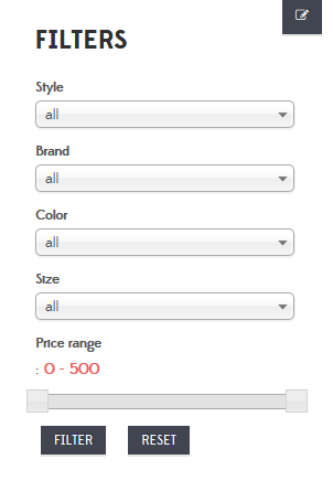

I managed to adjust the filter labels so they work with my template. However, the settings are difficult to understand. I ended up changing them per filter in the display > filters. I had to use the 'left' option in order to get rid of the extra space, but the label is above the selector??
Also, I still need to get rid of or change the ":" in the price filter
Notice the : before the 0 - 500 ?? I need that to either disappear or change to $.

Sorry, but I still can't find where to either delete or change to $ - Please see attached [circled in green]

About the ':' thing, here is the code in the filter class than you can edit:
switch($position){
			case 'top_left':
				$html=$name.': '.$input.$html;
				break;
			case 'top_right':
				$html='<div style="'.$width.' text-align:right">'.$name.': '.$input.''.$html.'</div>';
				break;
			case 'top_center':
				$html='<div style="'.$width.' text-align:center";">'.$name.': '.$input.' '.$html.'</div>';
				break;
			case 'bottom_left':
				$html=$html.$name.': '.$input;
				break;
			case 'bottom_right':
				$html='<div style="'.$width.' text-align:right">'.$html.$name.': '.$input.'</div>';
				break;
			case 'bottom_center':
				$html='<div style="'.$width.' text-align:center";">'.$html.$name.': '.$input.'</div>';
				break;
  • Posts: 14
12 years 6 months ago #144841
OK then. Got the ":" thing all worked out - THANK YOU!
