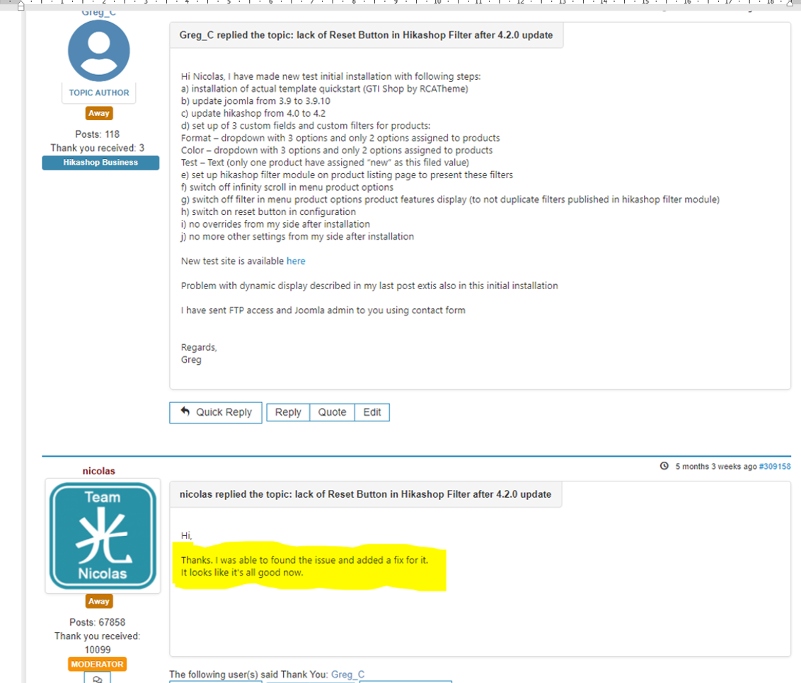

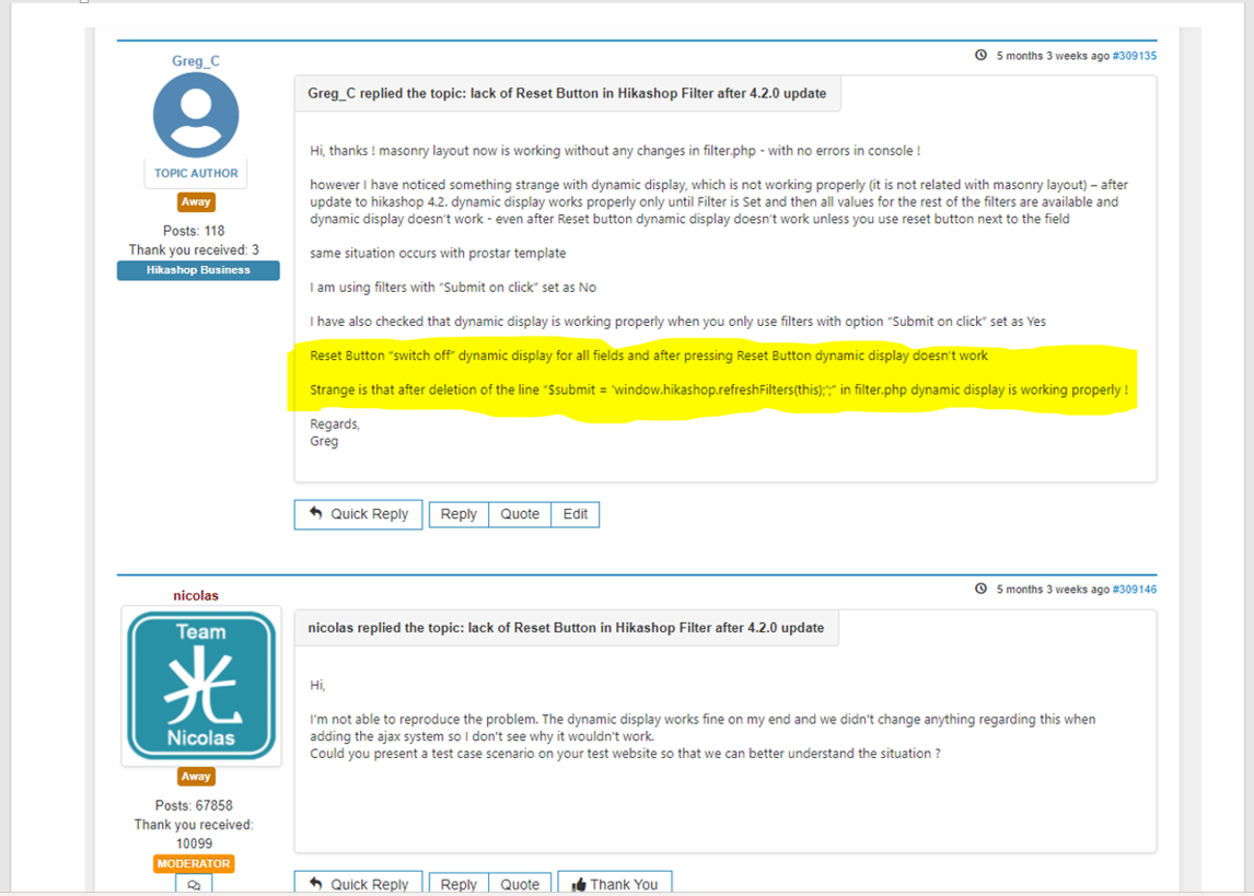

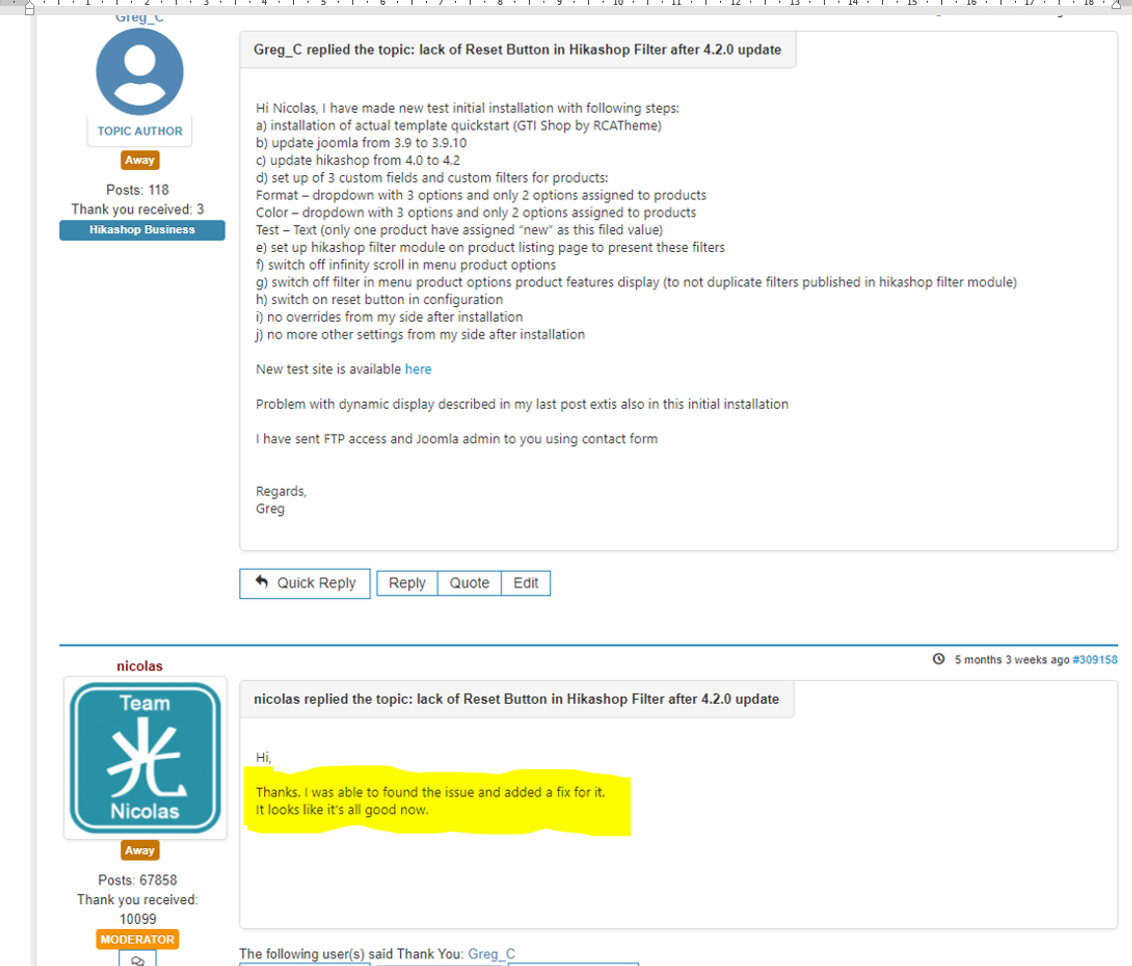

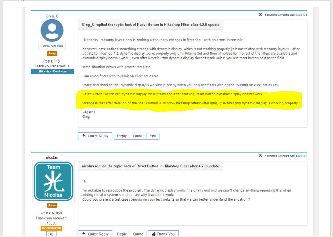

It seems that present situation is similar as it was after Hikashop update to 4.2.0 and it was discussed with you on this: Forum Thread . Then you added a patch that caused this line of code to remain and the reset buttons to work properly. Please find below two screenshots from our discussion in this matter:
as with the upgrade to 4.2.0, the only change from my side was the upgrade from 4.2.1 to 4.2.2 without any other changes, and the reset buttons stopped working properly - I assume that the reason may be the same as it was after 4.2.0 upgrade

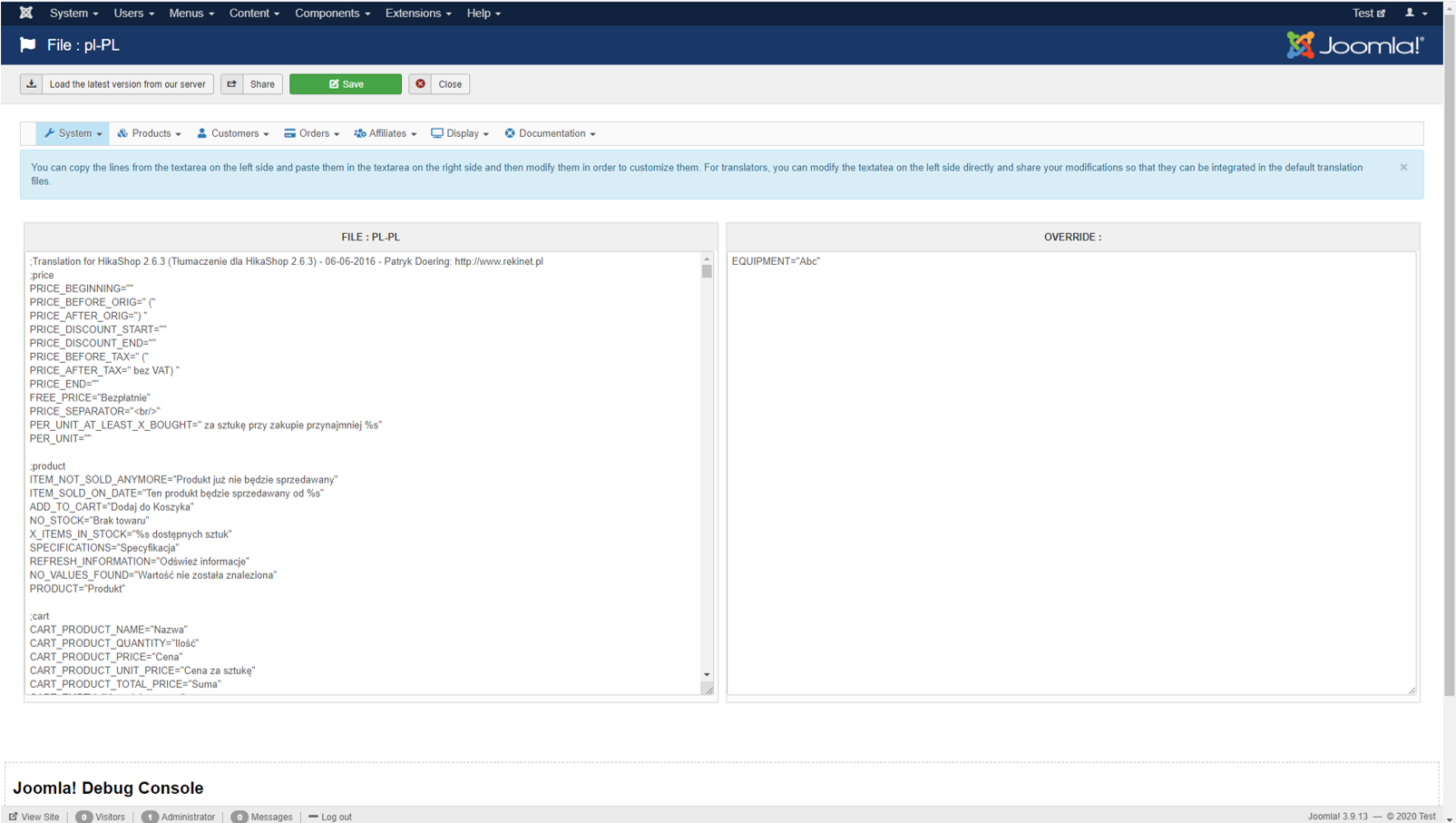

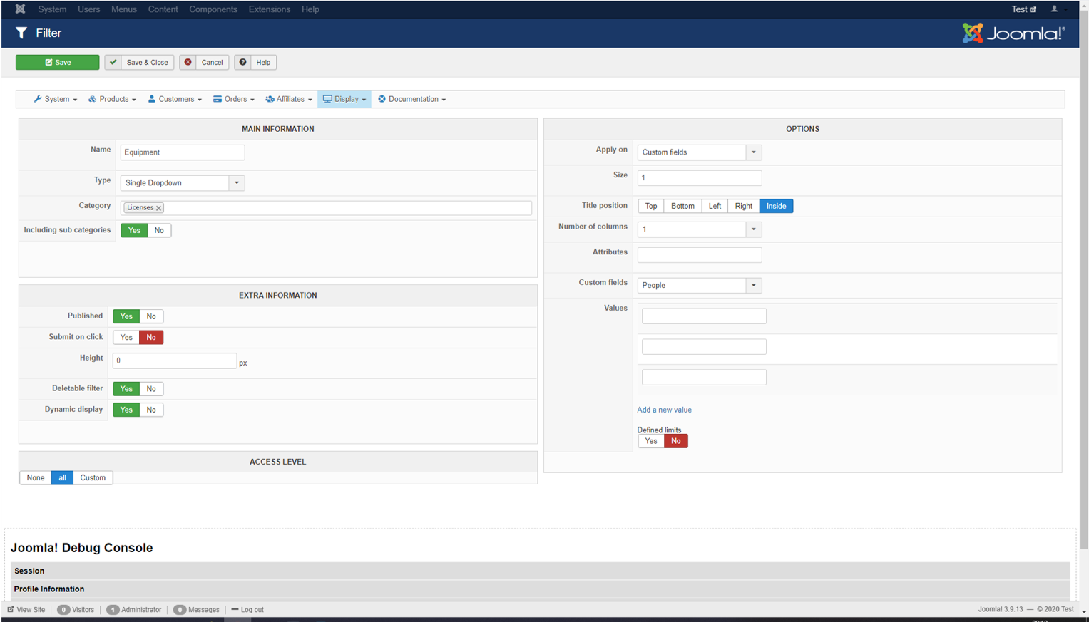

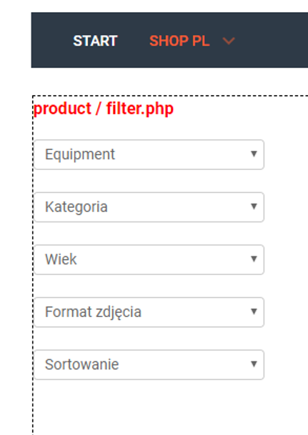

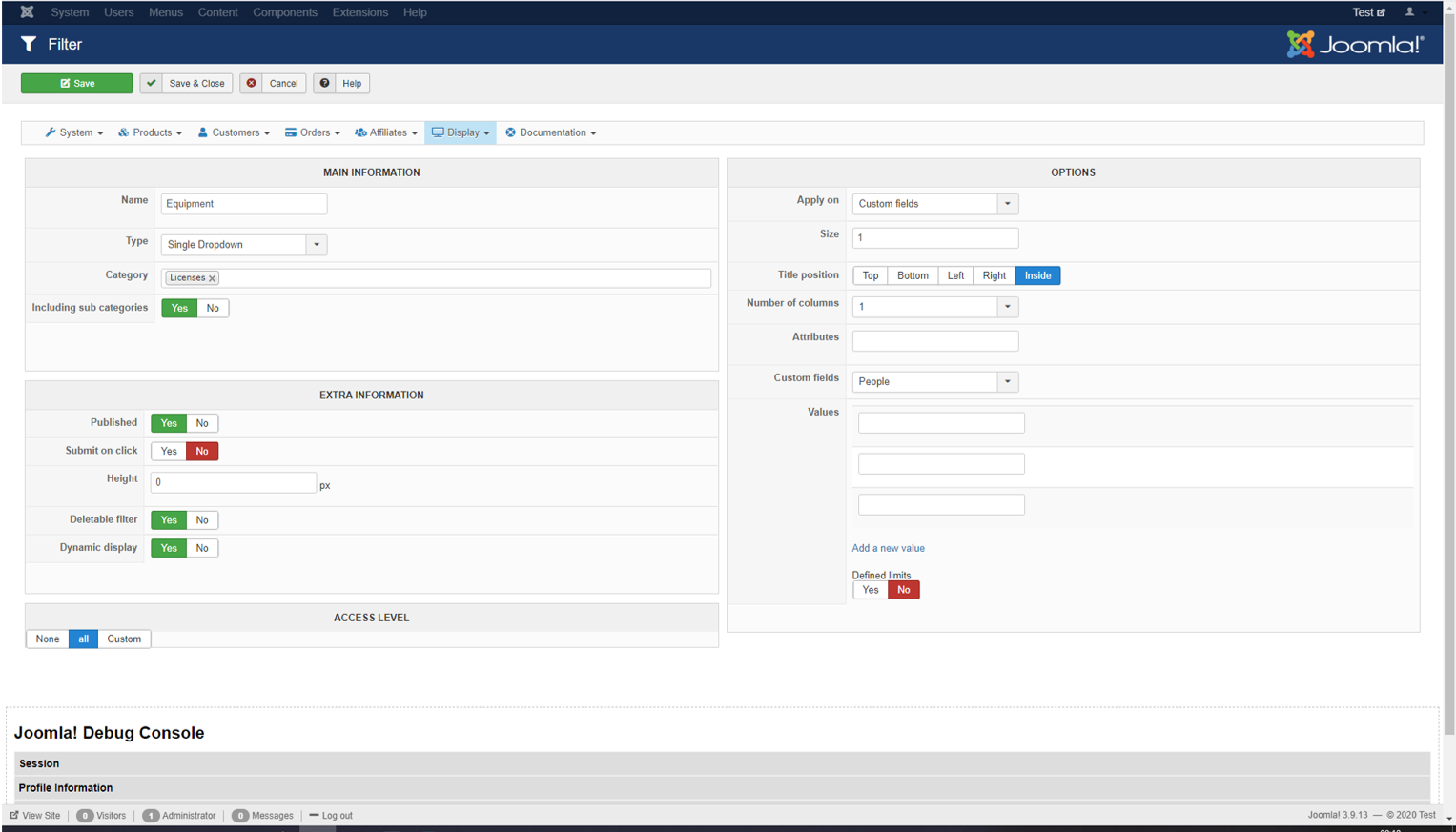

Hi Nicolas, I have created custom filter with name „Equipment” – see image 1.

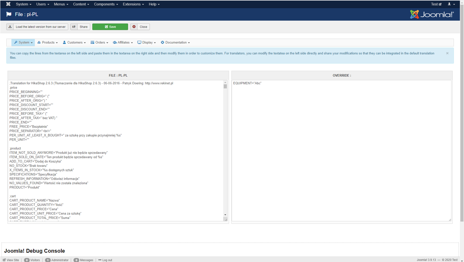

Then in System – Configuration – Languages – Polish – Edit I set in Override screen: EQUIPMENT="Abc" – see image 2.

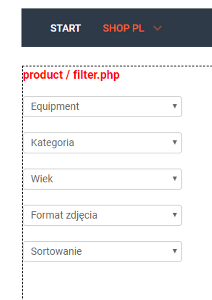

However in Filter module for Polish language is still visible name Equipment instead of Abc – see image 3.
I have sent you admin details via the contact form
Greg
  • Posts: 86180
6 years 7 months ago #315481
Ok, I understand the issue.
That's because the issue only happens for dropdown filters when the title position is "inside".
Change the line:
$html.='<OPTION VALUE="none">'.$filter->filter_name.'</OPTION>';
to:
$html.='<OPTION VALUE="none">'.$this->trans($filter->filter_name).'</OPTION>';
in administrator/components/com_hikashop/classes/filter.php and that will fix the problem.
We'll add that on our end too.
