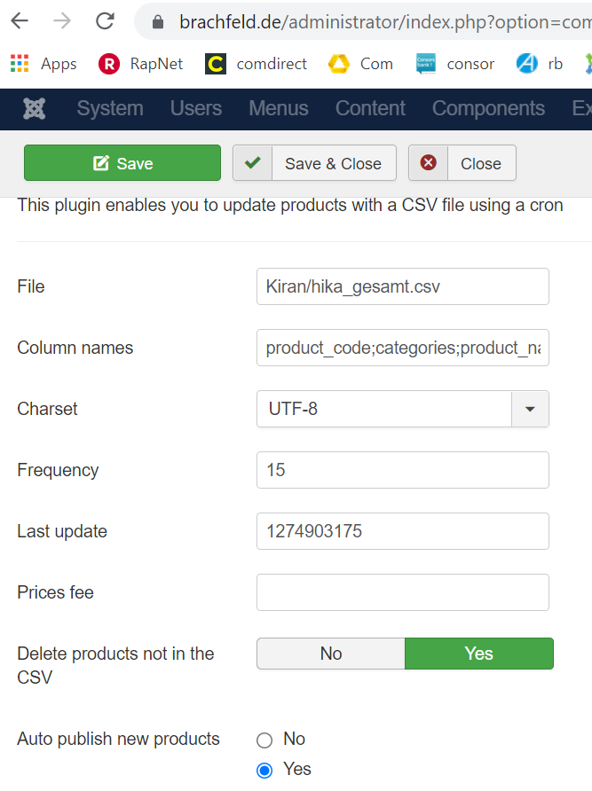

In plugin is adress:
Kiran/hika_gesamt.csv

  • Posts: 25
4 years 9 months ago #336965
  • Posts: 86102
  • Thank you received: 14203
4 years 9 months ago #336968
Can you provide a screenshot of your FTP client when you're looking at the folder where that file is located ?
  • Posts: 25
4 years 9 months ago #337009
It doesn't send this Email any more.
But the plugin doesn't update the products.
The file exist in:
brachfeld.de/Kiran/hika_gesamt.csv
