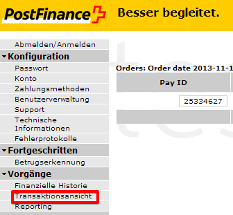

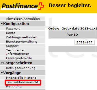

The payment status is 5, it means that the payment is authorized but that you didn't received the money for the moment. What you have to do is to change the status of the transaction to 9 or 91 when the transaction will be done, through your Postfinance configuration screen :
So the Postfinance server will automatically notify your server which will change the status of your order regarding the postfinance notification.

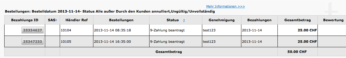

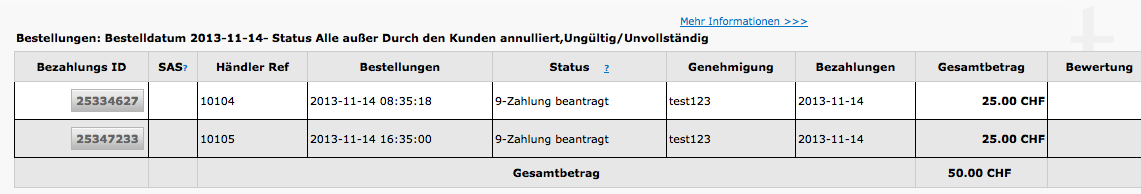

HI,
when I am doing a purchase, everything is working fine. I am getting a status 9 for the transaction.
OK post-sale process with parameters :
orderID=10105&STATUS=9&PAYID=25347233&NCERROR=0&SHASIGN=3673B1A

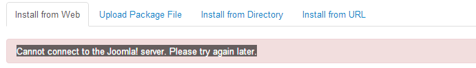

Ok, so can you install the Postfinance version that I gave you so that I can do some tests ? Also, even if I have an Admin acount, I'm facing a "Cannot connect to the Joomla! server. Please try again later." error where I try to access to the extension manager :
Last edit: 12 years 10 months ago by Mohamed Thelji.

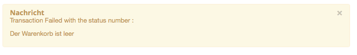

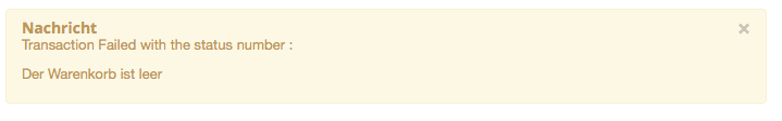

12 years 10 months ago #132497
processing works as before, redirection now too, but with the old "error" shown, see below
