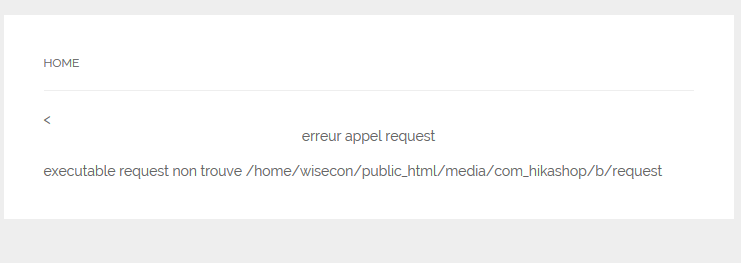

-- Joomla version -- : x2.5.18
-- PHP version -- : 5.3.3-7+squeeze19
-- Error-message(debug-mod must be tuned on) -- :
erreur appel request
executable request non trouve /home/****/public_html/media/com_hikashop/b/request
i keep getting this error, but the file exists... any idea why that happends
-rw-r--r-- 1 wisecon wisecon 0 Mar 6 13:14 /home/****/public_html/media/com_hikashop/b/request
any idea what gives this error and how to fix it ?

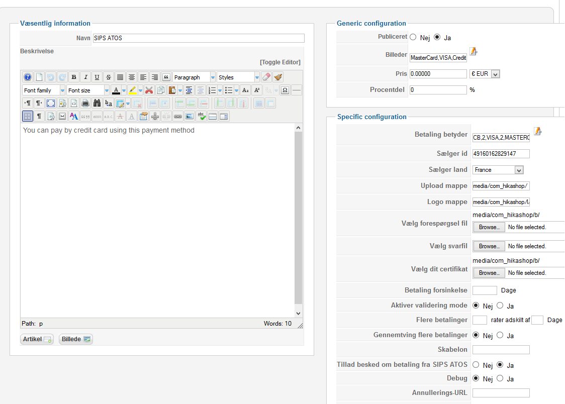

12 years 5 months ago #147073
Here is two screenshots

I have selves been looking into the files... and found this code
	if($os=='win')
		$path_bin = $this->vars["bin_folder"]."request.exe";
	else
		$path_bin = $this->vars["bin_folder"]."request";
	$result=exec($path_bin.' '.$parm);
	$tableau = explode ("!", $result);
$code = $tableau[1];
$error = $tableau[2];
$message = $tableau[3];
if(( $code == "" ) && ( $error == "" ) ) {
	echo "<<br/><center>erreur appel request</center><br/>" .
		"executable request non trouve ".$path_bin;
Now what ever this request file is, it is not included and i have no idea what/where to get to get this working, but as it isn't found the $tableau is empty and the $code and $error is empty and therefor gives that error.
