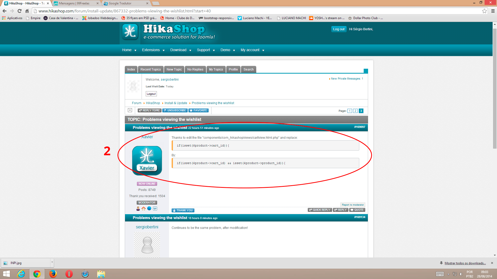

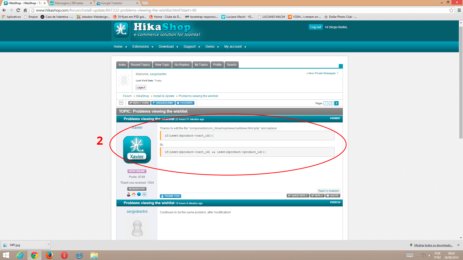

Thanks to edit the file "components/com_hikashop/views/cart/view.html.php" and replace:
if(isset($product->cart_id)){
By:
if(isset($product->cart_id) && isset($product->product_id)){
  • Posts: 128

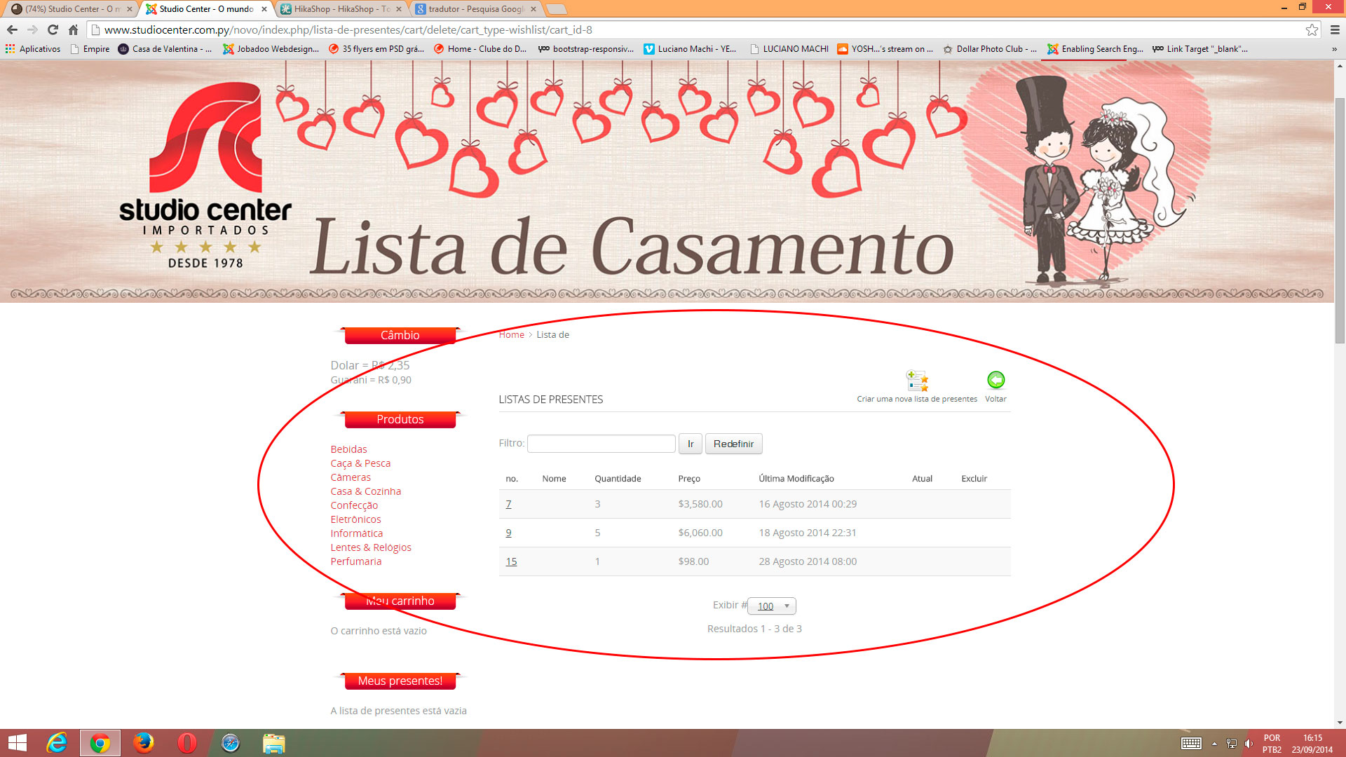

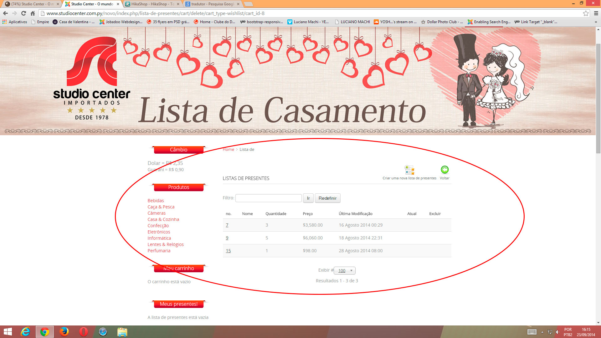

11 years 11 months ago #171215
HI!
Friend!
You will be able to help me?
I'm still having a problem Wishlist!

11 years 11 months ago #172722
Hi!
I keep having the same problem on my wishlist.
Are lists that have been deleted are displayed!
You informed me that would solve the problem until last week. Can you help me !?

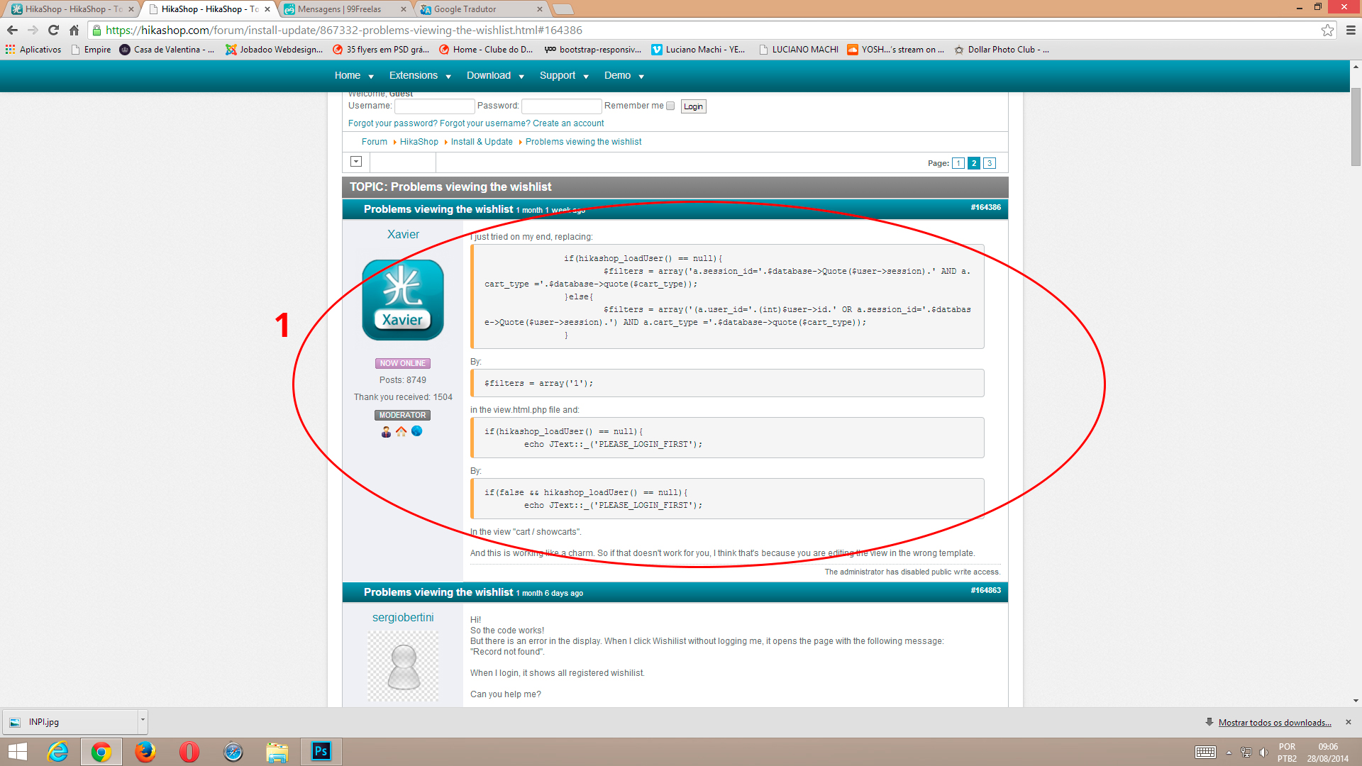

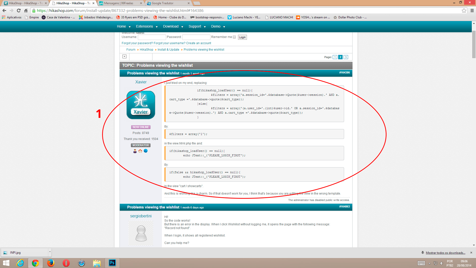

if(hikashop_loadUser() == null){
echo JText::_('PLEASE_LOGIN_FIRST');
By:
if(false && hikashop_loadUser() == null){
In the view "cart / showcarts".
