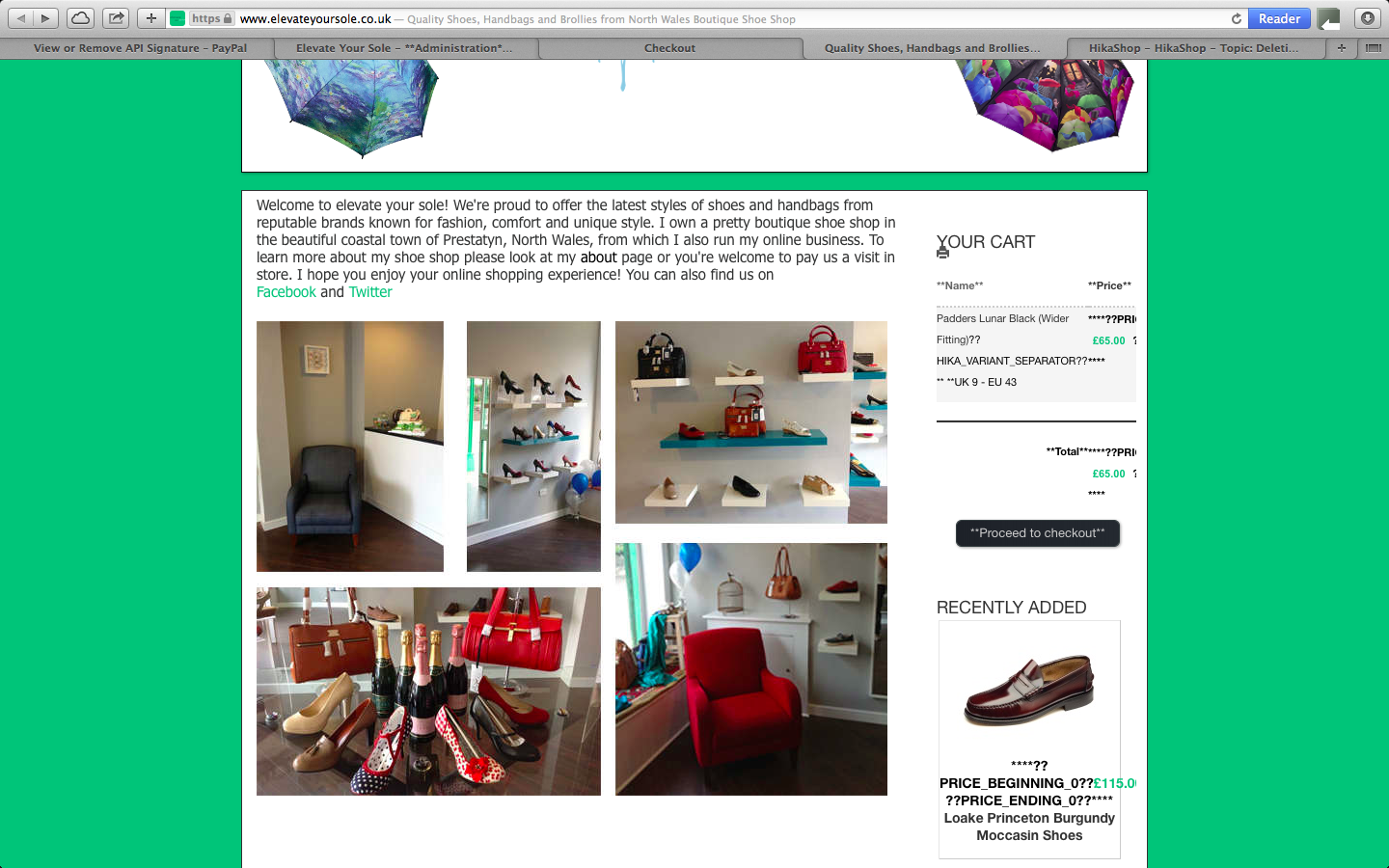

11 years 11 months ago #162817
With the error reporting on, the text pushes the delete icon off the page
Which text ? ;)
  • Posts: 265
11 years 11 months ago #162963
Haha, the text on the screenshot.
Hika_Variant_separator??
11 years 11 months ago #162968
Oh, ok, that's because you have enabled the Language debug, thanks to disable it ,and enable only the other one.
