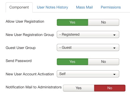

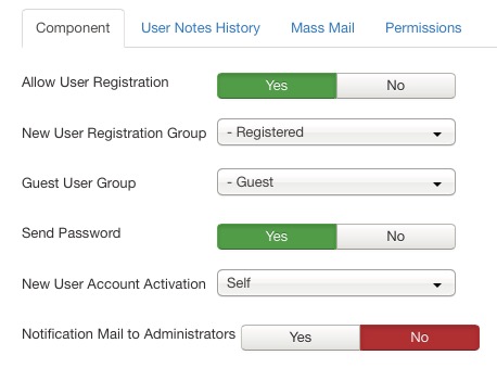

11 years 3 months ago #201323
I found it....finally. Thank you for your help on this.
The weird thing is Joomla is set to enable user registration and I am still getting the 403 error. A screenshot of the settings is attached (because I know it is beyond belief).
  • Posts: 112
11 years 3 months ago #201328
So, to avoid any confusion, Joomla is set to allow users to register. But, I am getting the 403 error when I try to use the registration process. Any suggestion other than the Joomla "Allow User To Register" function?

11 years 3 months ago #201480
I didn't have any 403 page but the test account I made is not able to login ; I got the message "You can't access the private section of this site." which is a message related to Joomla.
Having more details about the Joomla account in your side will be useful. Because it's look like there is something misconfigured in your site which block the login.
