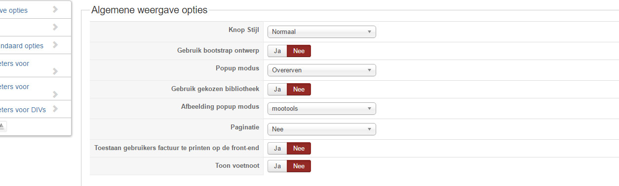

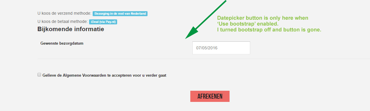

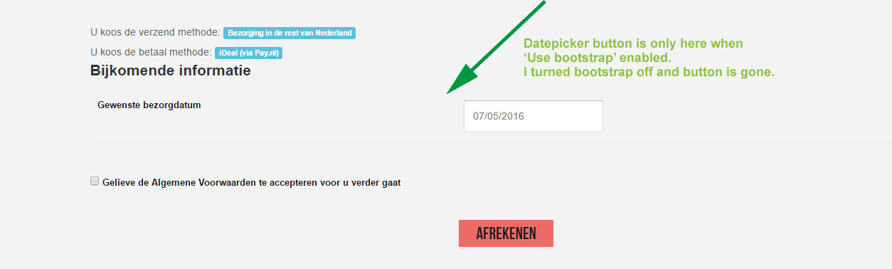

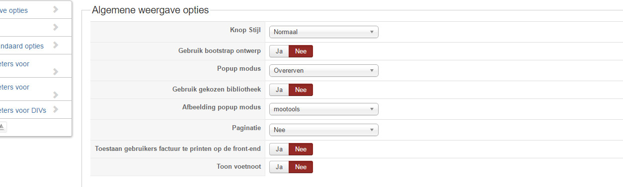

When making a custom field (advanced datepicker) it shows correct in the backend, with an icon next to it for displaying the calendar
In frontend however it only shows when bootstrap enabled in the default display options. Is it possible to get the icon (and functionality with it) without bootstrap enabled?
Turning on bootstrap will mess up my design (product display) big time.
Thanx a lot for your suggestions.

  • Posts: 6
10 years 3 months ago #239443
screenshots...
  • Posts: 6
10 years 3 months ago #239449
Ok, in the plugin i copied the responsive part in the non-responsive part.
Is working now!

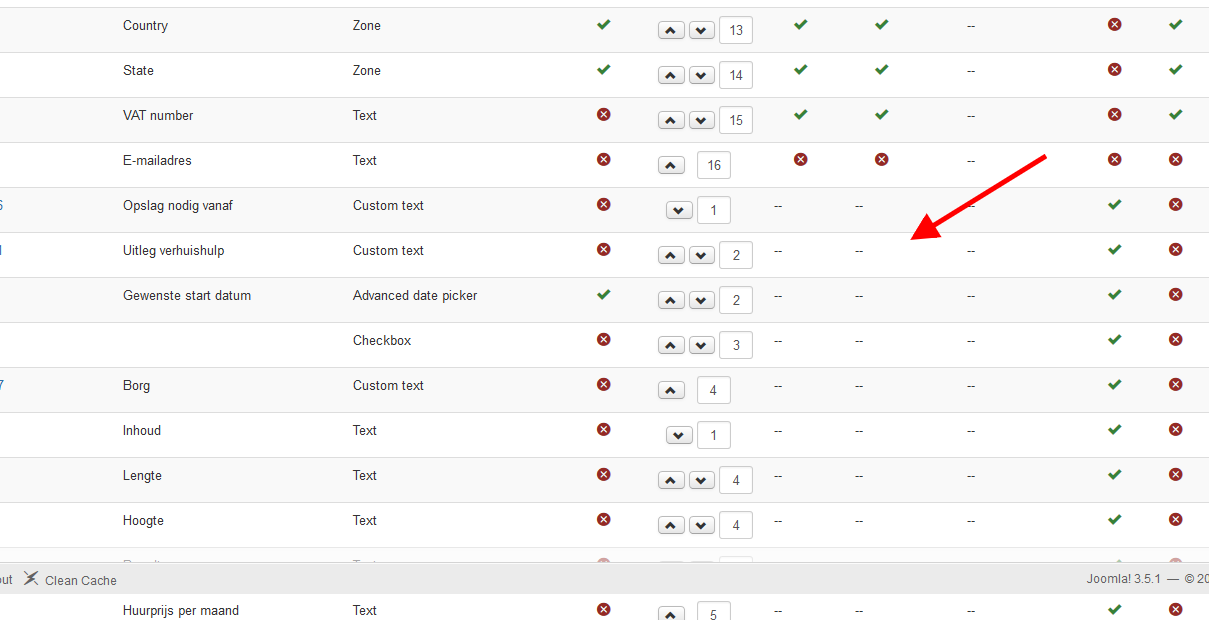

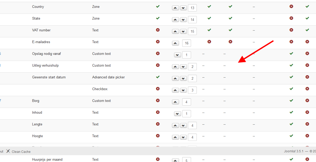

10 years 3 months ago #241485
i am sorry but that doesn't help, but after updating to the newest version of hikashop the 2.6.3 we get to see something not right in the backend of the custom fields. see picture. please help.
  • Posts: 86083
  • Thank you received: 14194
10 years 3 months ago #241506
That's normal actually. We've added new display options for some types of custom fields. And thus the options of the listing are not adapted anymore. Edit these custom fields and look at the display options and you'll understand.
