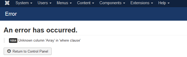

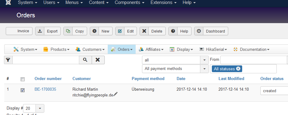

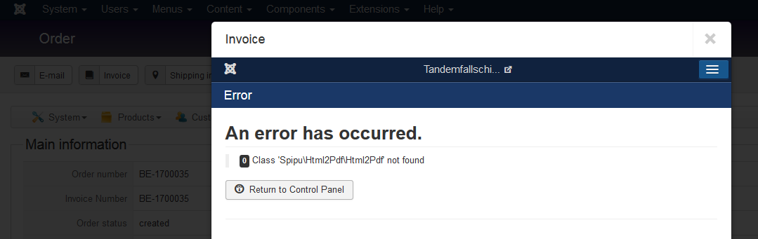

8 years 8 months ago #284477
after installing the new attachinvoice plugin I get these errors:
- klicking on Invoice in the order overview:
- klicking on Invoice in the order detail view:

8 years 8 months ago #284478
1. Well, first the system in HikaSerial cannot be use "as is" because we're not dealing with the same data. Moreover, the system there doesn't support the display of lists of data (like a listing of the products in the order, which is mandatory in an invoice).
And finally, the system in HikaSerial cannot be used in a plugin configuration page. It would require making a component for that.
So even if we were to use the system in HikaSerial and added to it in some way the support of lists of data (which would basically mean a whole make over of the interface), it would still require a complete rewrite of the PDF invoice plugin.
It would actually be a bit easier to start from scratch than using what's in HikaSerial I think.
2. That's strange as it works fine on my end. I've added some patch to it and uploaded a new package. Please try with it.
