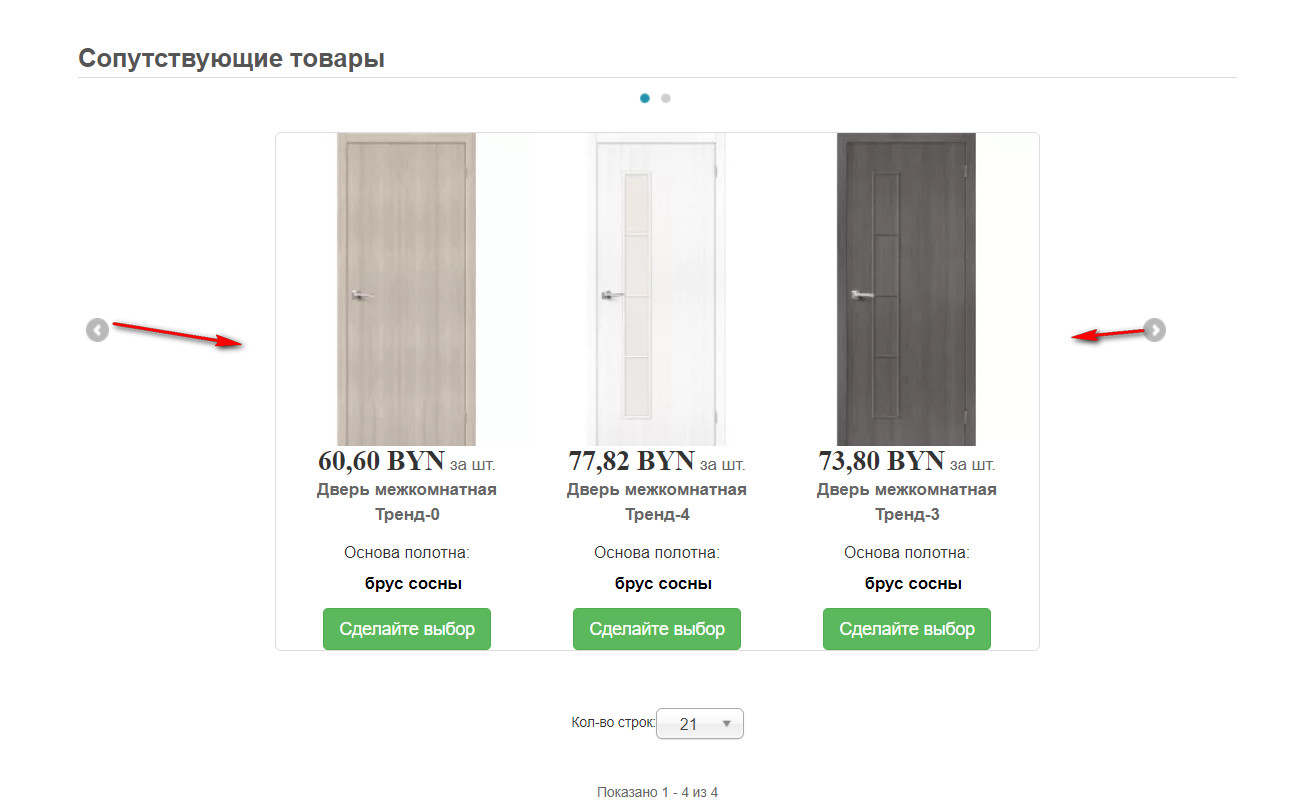

Missing arrows in the slider.

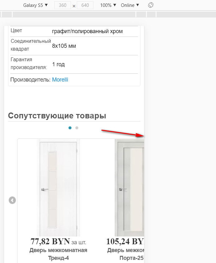

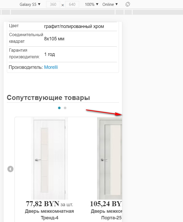

Hello. Thanks I adding the code. All the same, the mobile version is not displayed correctly.

"the mobile version is not displayed correctly."
Can you details what do you mean by "not displayed correctly", use precise description, annotated screenshot etc etc...
"How do I move the slide switches closer to the products?"
A little like my previous answer, use the "left" and "right" command but change value in order to match you needs.

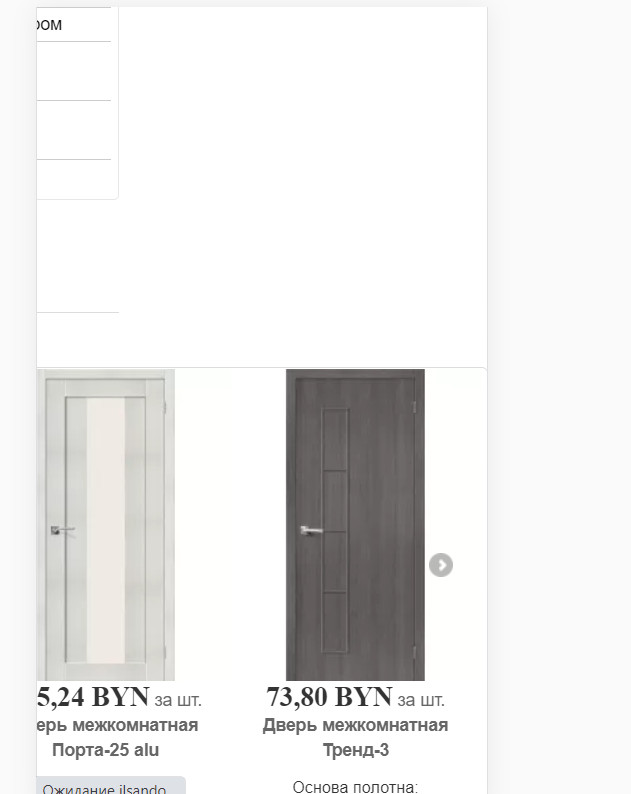

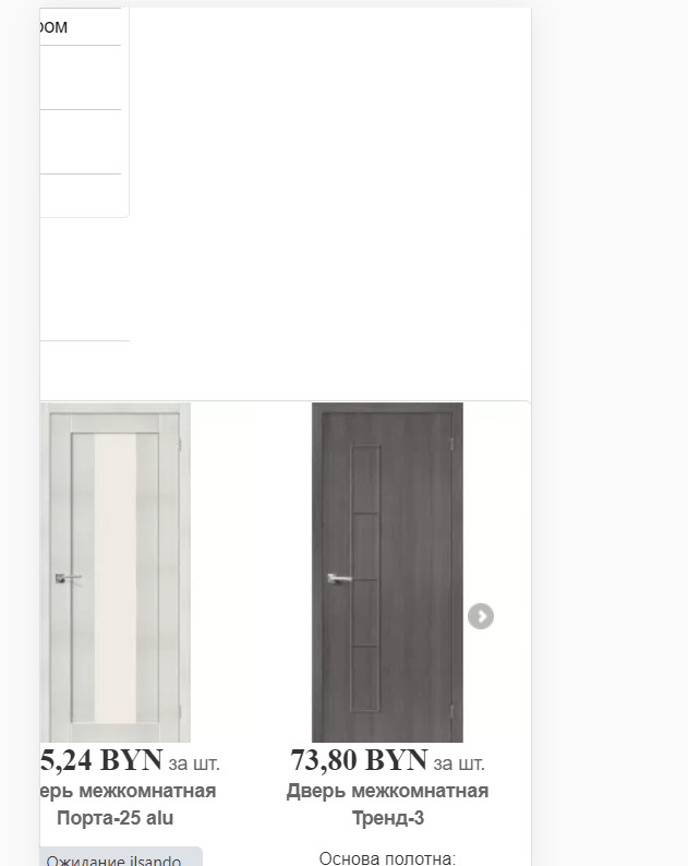

5 years 11 months ago #322352
Hello.
Check it from your mobile, this page:
ilsandoors.by/katalog/product/dvernye-ru...-matkhrom-belyj.html
5 years 11 months ago #322358
After analyze of your configuration this result is normal as you use the old carousel, see it here :
1. From Main HikaShop Configuration => Advanced tab
2. Go to Legacy settings part
3. Carousel legacy set to "Yes"
Does there is a reason to have kept the old version of your carousel, that isn't responsive, and that leads to this result.
To solve this issue, you have to use the new carousel and not the legacy one.
Last edit: 5 years 11 months ago by Philip.

5 years 11 months ago #322377
Hello. The fact is that there are no arrows in the new one, not every user understands that it is possible to switch slides in the mobile version.
Last edit: 5 years 11 months ago by ilyaminsk.

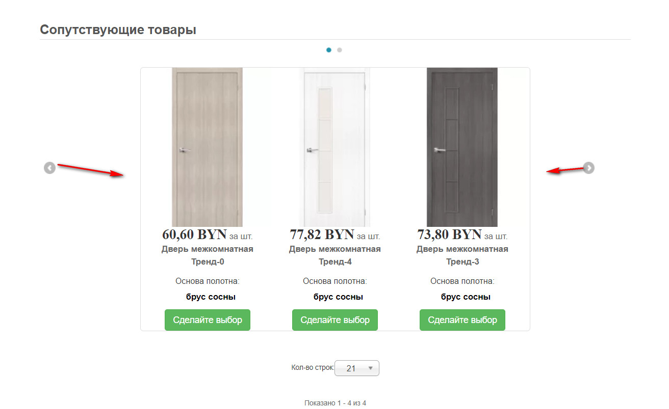

5 years 11 months ago #322393
You have switch button that you can custom if needed, see my screenshot :
From backend, you have this option to activate to have switch buttons :
Frontend result :
Hope this will fit your needs.
