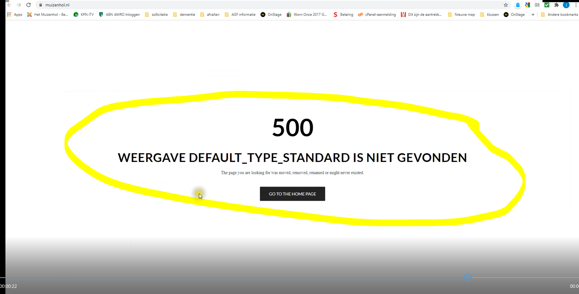

Error message, site does not work after installation of Hikashop business
  • Posts: 32
5 years 7 months ago #328039

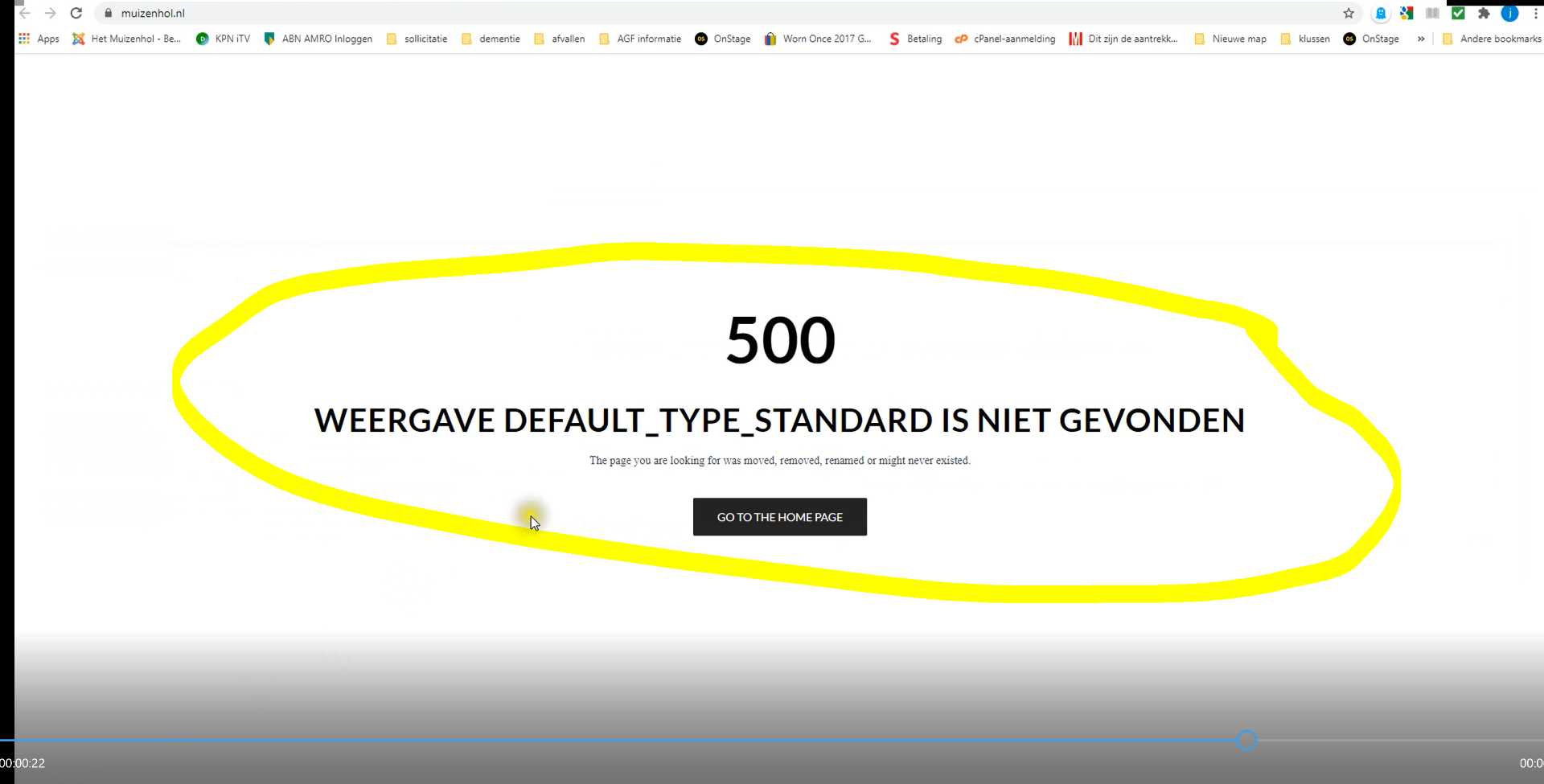

-- Joomla version -- : 3.9.23
-- PHP version -- : 7.4.13
-- Browser(s) name and version -- : Chrome 87.0.4280.8
-- Error-message(debug-mod must be tuned on) -- : LAYOUT DEFAULT_TYPE_STANDARD NOT FOUND

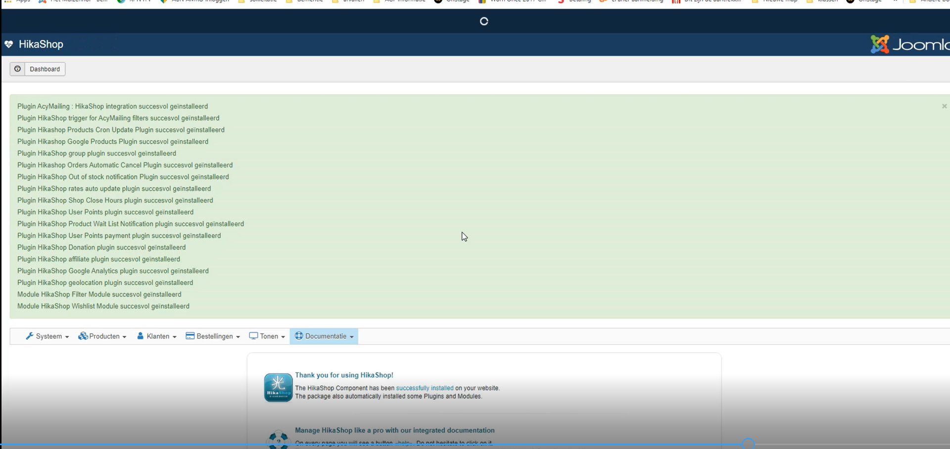

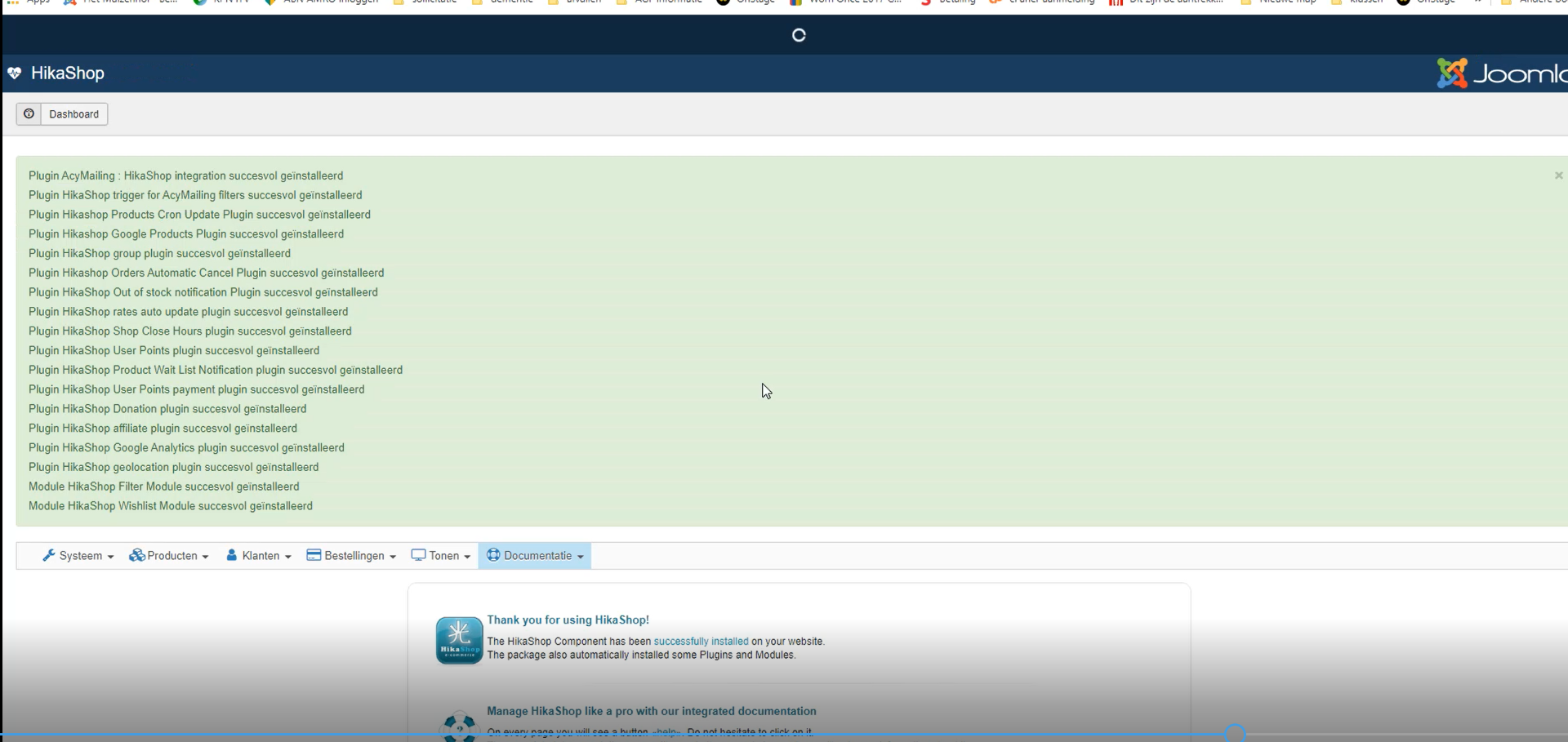

I have upgraded the Hikashop starter verion which was up to date to the business version. I dragged the zip file to the installation upload box.
After the installation I get a message that all files are installed properly. When look at the preview of the site sometimes it works, but wehn I refresh I get this error message.
A restore from a previous backup with Akeeba does not work. The only thing that works is clear the entire public directory and copy file I backed up on my computer to the server.
I have tested on a local server, with the same result.
What goes wrong.
I have had two files. One with a zip extension and one with a gz extension. Result is the same.
I also send s support request, but did not get a reply that the mail was sent.
Jos

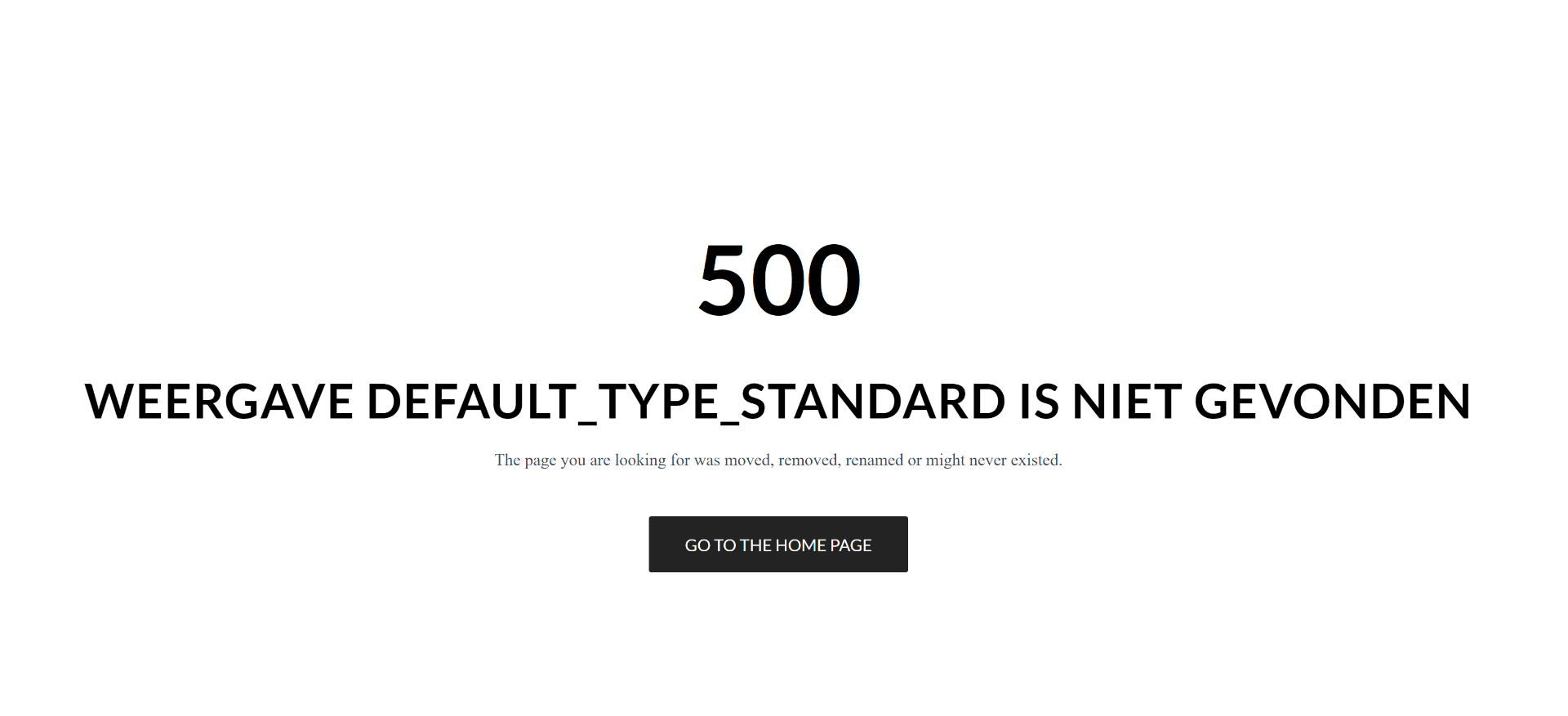

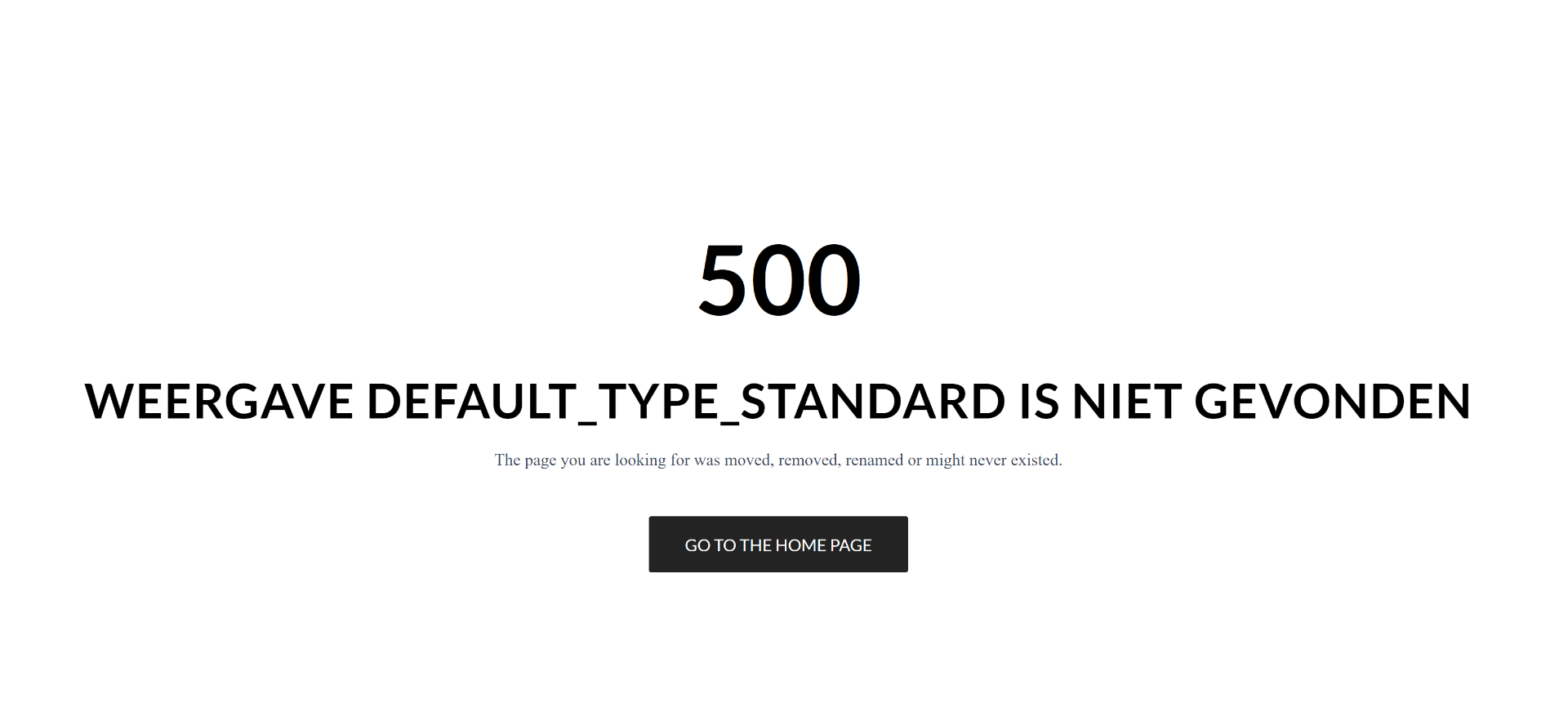

I checked your website and I don't get that error message.
Instead I get that error:
"500
WEERGAVE FILTER IS NIET GEVONDEN
The page you are looking for was moved, removed, renamed or might never existed."
monosnap.com/file/SZKRT0pwH7VkVp4qLIlV0ivccj2e6G
So this indicates that there is a fatal error on the page.
It's likely linked to a view override you have on your website but it will be hard to say without more information.

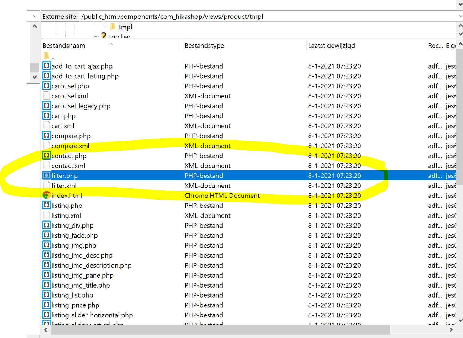

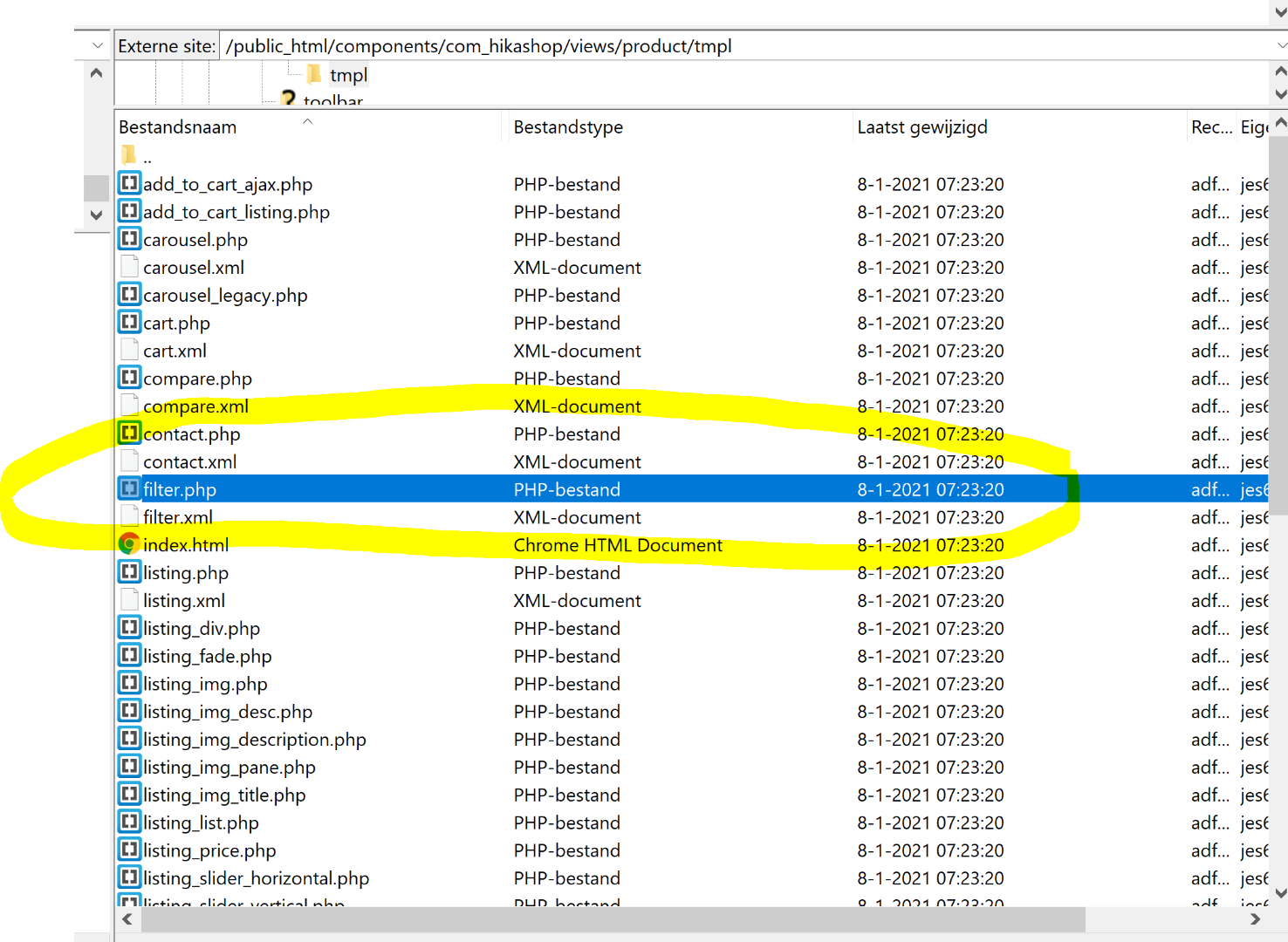

This would seem to indicate that the file components/com_hikashop/views/product/tmpl/filter.php is missing on your website for some reason.
That file is only available with the Business edition.
So what's likely is that the Joomla installer was not able to add some view files from the HikaShop Business install package because of permission issues on some of the folders.
So here is what you can try:
- rename the folders administrator/components/com_hikashop and components/com_hikashop to something else via FTP so that Joomla can't find any files of HikaShop.
- install the HikaShop Business install package again. That will force Joomla to recreate all the folders of HikaShop with the correct permissions and allow it to put back all the files.
After that you should not have that error anymore.

5 years 7 months ago #328078
I was to optimistic. Problem is that when you stay in your browser it seems to work. This is also why I installed it on the live server after testing it local. It seemed to work. Even when you close the chrome browser and open it again it works. As it there are files in cache. But i emptied the cache, that did not have an impact.
When you close the computer and open chrome same problem again, same error message. As you can see from the screenshot, the filter.php file is under the directory. I do see an error message "port closed before respons"Do not know what this means"
Since it does not make any difference if I test this on a server or local, I do get the same problems, I uploaded a version to the server that does work with the starter version of Hikashop. Further testing I will do local
Let me know what more info you need.

The error I had before was about the "filter" view.
This error "LAYOUT DEFAULT_TYPE_STANDARD NOT FOUND" I see now is not the same error and it doesn't concern the filter view anymore.
I actually don't know what that error means or even if it comes from HikaShop.

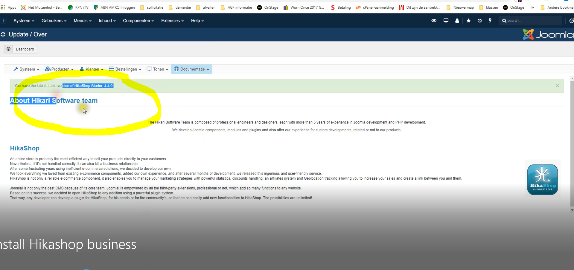

I started with Hikashop starter to see how it works. Everything was working great. Than I decided that I wanted to upgrade to Hikashop business, so I bought that. Tested on a local host, exact copy of the life site. Seemed to work. The minute I upgraded the life site with Hikashop business I got the error 500 message. Running on a local host it seems that when you keep the computer running it works. When you restart you also get the error message.
The live site is running with Hikashop starter, I do not want to keep it with the error message to long offline. The minute I upgrade to Hikashop business I get the errror message. I tried this morning again. This morning I used a backup of the present configuration on a local host. So that was a 100% copy of the live site. Installed Hikashop business and when I tried to ook at the frontend I got the error message. Do you have a local host where you can try. You can use a backup from Akeeba. let me know if this works for you.

1st shows the website working with Hikastarter. Then I install Hikabusiness. Seems to work. Any other computer that tries to look at the site immediately sees the error message 500. With the computer I made the changes you have to reboot the computer. Sometimes this is not neccesary ( tested on localhost) when you wait long enough.
Second movie shows site with hikabusiness, but with error message. I restored the site to the working version with Hikastarter running a backup. I do waant it operational, not showing an error screen.
Summary, I have a working site with Hikastarter. The minute I install HikaBusiness I get the error 500 screen. You can see all steps and the working of the site in the video I shared
Feel free to ask.
Last edit: 5 years 7 months ago by jes060.

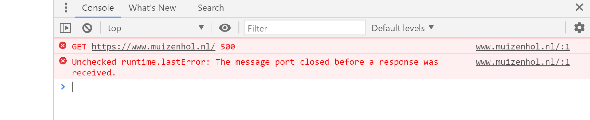

Can you process this different tests in order to provide us more element to better understand what's going on.
1. Active Joomla Debug mode, in development level, and reproduce your error page.
=> You may have more data that can leads us to better understand the issue
2. Can you process some test with a default template like ProtoStar, does this change something about your error ?
3. Try to disable HikaShop via the Extensions->Mange->Manage menu of Joomla. If you still have the error after that, then it's not linked to the install of HikaShop.
Be more specific as possible about these different points and your returns, please.
