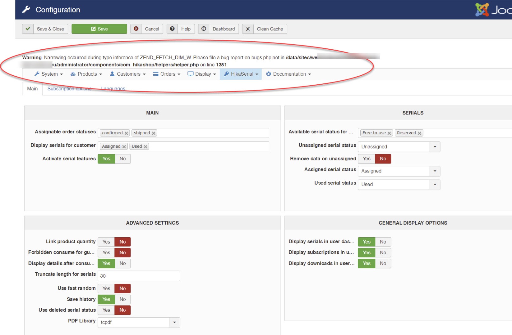

  • Posts: 637
  • Thank you received: 26
4 years 5 months ago #340416
It looks like this error stil exist! But only in combination with HikaSerial installed!!!!
We have installed again the latest 4.5 version today in combination with PHP 8.
But on the back-and we get this error:
Warning: Narrowing occurred during type inference of ZEND_FETCH_DIM_W. Please file a bug report on bugs.php.net in /data/sites/web/domainnl/subsites/domain.eu/administrator/components/com_hikashop/helpers/helper.php on line 1381
Switching back to PHP 7.4 fixes this issue so it's indeed related to PHP 8.
And in the check-out we get this error with PHP 8 and not with PHP 7.4:

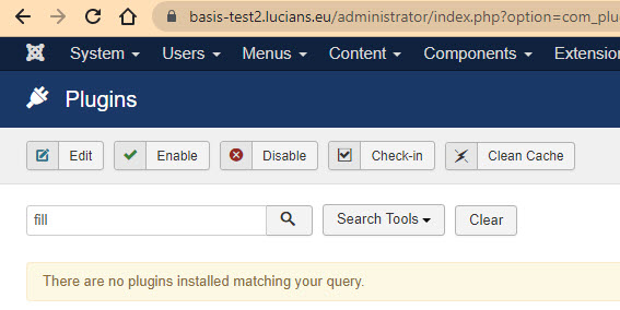

1. So do you mean that if you go on PHP8, you get the error, but then if you disable hikaserial while staying on PHP8, you don't have the error ? That would indeed confirm that it's linked to a problem with PHP8 and HikaSerial.
2. Thank you for the report on the warning with the Auto Fill plugin. I've made a patch in the plugin for this. Download again the install package of the plugin on our website and install it on yours to get it fixed.

We did not have installed the HikaShop Address Auto fill plugin on this site.
But I downloaded en installed the latest version of Hikashop again and now the issue is solved.
And all errors/warnings etc. are gone!
So thankyou!

  • Posts: 637
4 years 4 months ago #340630
Now we get this error on an other website when we update to Hikashop 4.5 without HikaSerial.
So maybe it has nothing to do with Hikaserial.
And after refreshing the warning is gone!
Warning: Narrowing occurred during type inference of ZEND_FETCH_DIM_W. Please file a bug report on bugs.php.net in /data/sites/web/domainnam/subsites/domainname/administrator/components/com_hikashop/helpers/helper.php on line 1381
