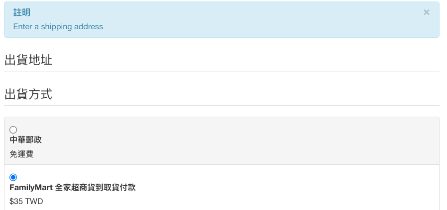

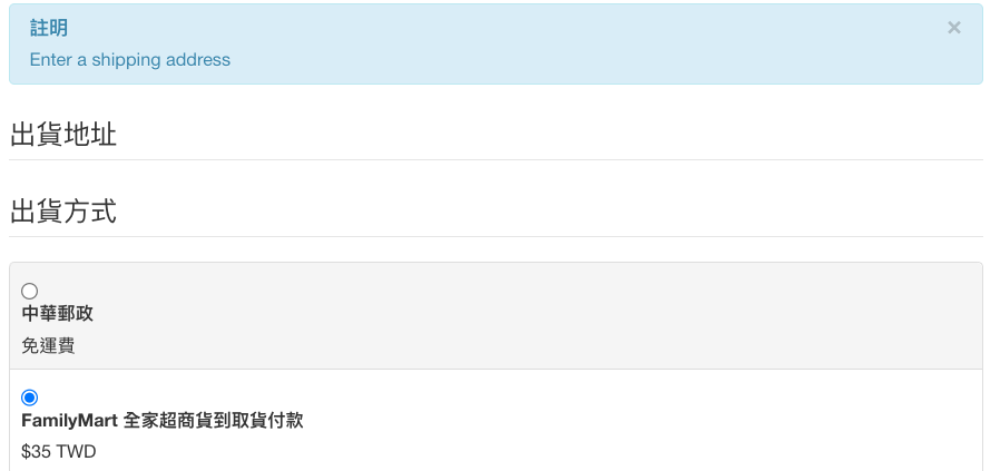

  • Posts: 220
2 years 11 months ago #354271
Hello Nicolas,
It's not fixed yet, it keep asking "註明 Enter a shipping address" and not allowed to click into the final billig page. Please help. Thanks
  • Posts: 85863
  • Thank you received: 14113
2 years 11 months ago #354273
It is fixed. What you're describing is a new issue. Thanks for your feedback. I've made a patch for this new issue I hadn't thought about.
Please download again the install package on our website and install it on yours to get this new patch too.

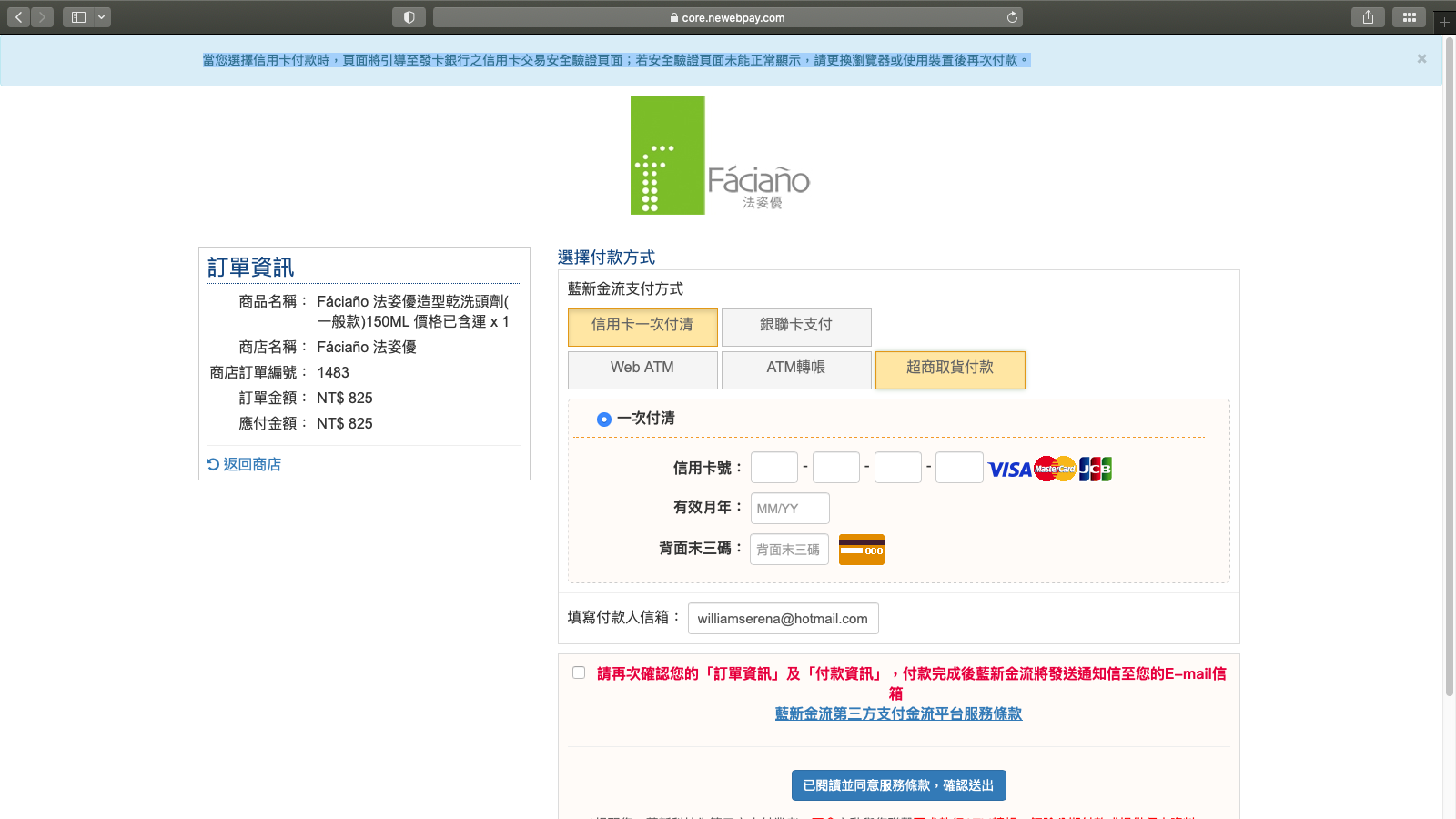

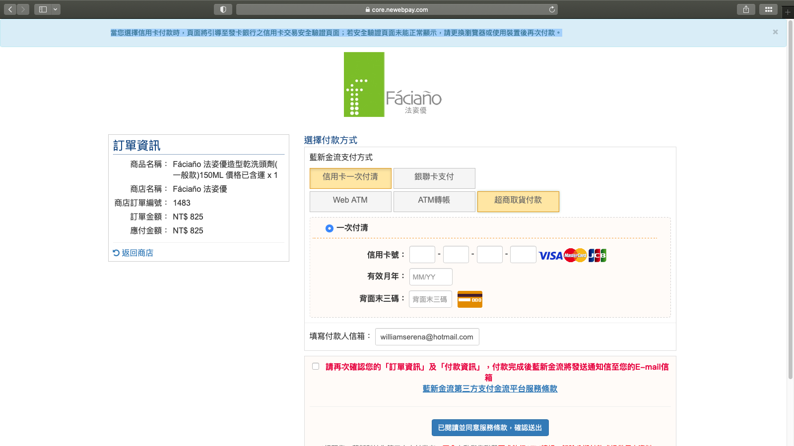

2 years 11 months ago #354305
Hello Nicolas,
When choosing FamilyMart to the final page, the payment method can't be converted to the correct one. it shows "當您選擇信用卡付款時,頁面將引導至發卡銀行之信用卡交易安全驗證頁面;若安全驗證頁面未能正常顯示,請更換瀏覽器或使用裝置後再次付款。" (When you choose to pay by credit card, the page will be directed to the credit card transaction security verification page of the issuing bank; if the security verification page cannot be displayed normally, please change the browser or use the device and pay again.)
and should be the last method " 超商取貨付款"
When customer chooses credit card with 中華郵政, the other shipping method, it goes to " 超商取貨付款" on the contrary, should be the first one "信用卡付款"
Please test at my website to make sure it's being really fixed and upload package correctly. Thank you.

  • Posts: 85863
2 years 11 months ago #354312
I don't think there is anything we can do about this new issue you're talking about.
From what you're saying I think that this is what is happening:
You're using a payment plugin for the newebpay payment gateway. I suppose you're using the plugin available for HikaShop and developed by Newebpay themselves, and available on this page :
www.newebpay.com/website/Page/content/download_api#2
So I took the liberty of downloading the plugin and having a look at its code.
There, I found this line:
'shipping_address' => $this->_getAddress(isset($order_info->cart->shipping_address) ? $order_info->cart->shipping_address : $order_info->shipping_address),
That's the line which provides the shipping address of the order to the payment gateway.
I suppose that because the order doesn't have a shipping address when using the shipping address override, the payment gateway switch to 3DS mode where credit card verification is mandatory to ensure it is a legit transaction.
Changing this line to :
'shipping_address' => $this->_getAddress(isset($order_info->cart->shipping_address) ? $order_info->cart->shipping_address : $order_info->billing_address),
in the code of the plugin in order to provide the billing address when the shipping address of the order is not available will probably make it work like you want.
A better solution would be to add an extra check so that when the shipping address is missing in the order, and if the shipping address override is activated for the shipping method selected for the order, it would switch to the billing address. But if the override is not activated and the shipping address is missing, it would keep not providing an address so that the payment gateway doesn't need to switch to 3DS when the shipping address is overridden.
I think that's a feedback which needs to be brought up to the tech support of your payment gateway.

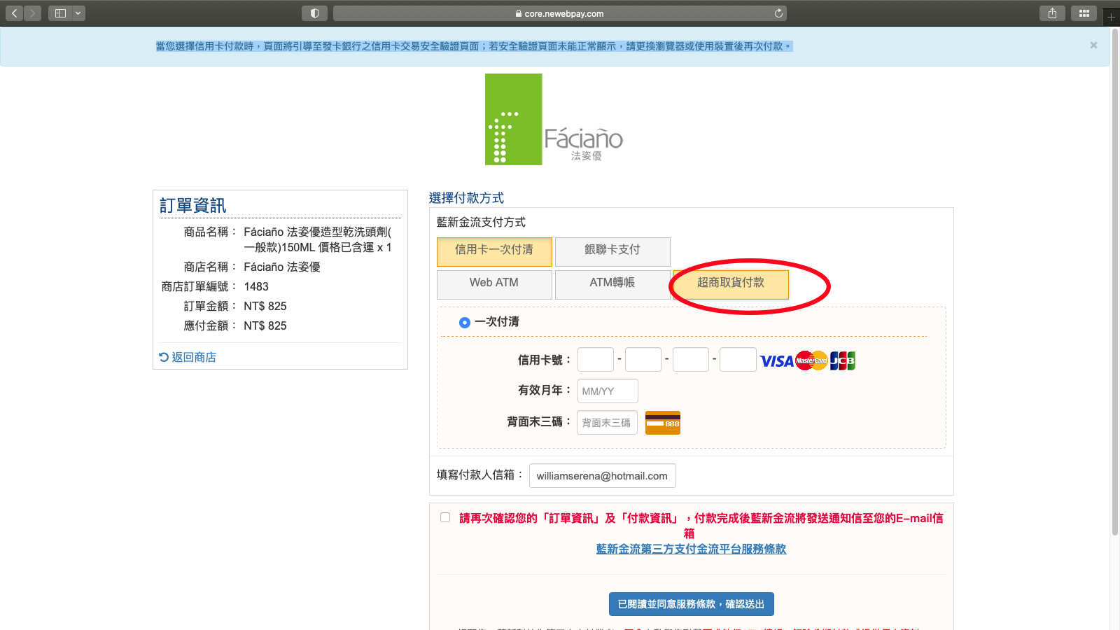

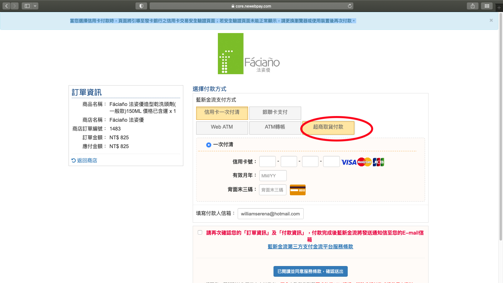

  • Posts: 220
2 years 10 months ago #354748
Hi Nicholas,
Nothing you need to know the credit card policy of "FamilyMart" because it means " customers don't pay online, they pay at the store". So no credit card paymet at all. You only need to redirect to the correct icon of red circle I put in the photo--"超商取貨付款". If you are willing to help that would be so great. Thank you very much. Very hard to find someone to fix up.
Attachments are the software of payment company and picture I indicated.
  • Posts: 85863
2 years 10 months ago #354756
Ok, but I don't know how to do that.
We need to be able to understand the context, and also base ourselves on documentation. I don't have either of these. I don't know how to redirect to the correct icon. And I can't read the documentation.
Any skilled PHP developer speaking Taiwanese should be able to work on that for you.
