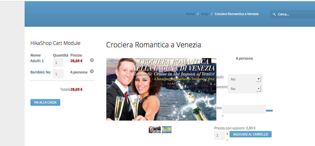

I've bought the dynamic datepicker that seem to do a grat job for my purpouse ( selling tickets for specific days), but it causes problems:
1) doesn't respect the compulsory field ( leave it empty to try);
2) It doesn't show up in Cart as custom value;

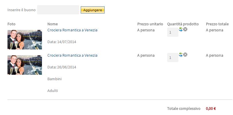

3) It doesn't allow the selected product with variants to show up as single product with selected variants but as "single variants as products" ( see picture)

I made a fast test and I don't think the problem is coming from the datepicker custom field.
When you add the product "Crociera Romantica a Venezia", the product itself is not added in the cart but two other products are added : "Adulti" and "Bambini".
These products are added in the cart but they don't have the datepicker custom field attached. The custom field is attached to the product "Crociera Romantica a Venezia" which is finally not added into your cart.
That's why you can't see the custom field but it is not related to the "datepicker" but it will be the same using another kind of custom field.
I will recommend you to group the options to the main product in your HikaShop configuration and let the main product to be added in your cart.
At this moment it will be easier for the customer to understand the products in the cart and it will display the "item custom fields".

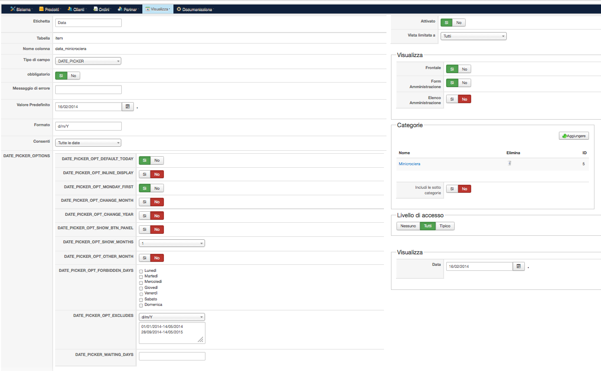

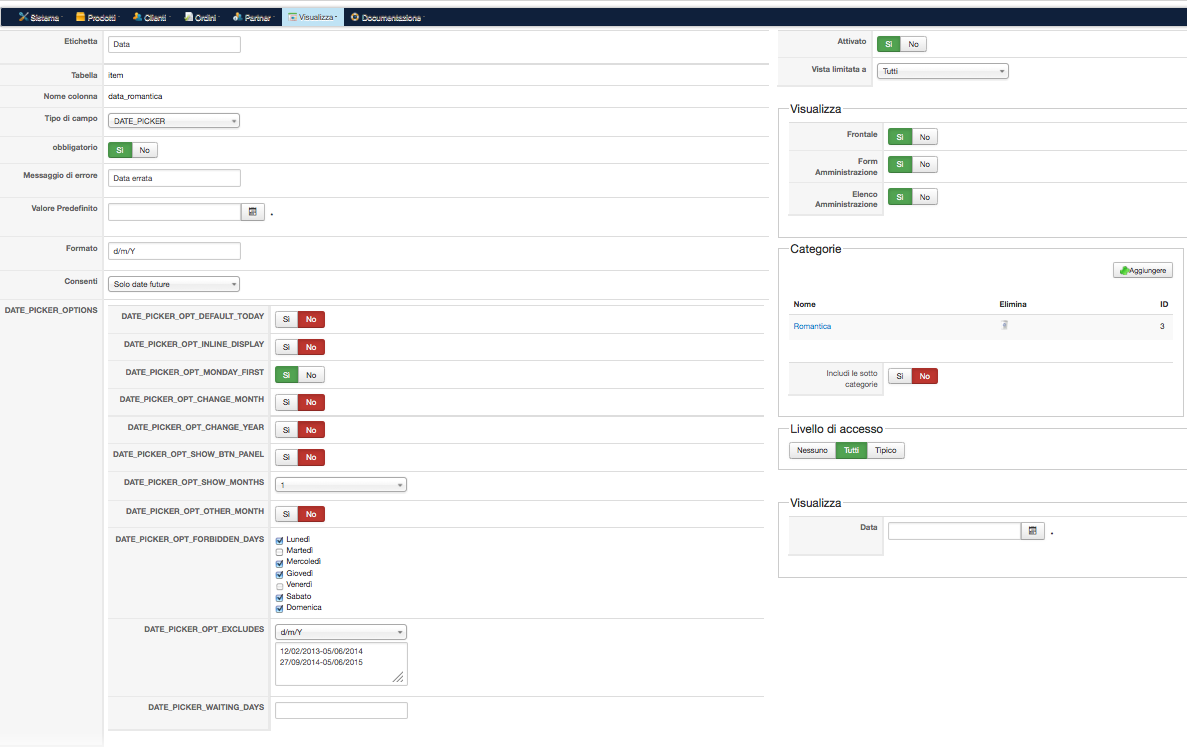

  • Posts: 27
12 years 6 months ago #144253
Thanks for reply.

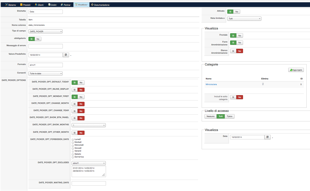

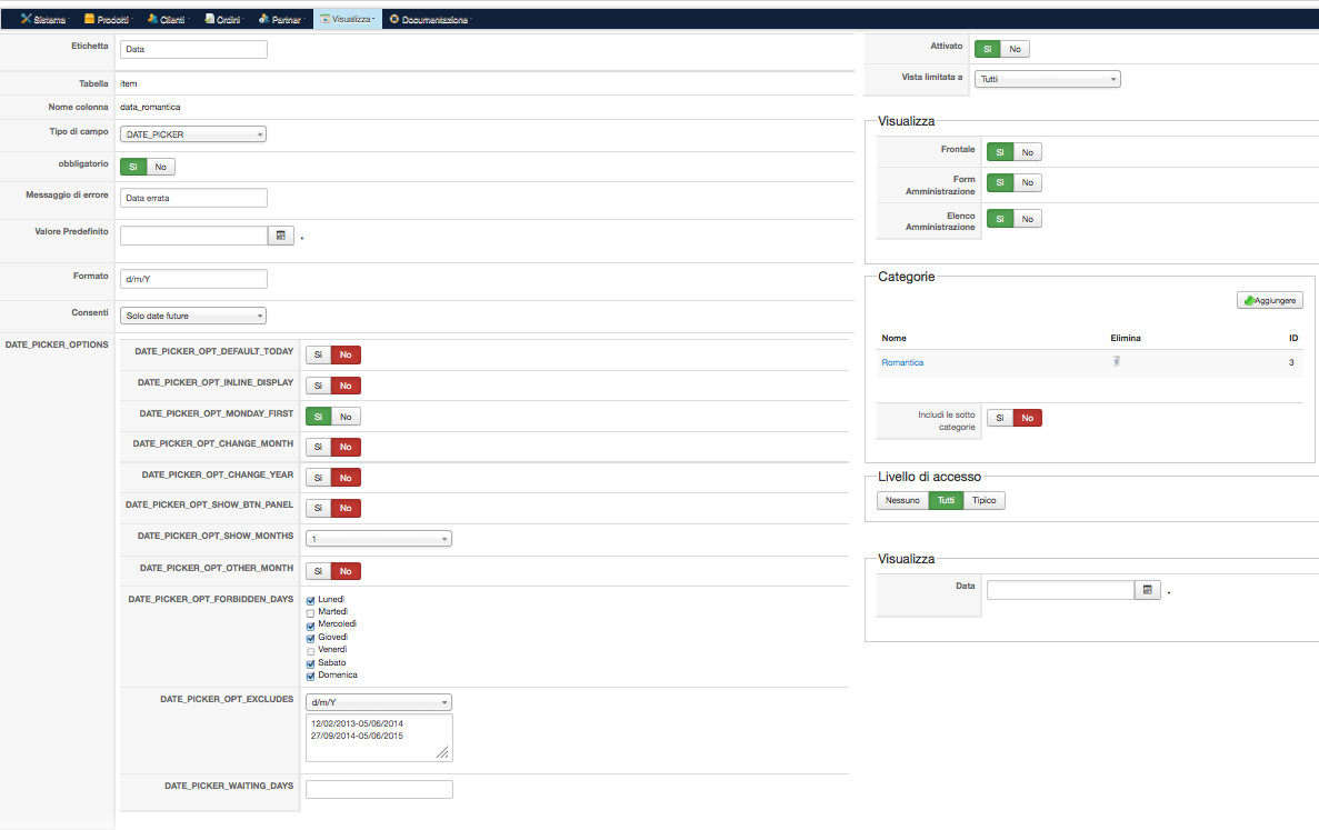

Ok, picture nr 1 is not working, there are the weekdays restriction
picture 2 the one that works ( but still doesn't work with compulsory range of dates)
Many thanks for your time!
Matteo
