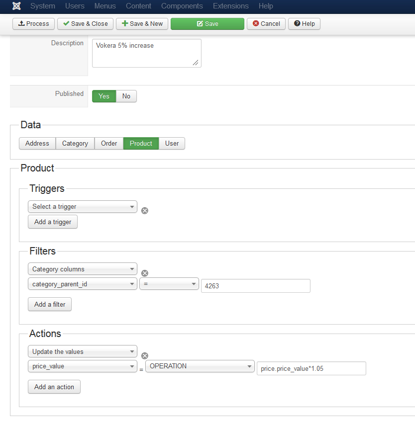

Can you give me a screenshot of the configuration of your mass action ?
I will try to reproduce the problem on my end.

Sure, please see attached.

11 years 11 months ago #133640
I tried the same mass action than you on my local site, and it seems to be working fine.
I had maybe changed something else, but actually I don't really remember what.
Thanks to wait for the next release of HikaShop.

Sorry for kicking this old topic up again, but I'm trying to lower all prices in my webshop with 3%, but it doesn't work with the method mentioned above. Should this work now?

This should definitely work. How did you configure your mass action ? Could you provide a screenshot ?
