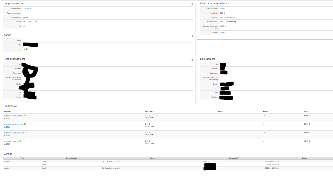

we took over the work from another agency for the client. So, we urgently need a bit of support on this, because the calculation in orders makes weird things:
Calculating an order which wasnt made in frontend on top of others and calculating wrong (see attached screener).

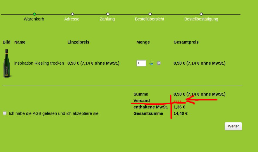

Also, the Shipping costs are not printed out on screen during the order process in frontend (while being calculated).

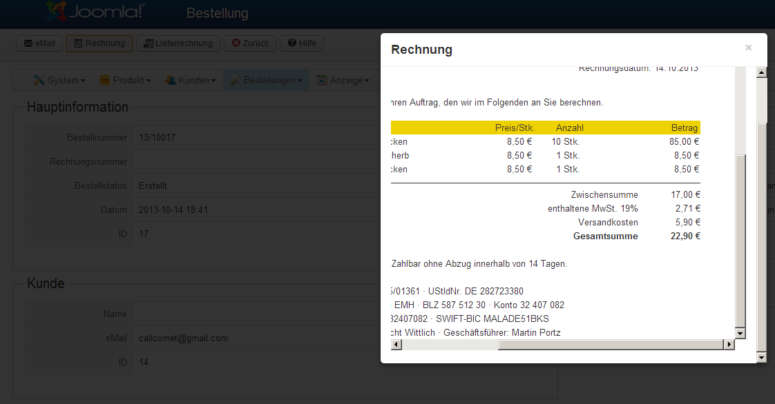

The problem in the screenshot is clear, when you calculate what s written in the "print invioce" popup.
The calculations are simply wrong, and the first line of ten items wasnt added to cart at all....
When You go to shop under the domain and just add an item, go throught the process, you will see that there is no Shipping costs (Versand in german) printed on screen.

Regarding your first screenshot, I can indeed see that the calculation is wrong. Did the update resolved the issue ? If not, can you check that the file "invoice" of the view "order" was not edited via the menu Display>Views. If it was, can you save the modifications locally and click on the "remove customization" icon of the file so that you use the default view file of the latest version ?
Also, if that doesn't work with an old order (as it might actually be a problem at the creation of the order in the backend and not at the display), can you try with a new order ? Does it help ?
Regarding your second screenshot, this usually happens because you had edited the "cart" file of the view "checkout" via the menu Display->Views. Remove the customization there and it will display the shipping fees fine there.

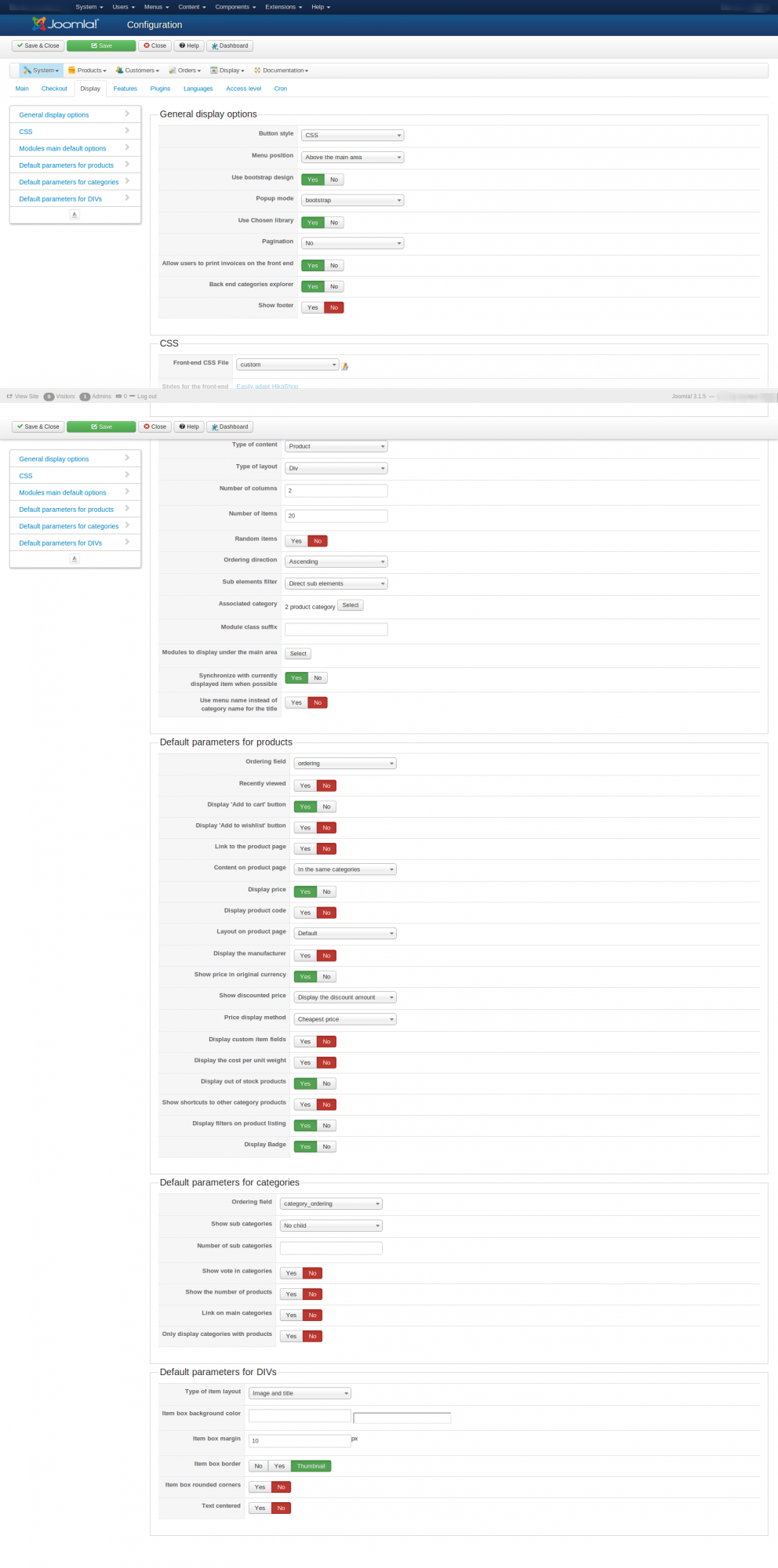

Sadly, I cannot find what you mean by....: "invoice" of the view "order" was not edited via the menu Display>Views.
When I go to Display-> Views I cannot find any setting related to "order".
only can find Custom frontend CSS and backend CSS while there is the backend css set to default.
To be sure, I am in System-> Configuration-> Display
there also is no "remove customization" icon...

Both... I went to front shop, did put products into cart (3 different ones, 2* Product A, 5 * Product B and 10 * Product C)
During process Versand (shipping) wasnt printed out on screen.
In backend then it adds an extra row on top of the product list, which is a copy of 10* Product C, but it also doesnt calculate this row.
So, see screener please...
Very weird at all, especially after I have run an update, additionally to the customization you recommended to remove which I cannot find.

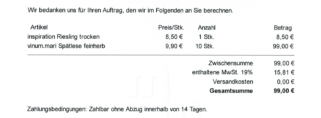

And a screener from an invoice, where only the first row is not calulated...
EDIT: And when I am in order details and I click on the edit button right column at additional infos and click SAVE on the save symbol, the calculation is correct again....

12 years 10 months ago #128614
For what I see in your screenshots, it looks like you already have some data in your table "order_product".
So when the order is displayed, it load his products but also some old data in the database, from a previous test install maybe ?
Because the total is right (if we exclude these products) and because the products are displayed at the top of the list, I think that the problem is in the data of the table "order_product".

Second thing, because the reset customizations, why dont I see in configuration what youre talking about?
See screener from updated to 2.2.2 version from local install.
Cheers.

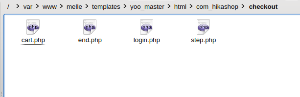

If you want to reset all customizations of views, the simplest is the rename the folder templates/YOUR_TEMPLATE/html/com_hikashop via FTP. That will remove all cusotmizations to all the views that were done via the Display->Views interface.
Then you can see if it helps.
What Jerome is saying is that the data of the products of the order doesn't seems to correspond to the order. And that could be explained because the order table was cleared but not the order_product table and thus, for new orders you can potentially get products from deleted orders displayed on the products listing even though it won't be counted in the total of the order. Do you have any knowledge of such thing happening on your website ?
A backend access won't help for that. That would require to clear the order and order_product and history tables via phpmyadmin so that the data of new orders is then clean when new orders are created in the database.

First: Okay, so first I can only see some smaller settings in Display -> Views, cause there is no thing like a individual invoice template html code or so and even no editor to add such code.
So, I also see no reset customizations BUTTON you are referring to, why?

Because first point, custumization, still some things you wrote are unclear (what you said about backend and setting it back to standard, etc)
So I opened the folder and there are no templates.
All I can see is in the screener and there is nothing that seems to be individualized.

1. Regarding the folder I already wrote in this post
And you can see attached what I see.
To explain the situation again. I didnt set the whole thing up at all, so I modified nothing, made no changes and have no clue at all, cause I have taken over the client, after another agency made all this. I also try to reach him, but because he is least available and never calls back, the client changed to us. :-)

3. Sure, I can tell what PDF invoice layout means. When I go to Orders and click on one of them I can go to the Button "Rechnung" (Invoice) and get a pop up. In this popup a layout exists (header, footer, etc.) When I click on print in this popup I can pdf it or print it with a device. I have no clue at all, where the other agency set this layout up. Do You have?
