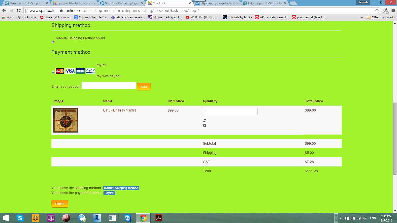

I can add the product, i can register, have shipping method, everything, and then i click " FINISH" it does not take me to paypal page for payment, instead it redirects me to the same page.
I do not get any error message, shipping is there, payment methods is there,
I do not see any proceed to paypal button but i have Finish button at the bottom when clicked it redirects me to the same page instead of taking me to paypal

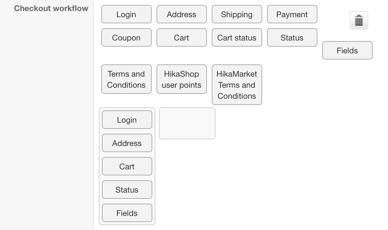

  • Posts: 147
  • Thank you received: 6
10 years 11 months ago #212342
I am sorry for the confusion. But actually I don't have payment in the checkout workflow. See attached image.
I am not quite sure what the problem is but when I hit the button to submit the order it redirect me to the top of the page and the /step-1
is added to the url.

10 years 11 months ago #212400
I am able to finish the checkout. The problem is that I need to click the button to submit the order twice, which is not right.
Once again, the first time I click the "finish" button it adds something like /step-1 to the url and only after that has being added to the url my second click will submit the order.

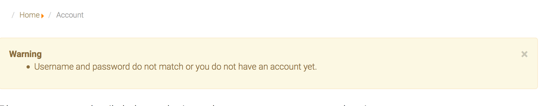

I test in 3 different computers and all have the same result.
Regarding the messaging and the template it seems to be working fine. If you try to login with a random login and pw it will display an error message. See attached.
