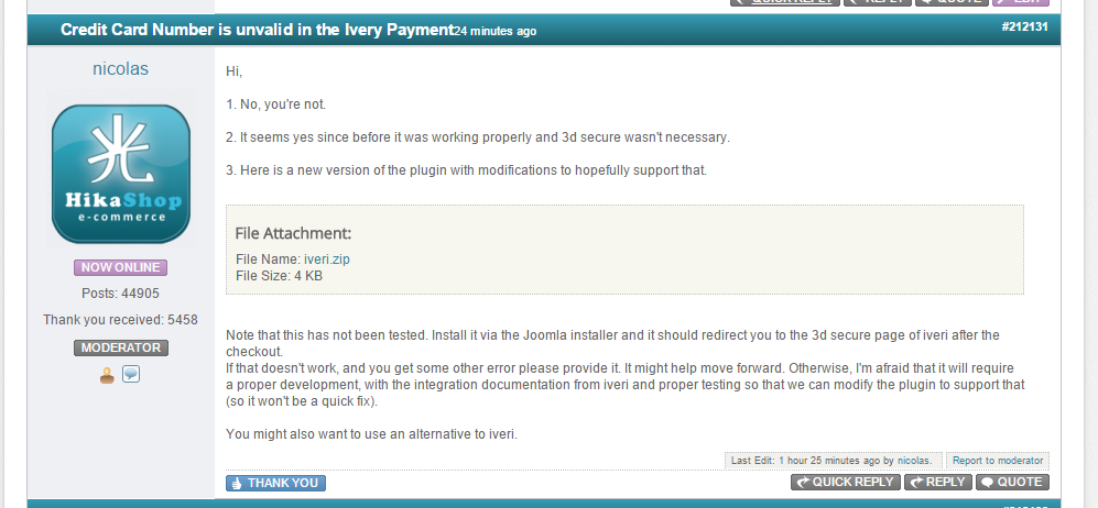

10 years 11 months ago #212131
1. No, you're not.
2. It seems yes since before it was working properly and 3d secure wasn't necessary.
3. Here is a new version of the plugin with modifications to hopefully support that.
Note that this has not been tested. Install it via the Joomla installer and it should redirect you to the 3d secure page of iveri after the checkout.
If that doesn't work, and you get some other error please provide it. It might help move forward. Otherwise, I'm afraid that it will require a proper development, with the integration documentation from iveri and proper testing so that we can modify the plugin to support that (so it won't be a quick fix).
You might also want to use an alternative to iveri.
Last edit: 10 years 11 months ago by nicolas.

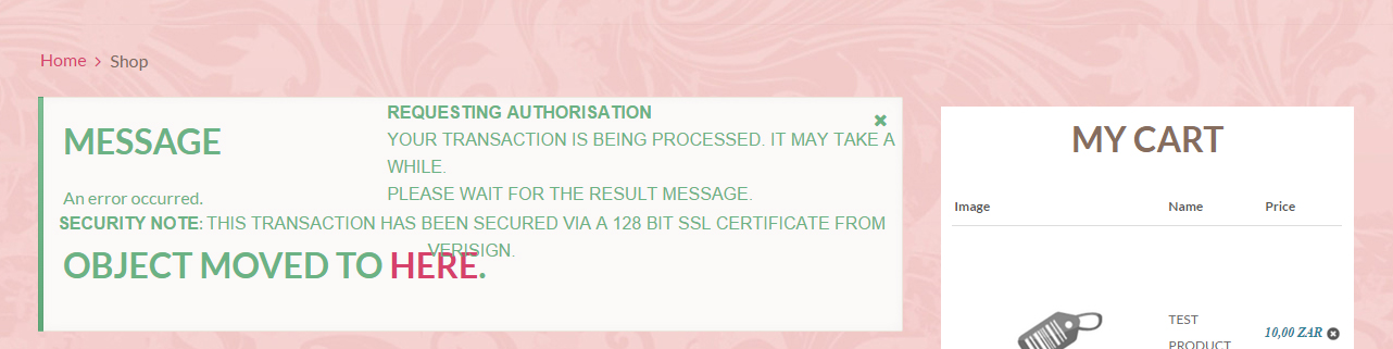

  • Posts: 27
10 years 11 months ago #212154
Hello Samora please to meet you.
Do I need to brief you on whats going on ?
Attached is the screenshot from, error i got after fixing the Jfatory to JFactory.
