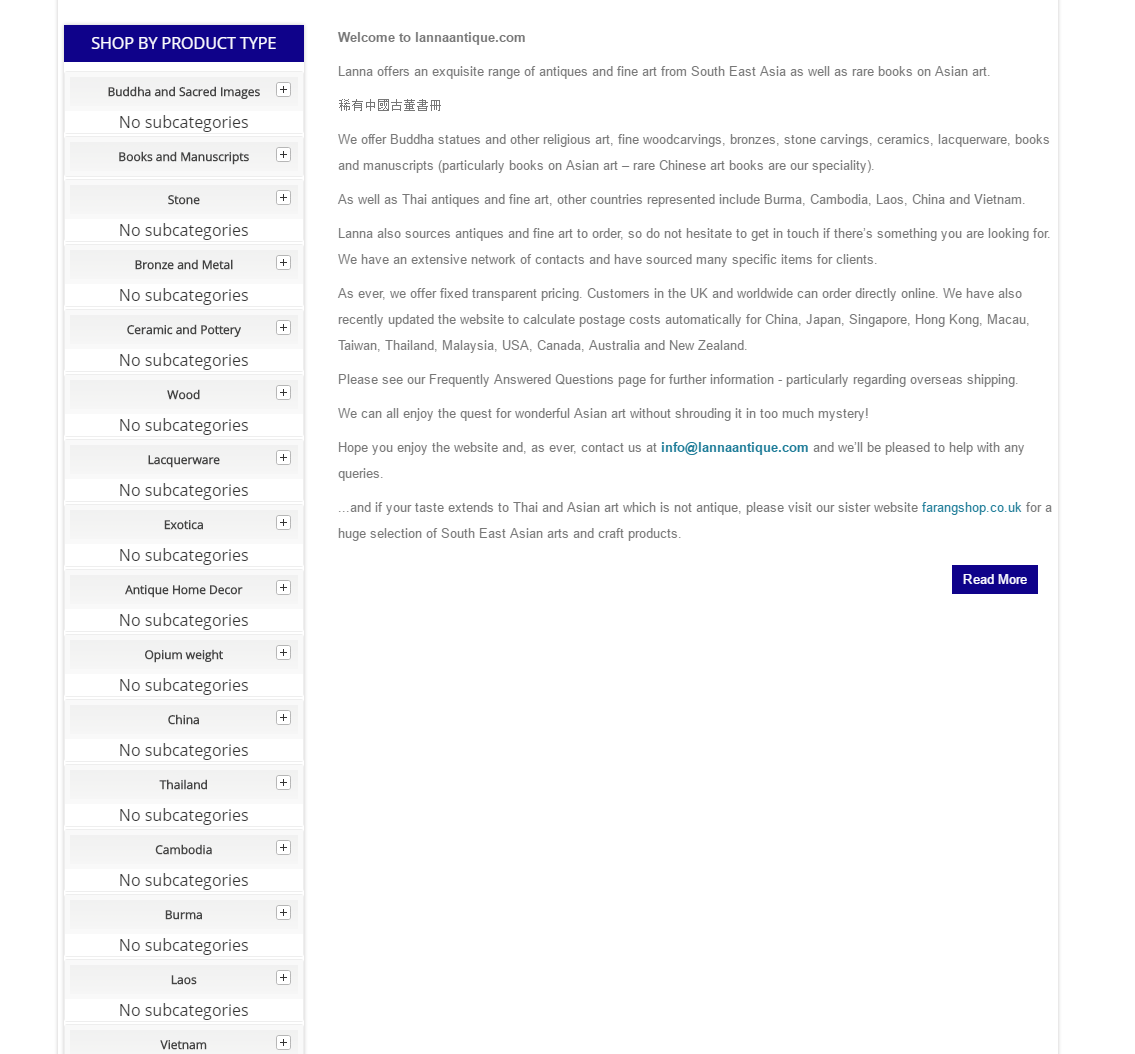

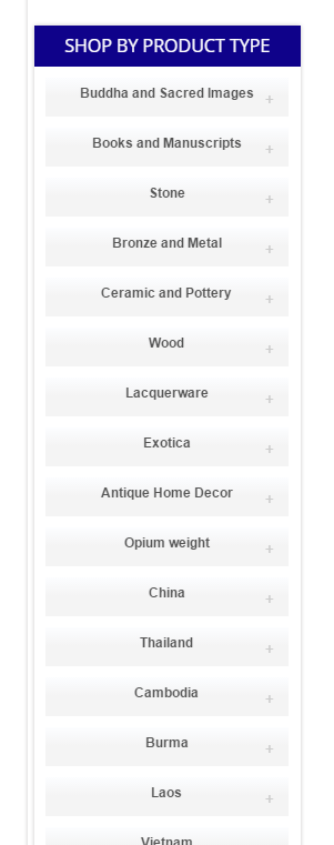

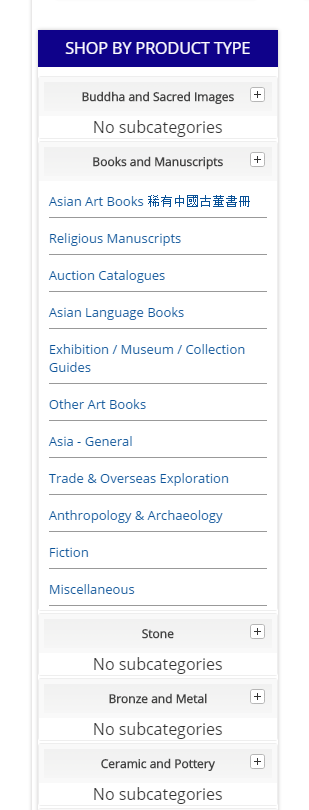

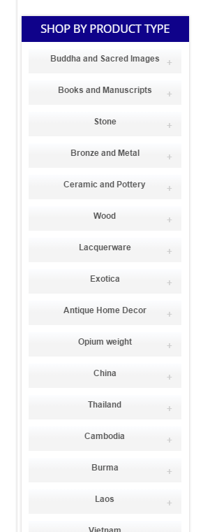

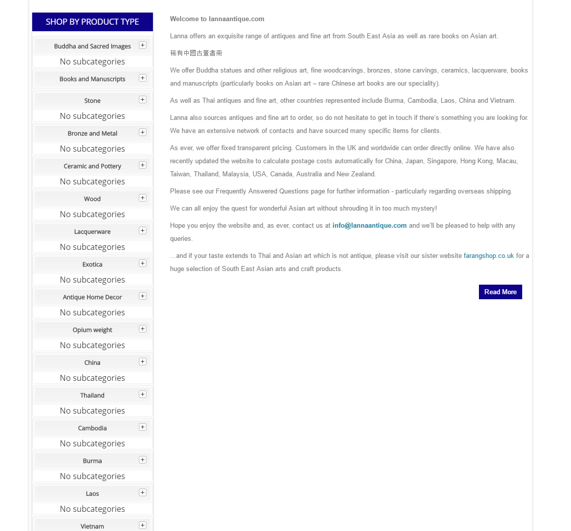

Hi Folks
I've upgraded the hikashop version and its broken the module on the left of site on the home page
I'm not sure what setting to look at or change
Link for site not working - openalldoors.co.uk/lanna/index.php/en/
Link for site old hika version installed but working - www.lannaantique.com/en/
Thanks very much for any advice or guidance you can provide
Cheers
Paul

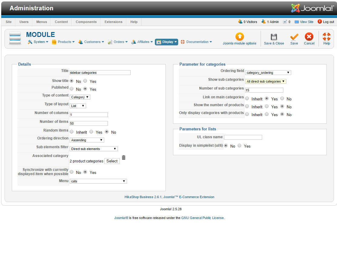

I see several things in play here:
- Edit the module via the Joomla modules manager, and try the different values of the setting "Show children"

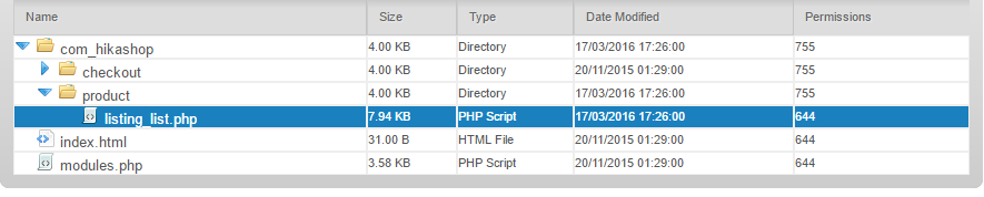

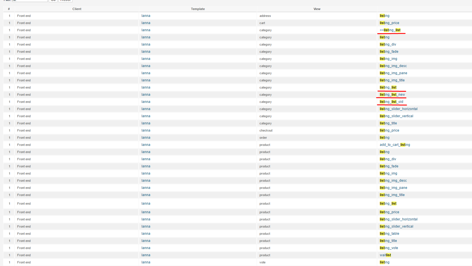

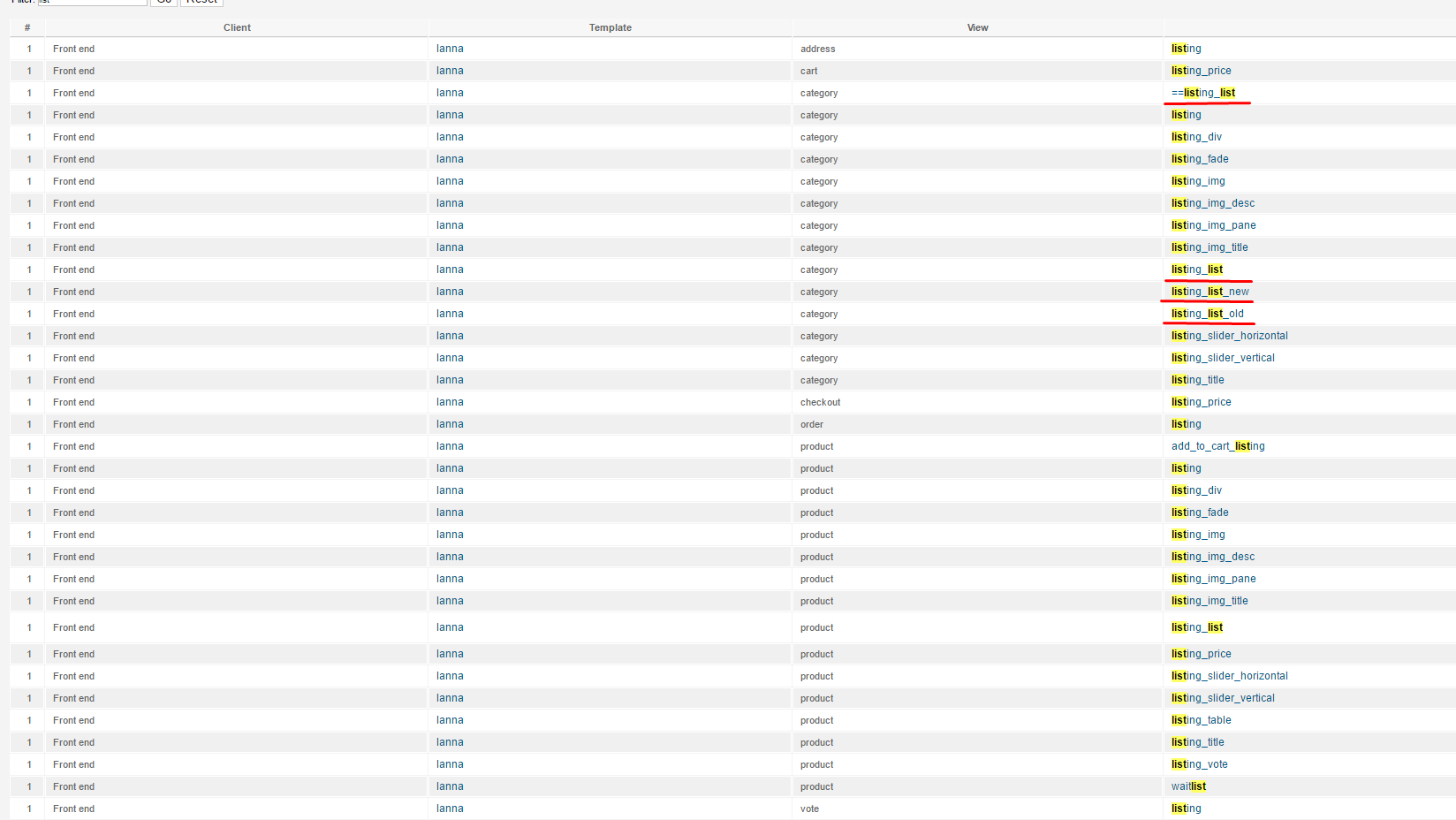

I'm not exactly sure what I'm looking for regarding the override - I can see listing_list in a product folder in the html but not category
However if I look at views I see many different versions of the file
and override wise
Paul

10 years 5 months ago #233574
So based on your screenshots, I don't see any override so it apparently doesn't come from that.

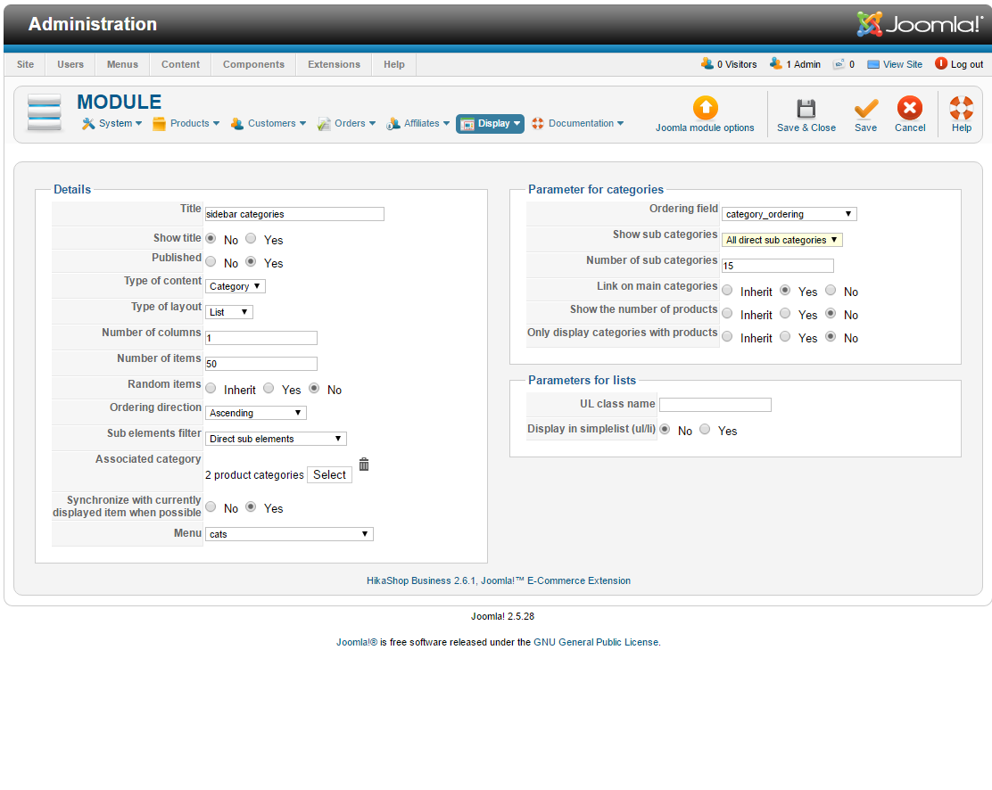

When you edit the module via the Joomla modules manager, you'll see the "show children" setting in the "HikaShop options" tab.
So please check that.

  • Posts: 86058
  • Thank you received: 14184
10 years 5 months ago #233598
Ah, I thought you were on Joomla 3. Sorry for that. On Joomla 2.5, the option is called "show sub categories"

No worries
I've tried changing these settings - with "no child" it removes all the sub categories, all sub categories displays the same as "all direct sub categories but loses the plus symbol
I was wondering if there was a class name I needed to add somewhere - I did check the demo but access for the Joomla module itself isn't allowed
Cheers
Paul
  • Posts: 86058

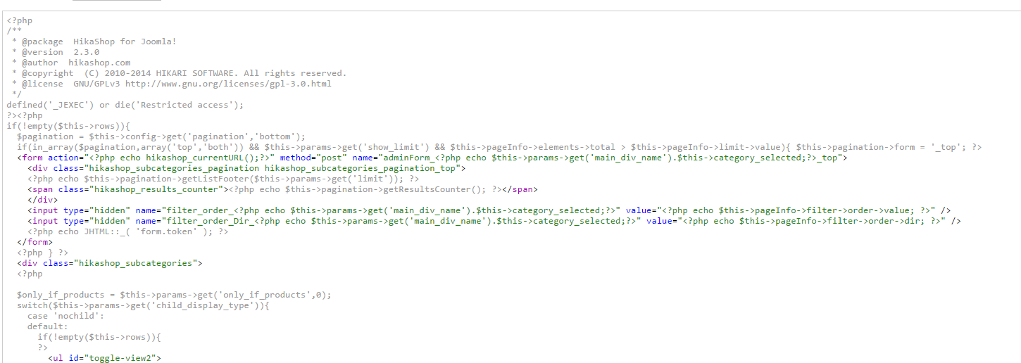

10 years 5 months ago #233716

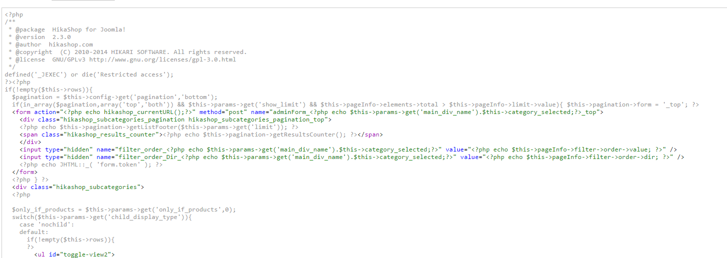

From what I can see, the problem is that the file components/com_hikashop/views/category/tmpl/listing_list.php had been directly modified to display custom HTML for that module, and that the template has custom CSS based on that HTML.
When you updated, these modifications have been lost and thus you're back with the default HTML of HikaShop and the CSS of your template isn't used anymore.
So you would have to get that file from before the update and copy it over the new version of the file after the installation and it should hopefully fix the problem.

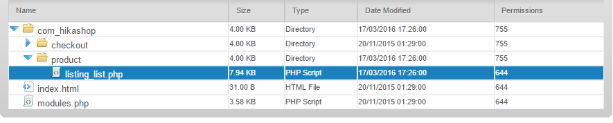

  • Posts: 44
10 years 5 months ago #233751
Thanks for continuing help with this
I've added the previous code to this file
So its 2.3.0
It's not fixed it unfortunately
The toggle that contained elements is now closed and unclickable
The others are still the same

10 years 5 months ago #233818
The HTML is still different between the two versions from what I can see. Maybe other files had been modified elsewhere.
Please understand that we can't help with this as we don't know what has been modified where.
This is custom development and on top of that it hasn't been done properly. Such customization should be done via view files overrides so that you don't loose the changes when you update HikaShop. Since the changes were done directly in the core files of HikaShop it's normal that you lost the changes when you updated HikaShop.
You should contact the developer that had made the changes so that he can port them to the new version.

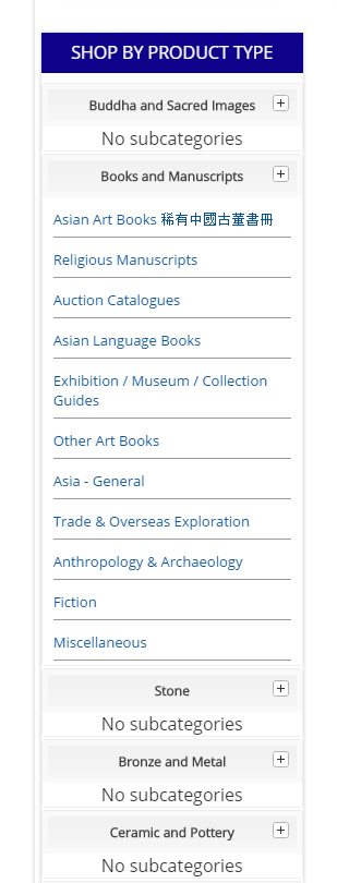

10 years 4 months ago #235580
Thanks I've managed to implement that accordion module overriding the existing styling and replacing it with new css - so much stupid stuff in there
The module didn't work at the start so have had to remove some of the php added by the previous developer and the hard coded jquery in the index.php file (which broke any module I tried)
I'm now stuck on the development site on a different issue :(
openalldoors.co.uk/lanna/index.php/en/sh.../2014-05-15-12-04-26
openalldoors.co.uk/lanna/index.php/en/sh.../2014-05-13-12-59-03
I can't work out how to remove the black and make it like the other page
or even where to find the file - /index.php/en/shop-by-product-type/2014-05-13-12-59-03
Thanks again for the help with the accordion
10 years 4 months ago #235623
You have to edit the module with the id "87" and change the value of the option "background color".
Else some css like that should do the job:
.hikashop_subcontainer{ background-color: #fff !important; }

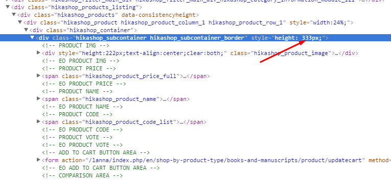

10 years 4 months ago #236013

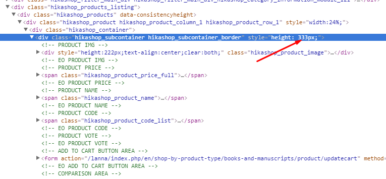

I was hoping to get a handle on where the background black colour was or where it was coming from - as its added inline to the particular problem pages rather than override with !important
I was hoping it would explain pages like this
openalldoors.co.uk/lanna/index.php/en/sh...ooks-and-manuscripts
e.g. how to deal with the inline height value { height: 333px;}
I could wrap it in a media query but it means two media queries for where it breaks to 100% and one to override the
element.style for every or most pages
On the real site with the older version of hikashop it doesn't have any inline heights that I can see
The inline height is generally a problem as some products with long titles see the cart button pushed down on the the next product when displaying on mobile like widths
Cheers
Paul
  • Posts: 86058
10 years 4 months ago #236057
There is no inline height. The height is added dynamically with javascript so that the height of the elements is equal on each line of products.
If you don't want that, you need to remove the line:
$attributes .= 'data-consistencyheight=".hikashop_subcontainer"';
in the file "listing_div" of the view "product" via the menu Display>Views.
The following user(s) said Thank You: Farang
