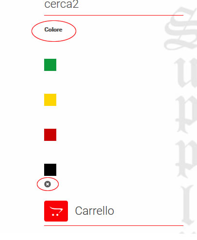

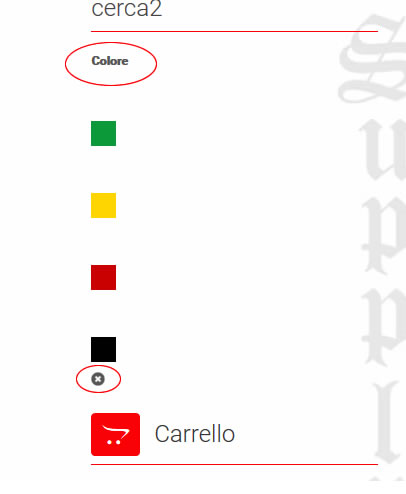

I wonder if it is possible take off the text "colore" on top and the "X" that is used to close the filter?

  • Posts: 281
9 years 9 months ago #255603
Well I think I reached a good solution.
2 other question, I hope the last two :oops:
There is a little X near the color when I apply the filter to close the filter, but it is not too intuitive, so there is the possibility to add a text , undert the line with color, to explain the X, example click on " X to close the filter"
Than when i click on that X it redirect on a page with a list of all products, can I set it to redirect to the page where I was when I applied the filter,or at least to the page with list of category of the ink ( redskull.it/test01/inchiostri-tattoo )
Thanks for your great help
Frank
  • Posts: 86058
  • Thank you received: 14184
9 years 9 months ago #255606
1. You can edit the file "filter" of the view "product" via the menu Display>Views and add your text at the bottom but it will add it all the time.
But then, you would loose it when updating. We'll add a tooltip on the delete icon for the next version of HikaShop as it's a good idea.
2. It's not possible to redirect back as the system doesn't have the information of where you were. Well, with some custom development, you could store that information and then use it, but it's more than two simple lines of code to add somewhere. I would recommend to have a developer help you with that.
