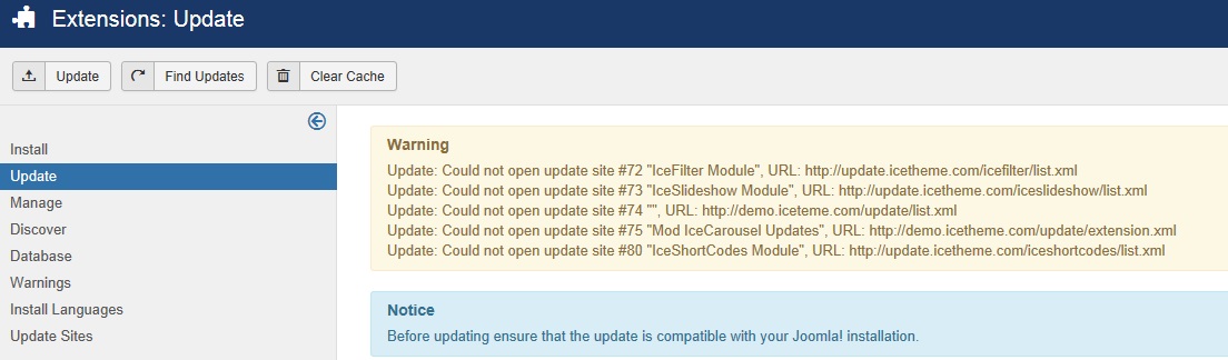

1. I'm not sure why you're talking about icecarousel module ? How is it linked to the HikaShop carousel not working ?
Also, I wanted to look at the display issue you have with the carousel without legacy mode activated, but I again don't see the carousel module on your website.

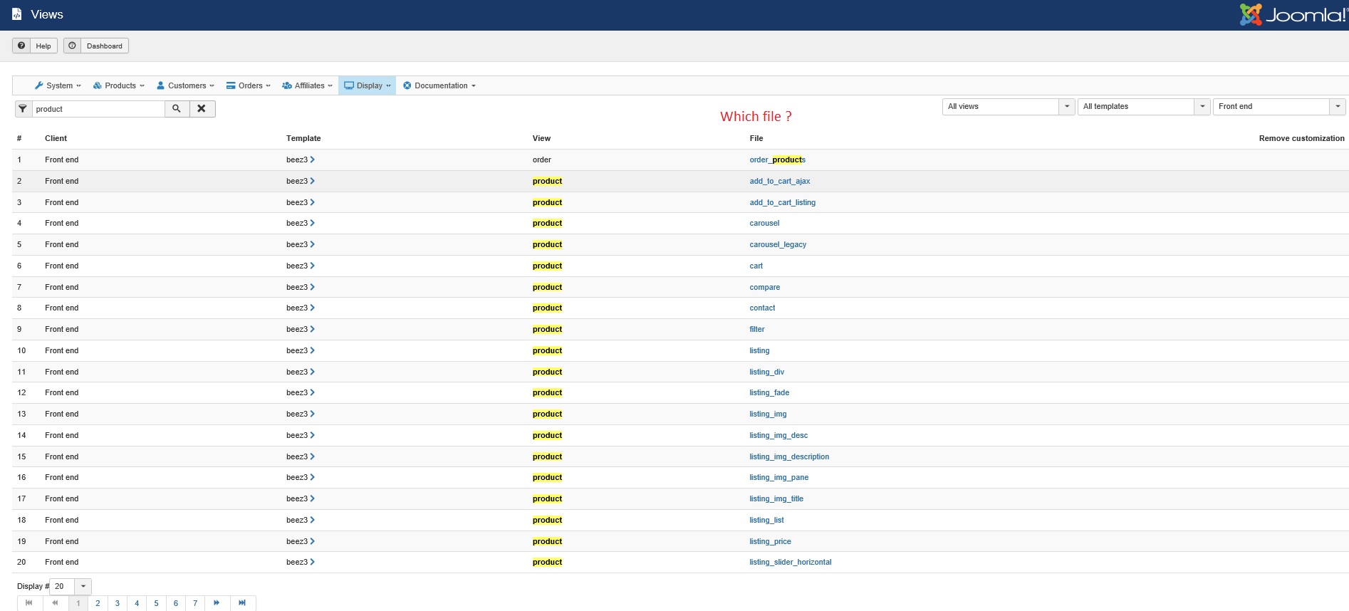

I try do business, web side is on and at the same time I try fix the bugs. I'm not a coder. Therefore, I can not easily find the code position ( file ). If you want to look at our backend then I can send you e-mail, that you can login, because it is difficult to explain all things.

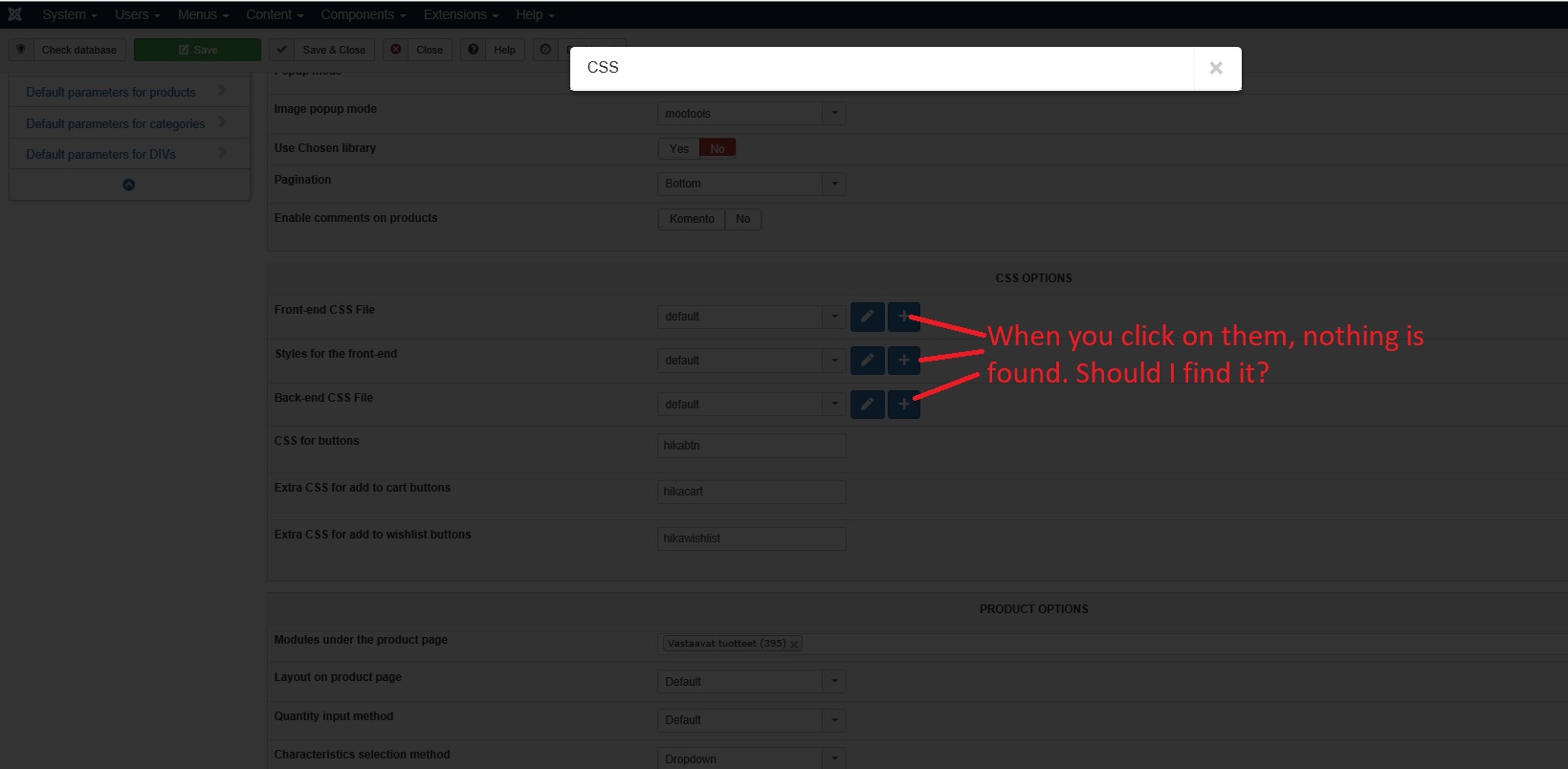

1. You don't see the carousel module on our website, because It's horrible and i try to do business. I can not keep carousel for a long time I hope you understand. That's why I suggested you watched our management pages.

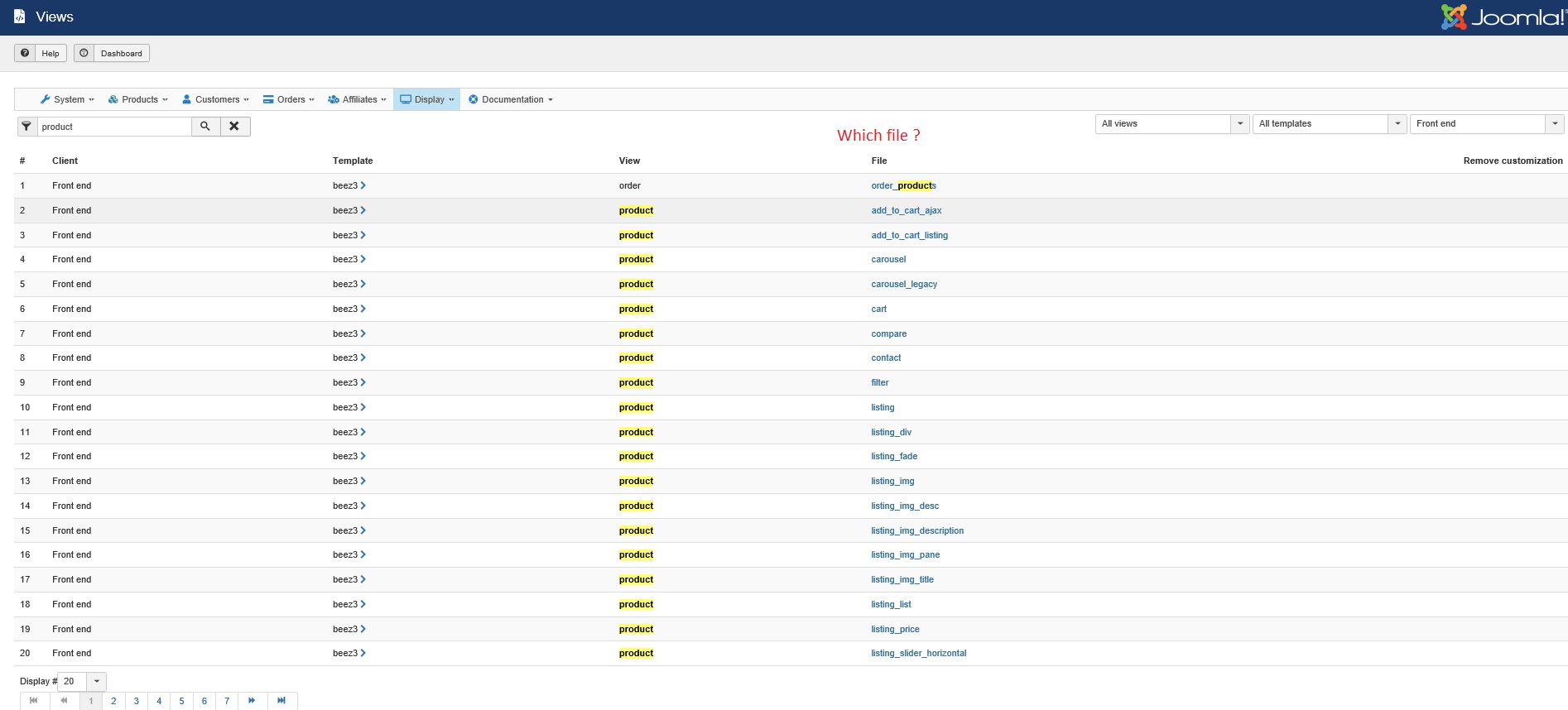

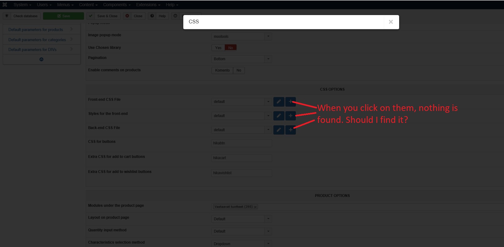

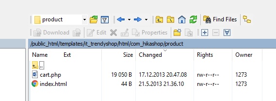

2. I can not find the files where the codes are. The path, tree.. Client, Template, View and File. What file ? See pictures.

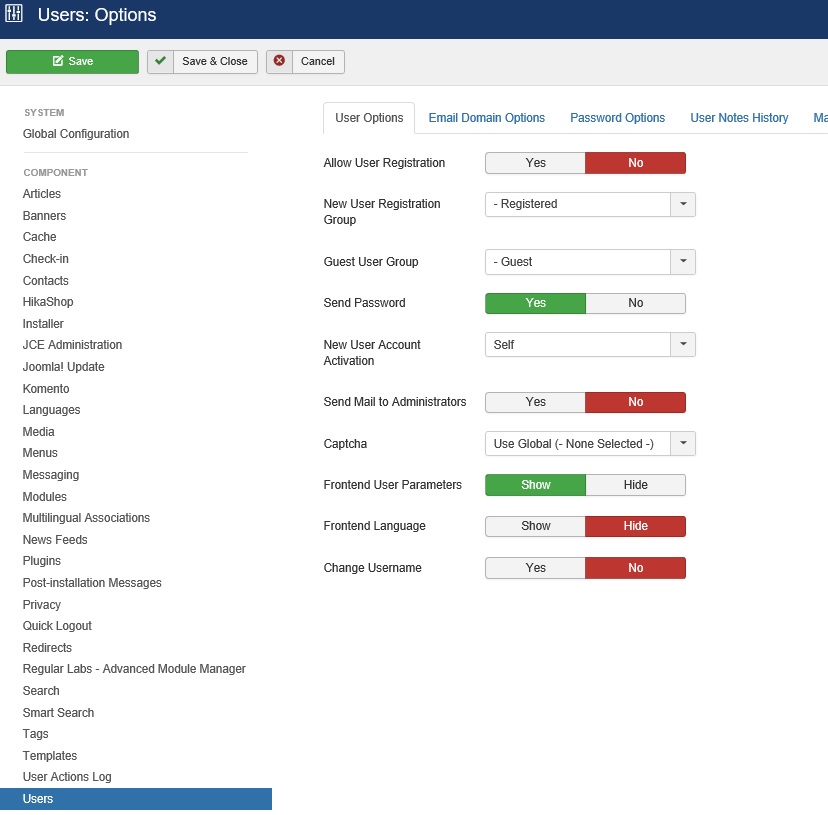

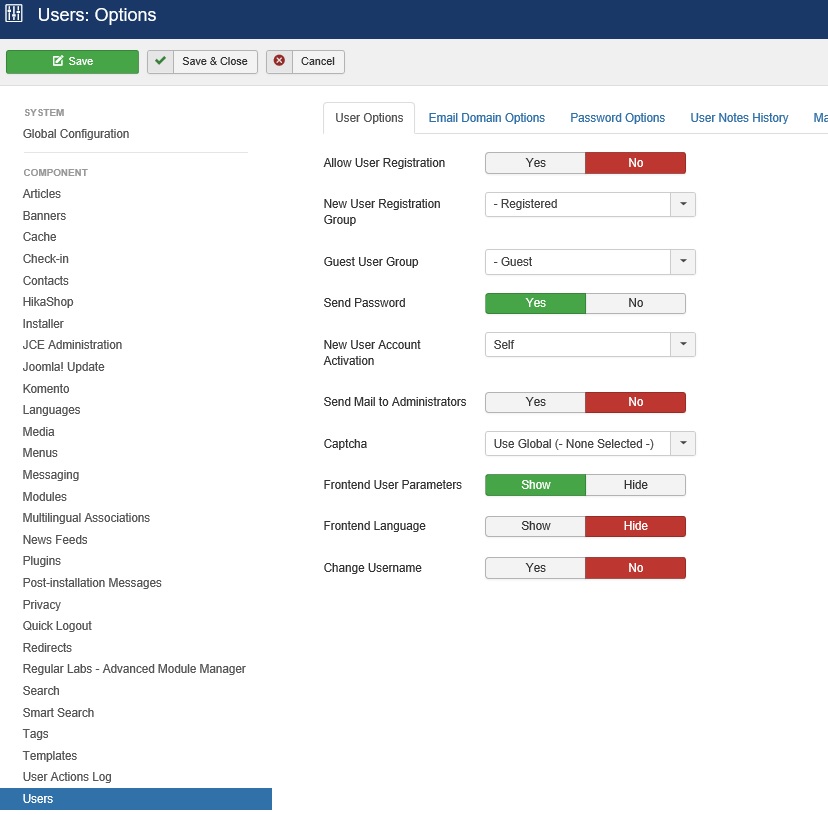

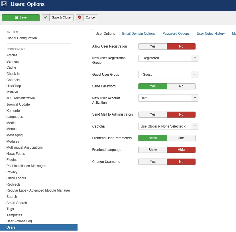

3. I send attachment to Joomla user option. Is this okay ? We did not use at all import of the products.

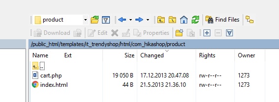

4. I test turn off the "add to cart legacy" setting in the HikaShop configuration. The shopping cart will not update after that. The whole page had to be updated and then the shopping cart will appear. See picture.
"templates/YOUR_TEMPLATE/html/com_hikashop/product/ and rename the files one by one to identify the one causing the problem and then keep the one creating the issue renamed". I do not understand ? See picture path/ file. What to do ? Rename cart.php ?

  • Posts: 86052
  • Thank you received: 14180
7 years 9 months ago #300264
1. Then configure a menu item that you set to a menu not displayed on your frontend, enable the carousel only for that menu item and provide the link to that menu item. That way, we'll be able to look at the carousel and no one else will see it on your website.

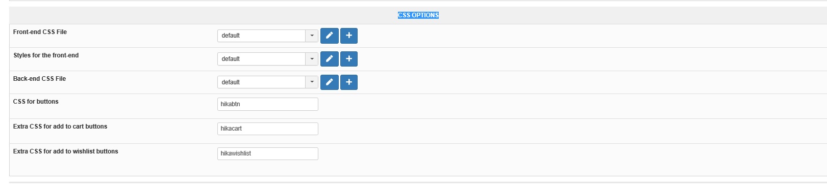

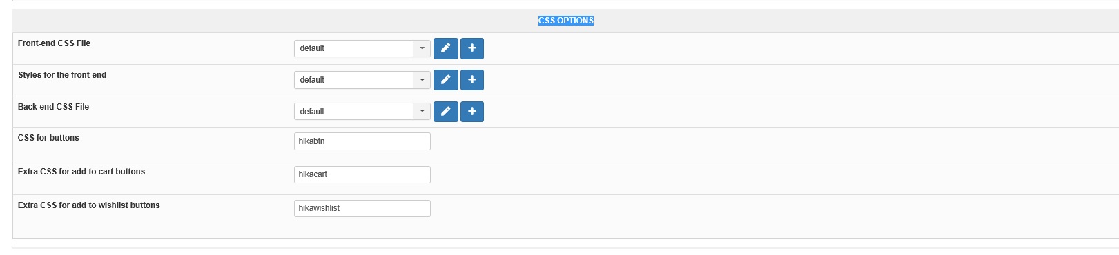

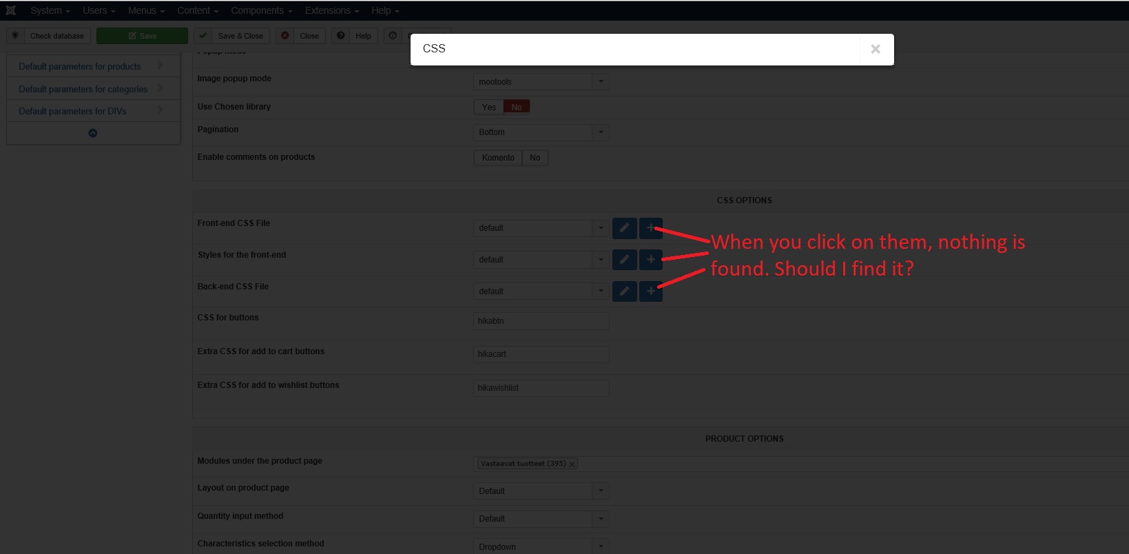

2. You're looking at the Display>Views menu of HikaShop.

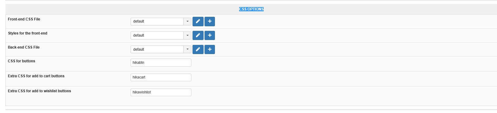

But you need to look at the System>Configuration menu of HikaShop. There, you have a Display tab with a CSS section where you'll find the frontend CSS option I was talking about.
3. Yes, this is ok. As I said, you just want to disable the HikaShop group plugin via the Joomla plugins manager.

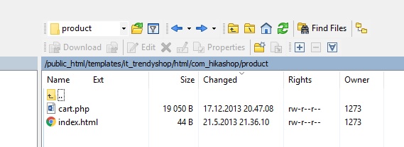

4. Yes, if you rename cart.php and with the "add to cart legacy" setting deactivated, that should work properly.
5. Just after you do point 2 and set the default CSS. You can edit it and add that CSS code at the bottom of the CSS file and save the edit popup and the whole configuration.php That will change the frontend CSS to "custom2" and that will it will use the latest CSS of HikaShop 4 plus that piece of CSS to fix the problem.

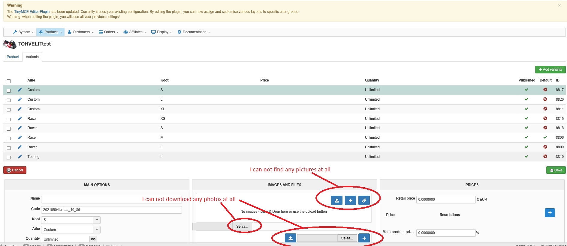

7 years 9 months ago #300273

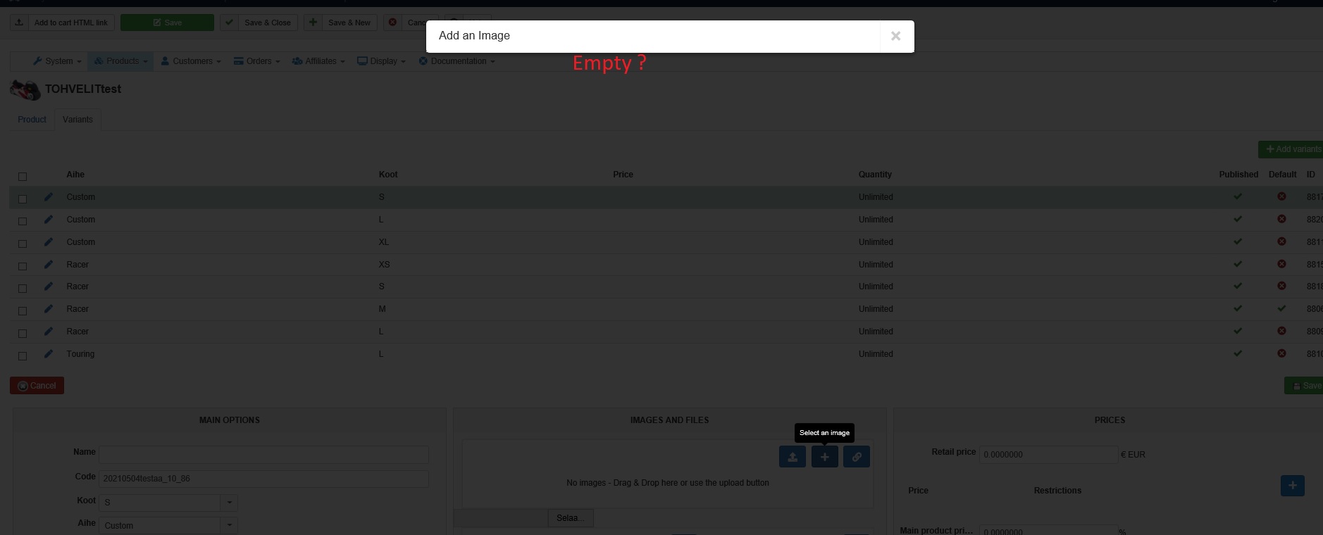

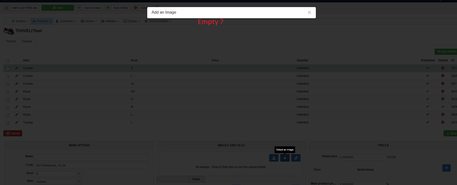

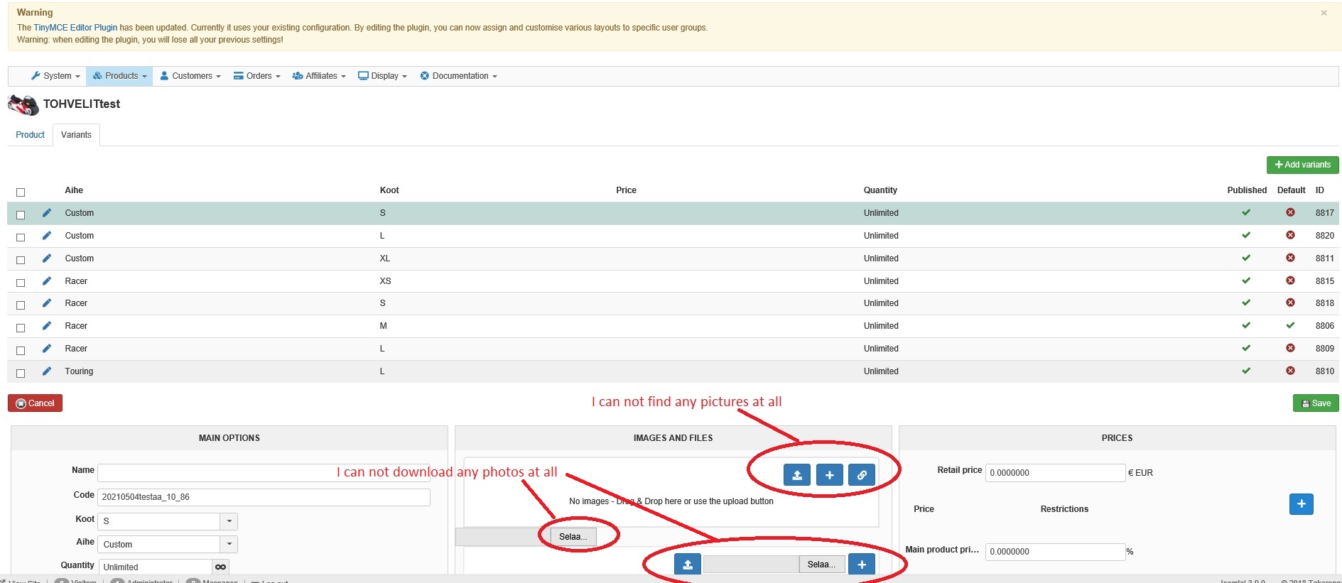

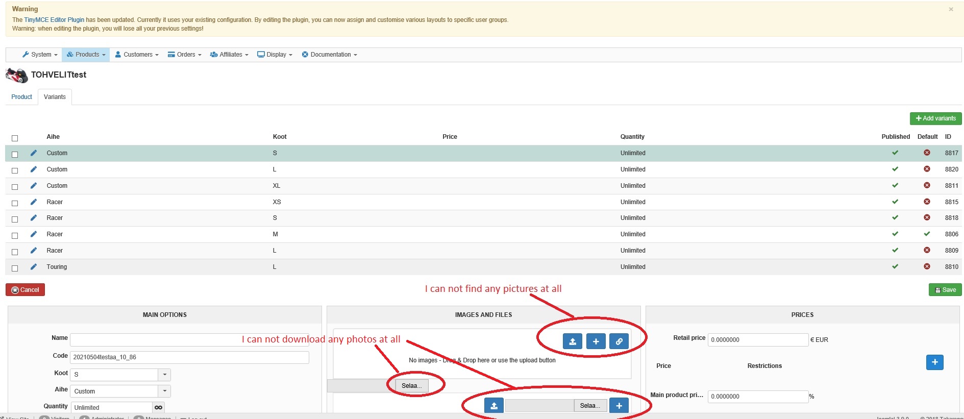

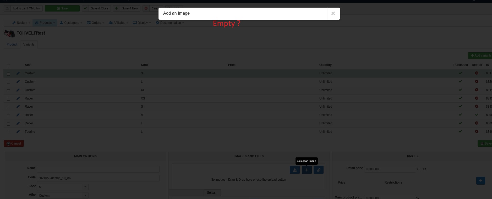

8. Add more problems and questions. No pictures can be found and no images can be downloaded. See pictures.

  • Posts: 68
7 years 9 months ago #300277
2. I've been looking for from there. See pictures.

3. I did not do anything, the settings were about.

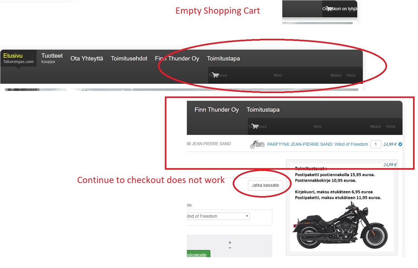

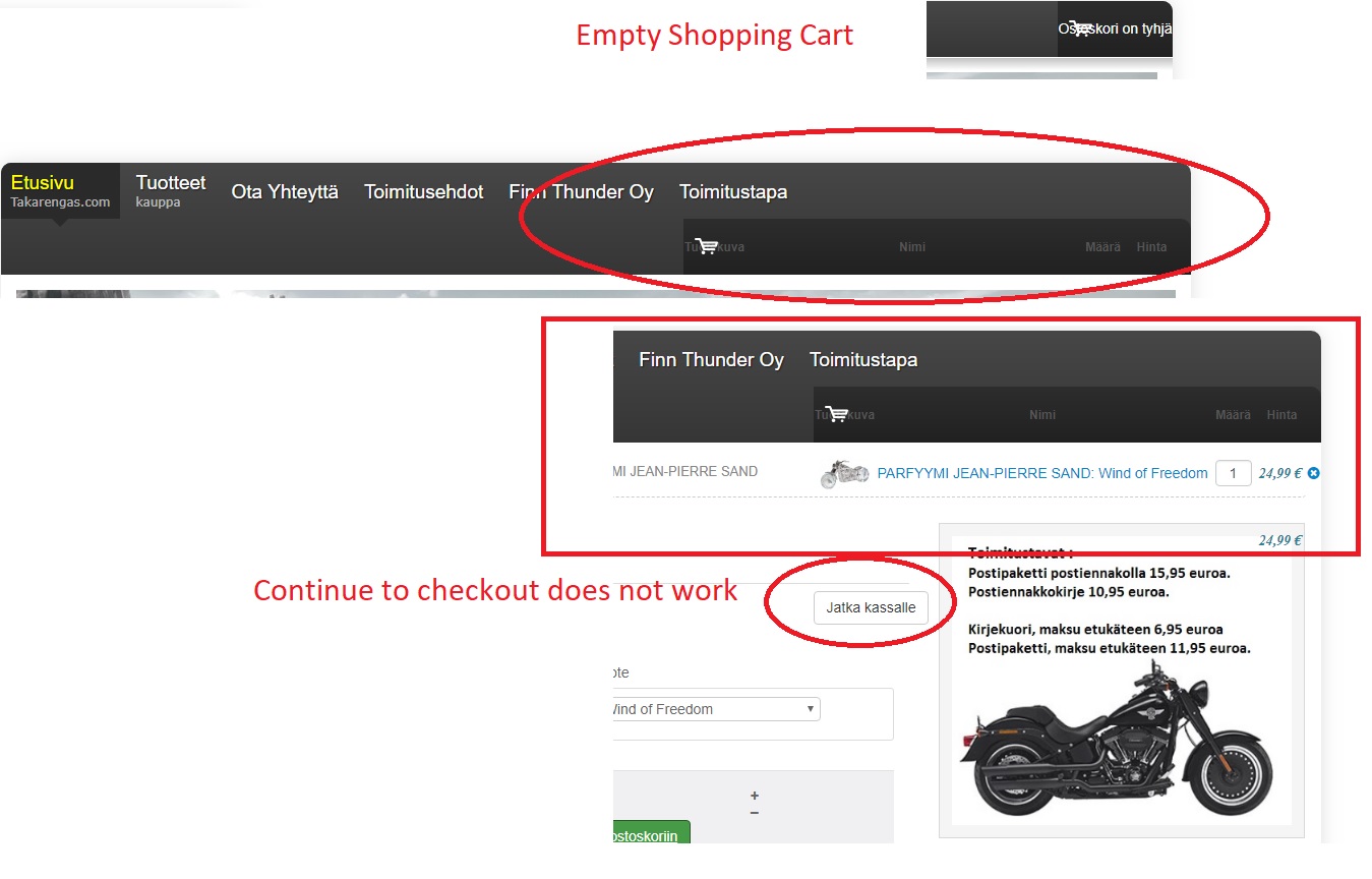

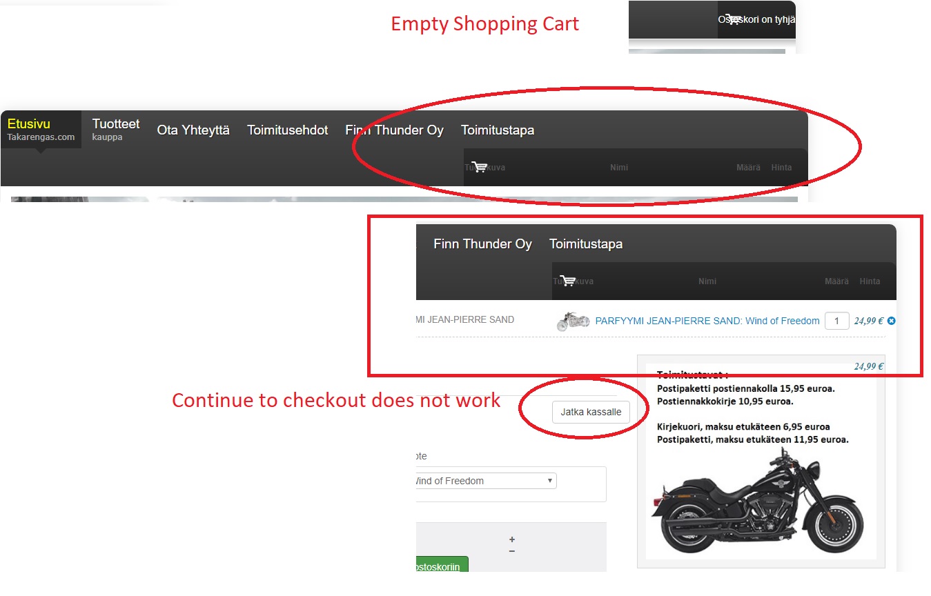

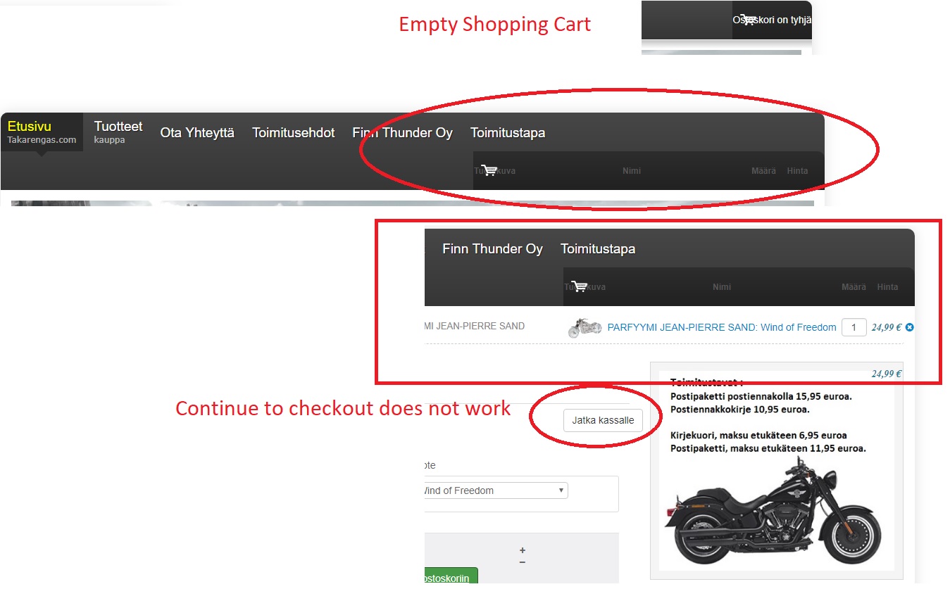

4. I tested quickly. Continue to checkout does not work and does not look good. Look at 4 attachments that are in one picture.

8. New problem. I sent you earlier.
  • Posts: 86052
7 years 9 months ago #300284
8. It seems that you have a javascript error on the page which prevents HikaShop from loading the javascript to handle the upload area properly. Please open the console of your browser while on that page and do a screenshot of the errors you see there so that we can understand what is going on.

2. Change the "popup mode" setting of the HikaShop configuration to "vex". That way, that should make the popups work properly. You must be using an old popup mode which doesn't work anymore with recent versions of Joomla.
  • Posts: 68
7 years 9 months ago #300308
HikaShop configuration to "vex". helped ! Thank you. Now I found CSS options code. That's why I asked the file where is code. And 8. New problem go away. Now with the pages I can work, at least I hope so.

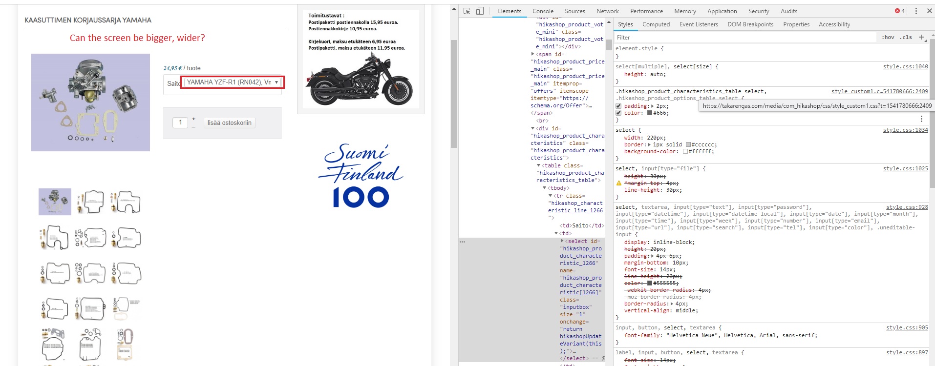

  • Posts: 68
7 years 9 months ago #300344
Easy to change code when code is displayed ! It was a good feeling. Thank you.

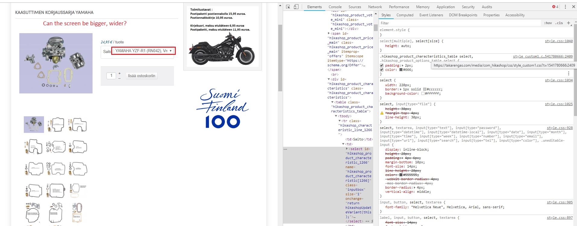

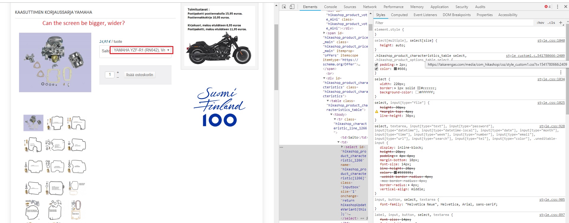

Can the box be bigger, wider ? See link and picture.
takarengas.com/index.php/hikashop/produc.../category_pathway-83
Best regards,
Thunder

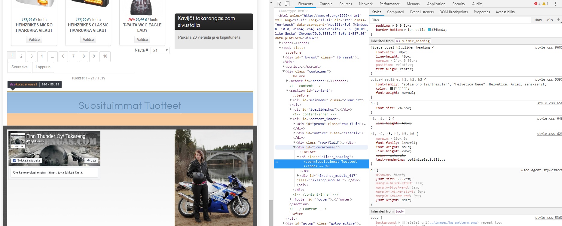

7 years 9 months ago #300365

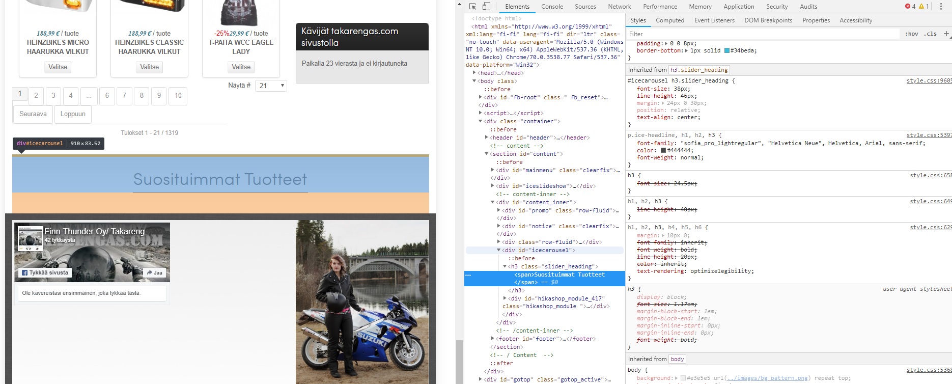

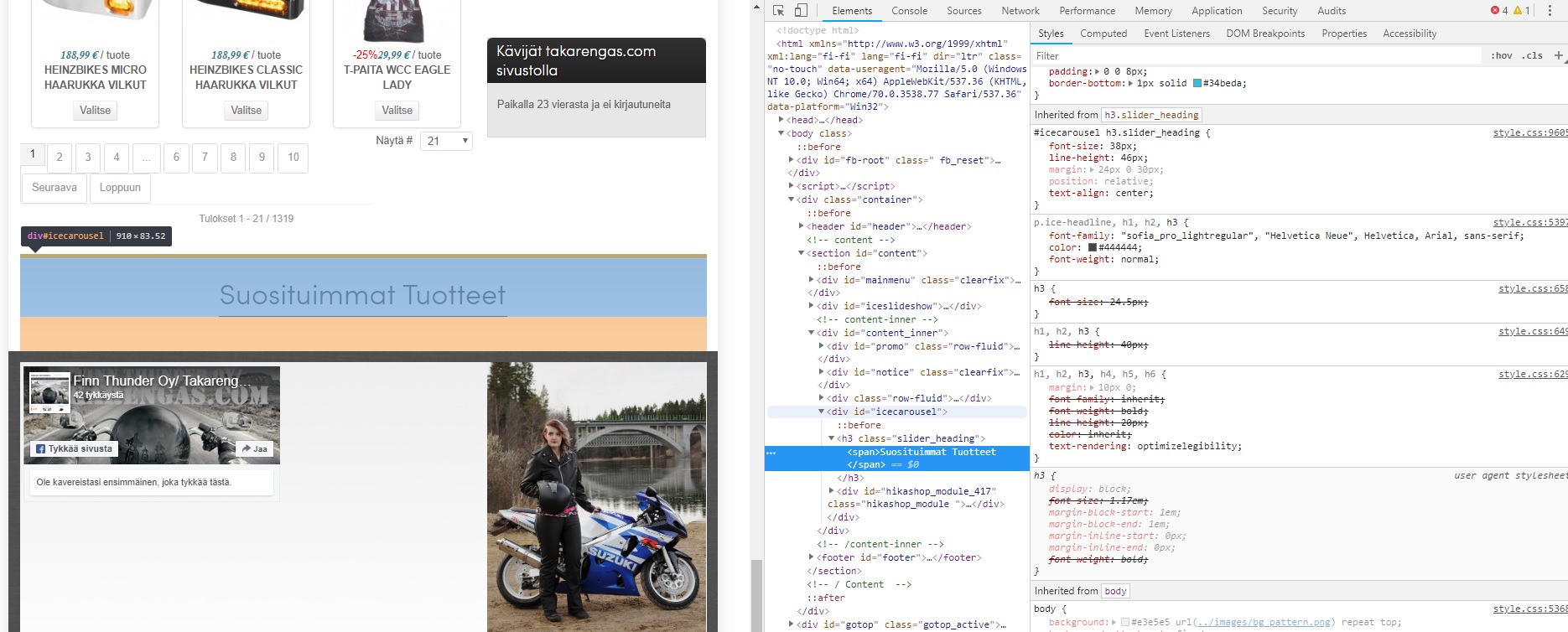

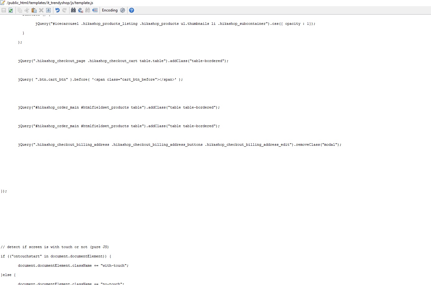

1. Is the source code useful when the carousel is on. Look attachments.
4. New shopping cart. How to get it right. See picture.

1. Well, thanks to that, I can now confirm that you're using the new carousel system we have in HikaShop for that module.
Besides that, I can't provide a solution to the issue you have with it. We would need to directly look at it on your website to be able to say anything.
You apparently don't want to create a hidden menu item so that we can access it. I'm not sure why since it would allow us and you to move forward without disturbing your customers, but anyways, since you proposed a backend access to be able to look at the issue, we'll go with that. Please provide that access via our contact form along with a link to this thread an instructions to display the module: www.hikashop.com/support/contact-us.html
2. I am not able to reproduce the problem on your website. On my end, the cart module always displays fine:
monosnap.com/file/dG0EdTcbUGKSQlrv55T5xnyjUTQapo
Please provide precise instructions to reproduce the problem.

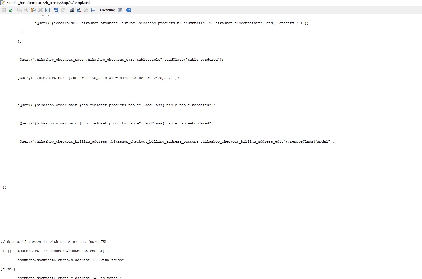

  • Posts: 86052
7 years 9 months ago #300419

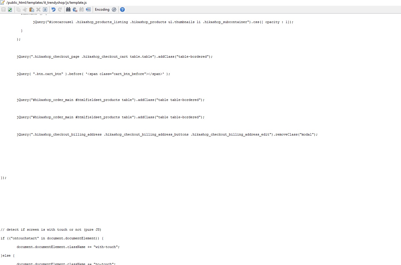

1. As expected, the issue is with the javascript error you have:
monosnap.com/file/m5m6OxZHWOwZNHQ6aawdrB7YNQZEtE
This comes from your template javascript.
Apparently, it comes from this javascript:
monosnap.com/file/kNKQiRu0dj79afMompsupYOeqbjzLr
However, HikaShop has its own carousel system so the template doesn't have to add it.
I would recommend removing that code from the template.js of your template.
That will remove the javascript error.
Thanks to that, the javascript of the carousel will be initialized and it will work.

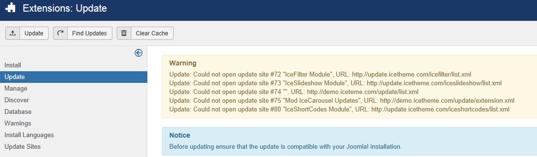

  • Posts: 68
7 years 9 months ago #300502

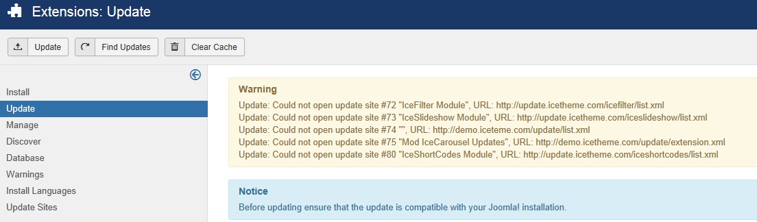

I tryed to asking about the warnings Icetheme suport. Many times during the year. Then all worked, so I was not worried. These were before the update, but I did not remember was it all. I do not remember when the warnings came.
