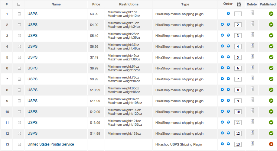

  • Posts: 16
12 years 4 months ago #131889

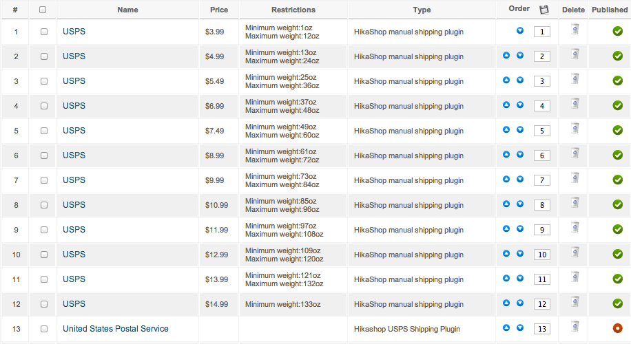

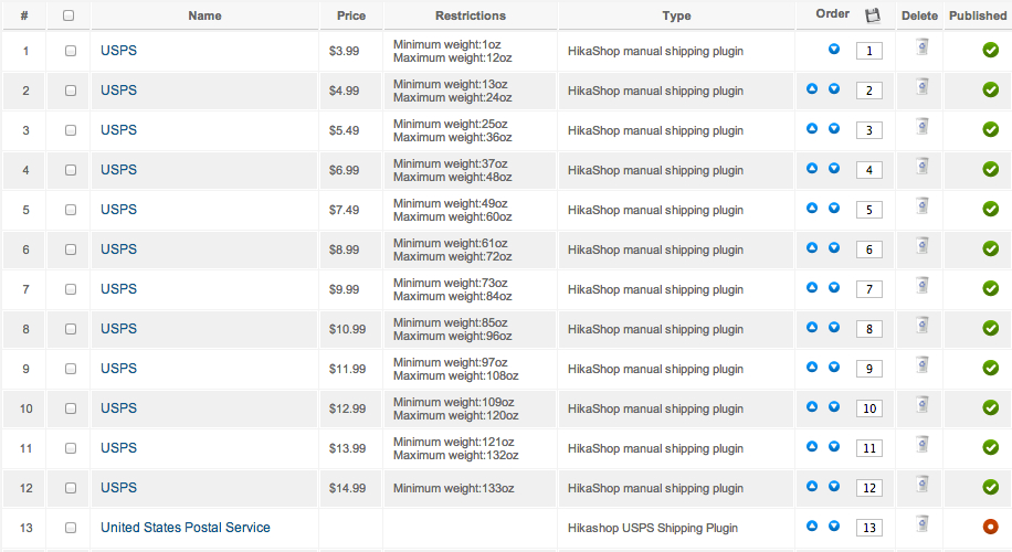

I had setup several manual shipping options increasing in price with increases in weight. This was pure guess and not very accurate. You really need to do your own calculations - mine are not correct. But at least I get something for shipping while the plugin in not working. I attached a screenshot, only good for example, you must do your own calculations.

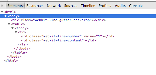

  • Posts: 16
12 years 4 months ago #131948

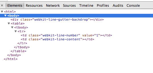

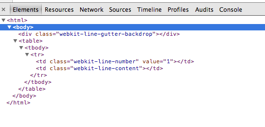

You would think. But I still get an absolutely blank page. Using Chrome, if inspect elements, all I see is an empty table. I attached a screenshot.

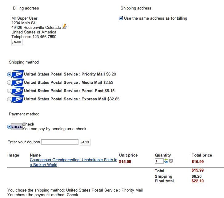

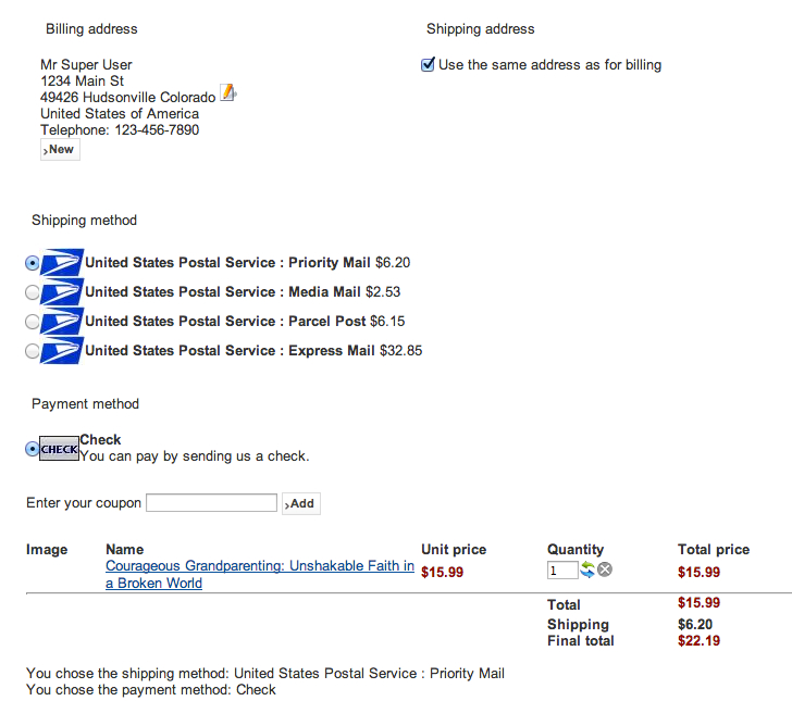

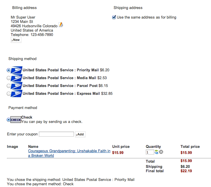

  • Posts: 16
12 years 4 months ago #132084
Jerome, that did the trick. I've shown results attached. I see "Media Mail" now as an option which did not exist before so I think you are getting better results from the API call.
