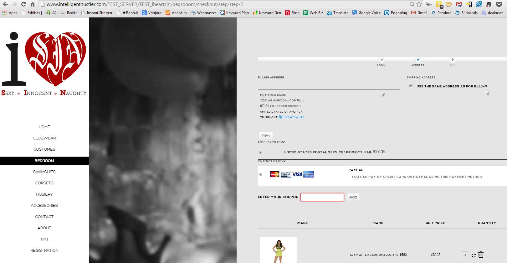

11 years 9 months ago #181501

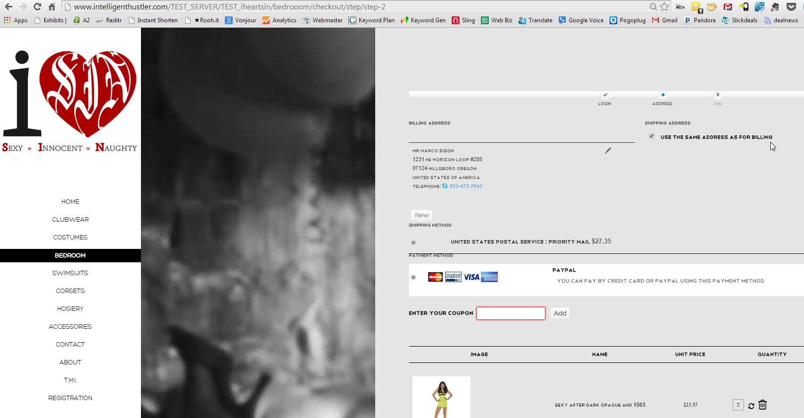

I think that took care of the error, but still only getting Priority as option for shipping
  • Posts: 146

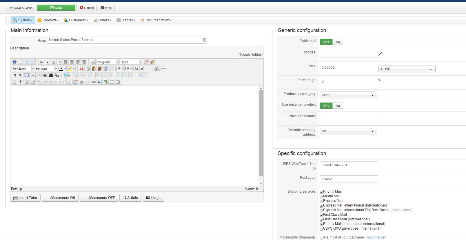

11 years 9 months ago #181620

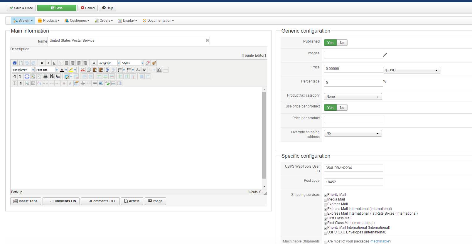

If I click off Priorty and leave no other shipping methods, then NO shipping options show up. It is as if all other USPS shipping options are available. Could a USPS WebTools User ID only have 1 shipping method allowed?
I don't think that is the reason, since I was able to choose options before, but this is driving me crazy.

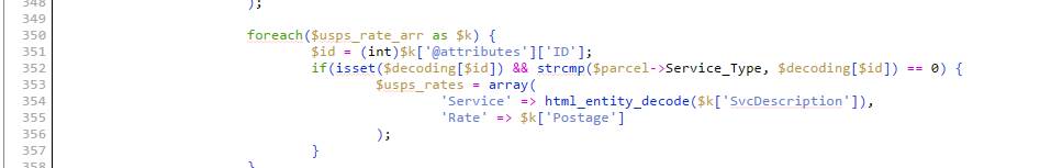

11 years 9 months ago #181840

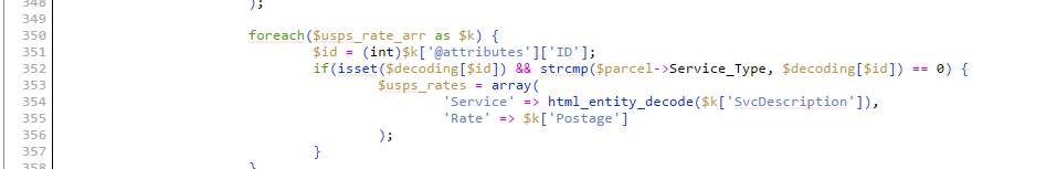

Can you :
- Edit the "plugins\hikashopshipping\usps\usps.php" file
- Change this line :
if(isset($decoding[$id]) && strcmp($parcel->Service_type, $decoding[$id]) == 0) {
By :
if(isset($decoding[$id]) && strcmp($parcel->Service_Type, $decoding[$id]) == 0) {
Last edit: 11 years 9 months ago by Mohamed Thelji.

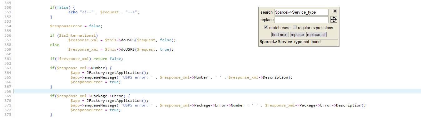

1) I cannot find this line. The closest I can find if I search for "if(isset" is
line 294: if (isset($rate->shipping_params->MACHINABLE)) {
and
line 500: if(isset($element->shipping_params->services)){
2) the line you ask me to change, looks just like the line you want me to change it to. Am I missing something?
11 years 9 months ago #182243
1. You'll find it line 352
2. My bad I just wanted you to replace "$parcel->Service_type" By "$parcel->Service_Type"

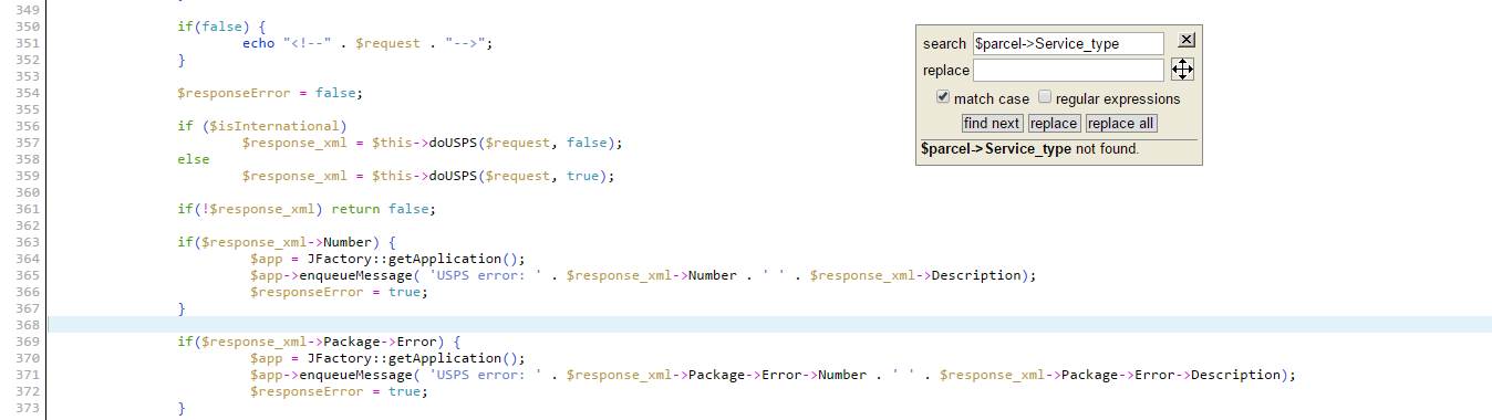

  • Posts: 146
11 years 9 months ago #182295
I still cannot find it.
public_html/TEST_SERVER/TEST_iheartsin/plugins/hikashopshipping/usps/usps.php

  • Posts: 146
11 years 9 months ago #182413
Sorry, I was in my test no production environment.
I made the changes as requested, but still nothing.

11 years 9 months ago #182715
Sorry, perhaps I was unclear. My issue is that I only get 1 choice for shipping. Only Priority, not first class.
